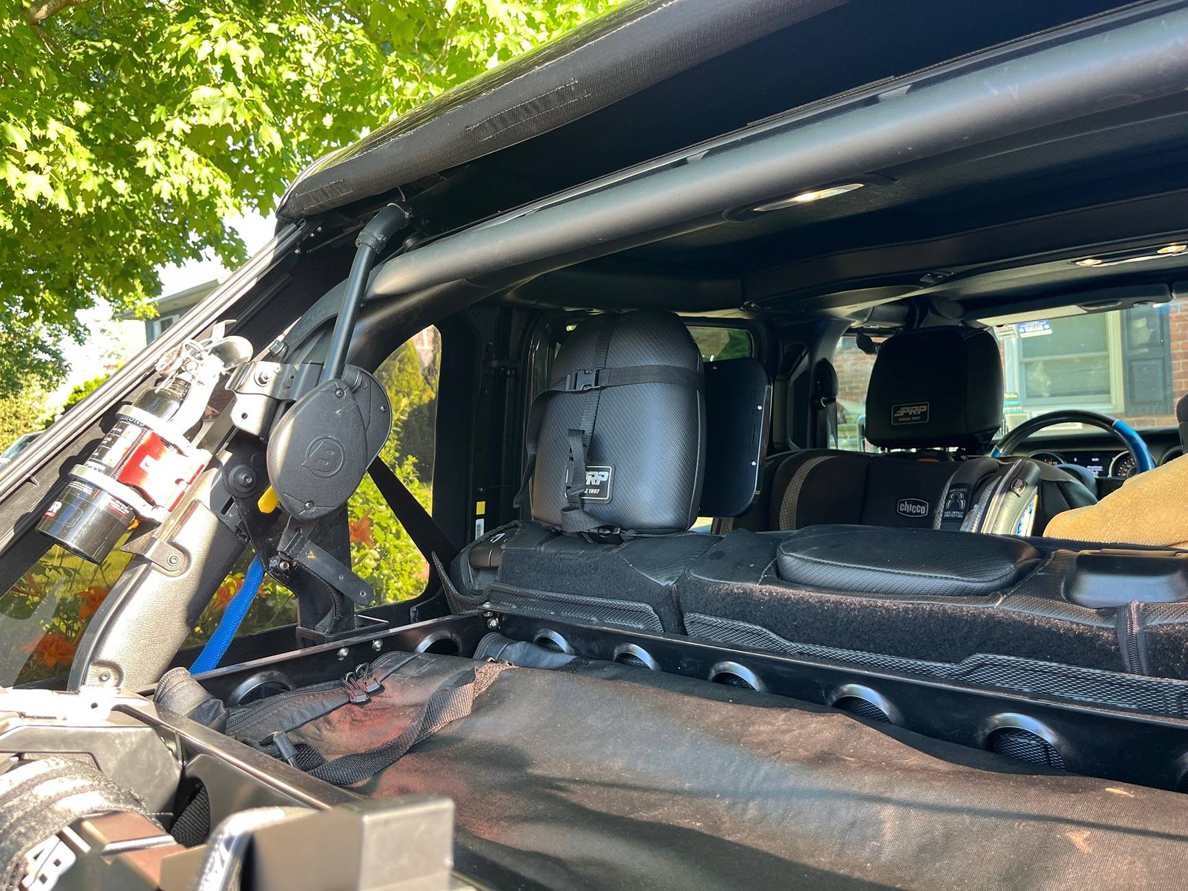

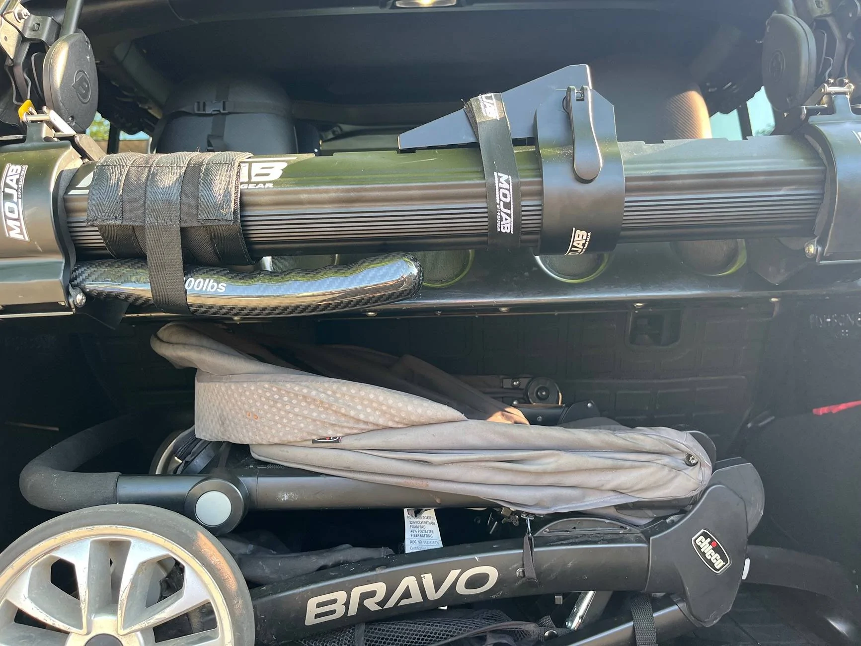

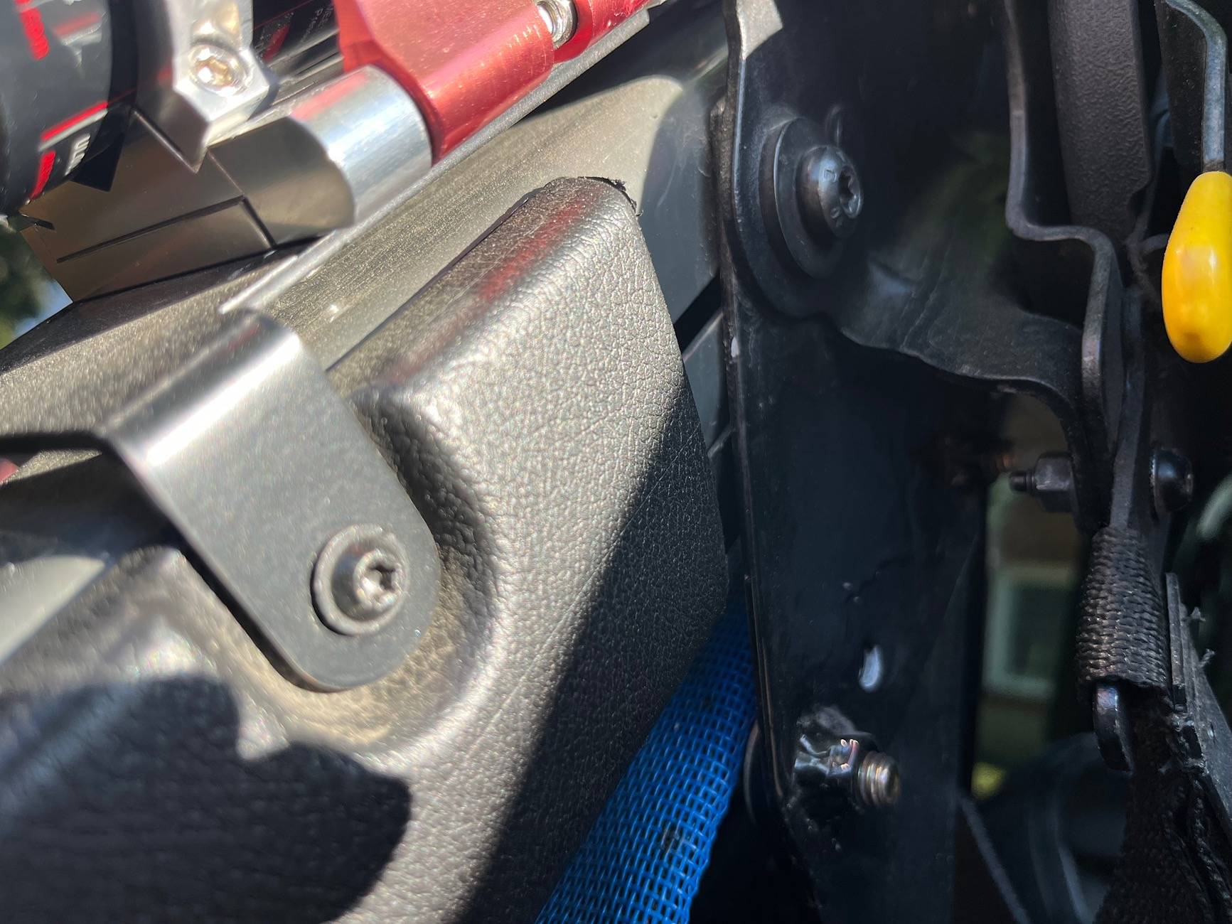

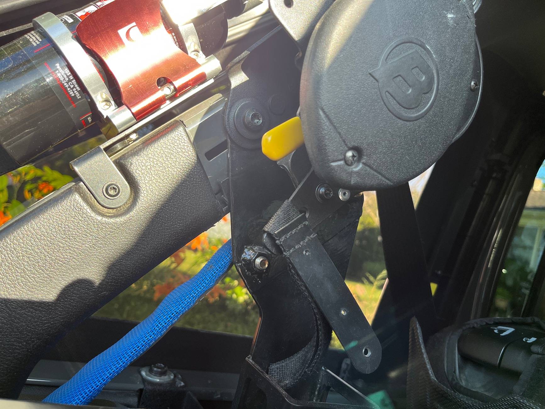

the drop bracket I made in the pics, moves the basket down and back towards the tailgate. I did this so my soft top would be able to fold all the way down and my rear fastback window wouldn’t hit the basket

I also welded nuts to the back of my custom bracket for easier installation.
