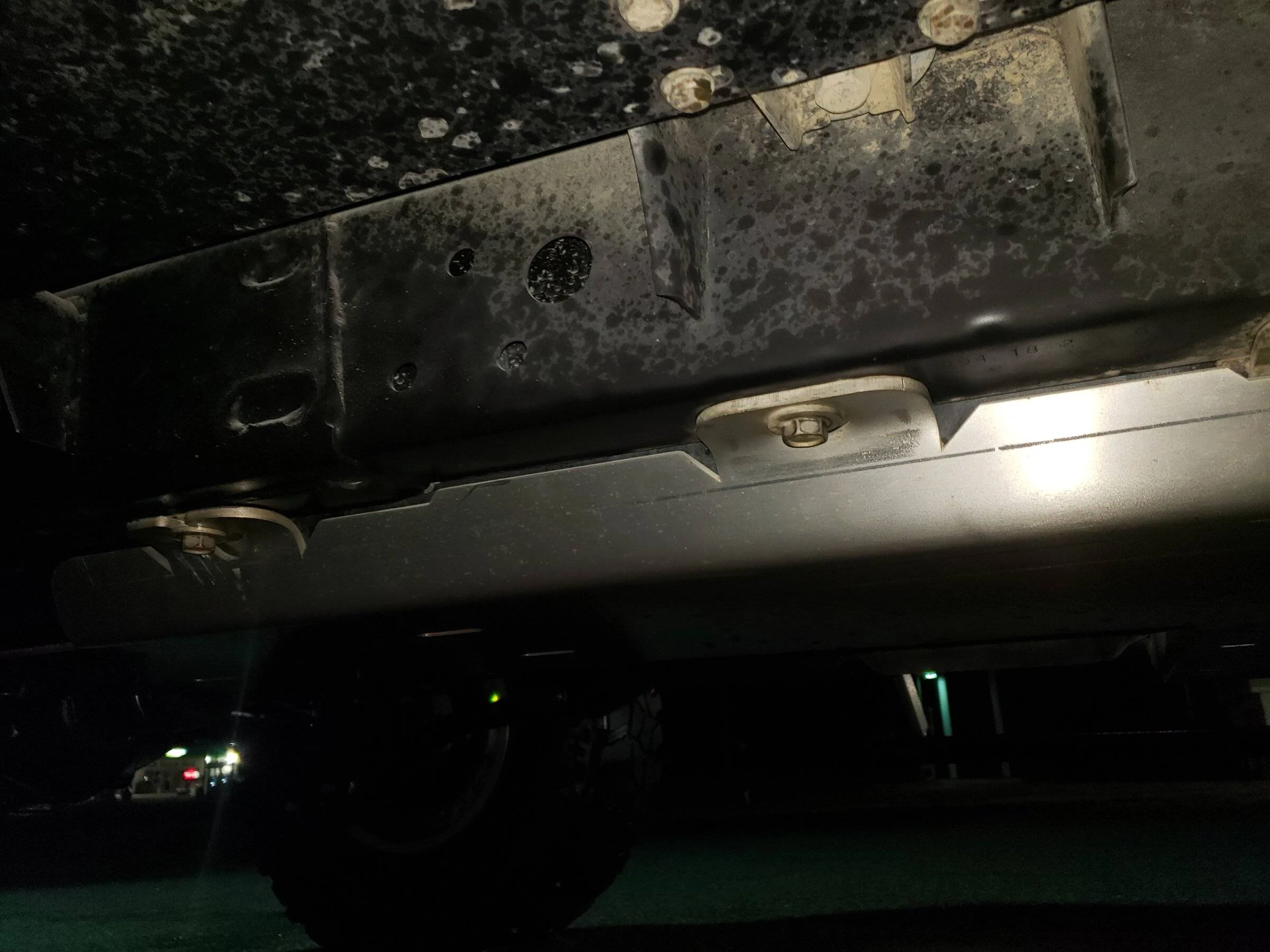

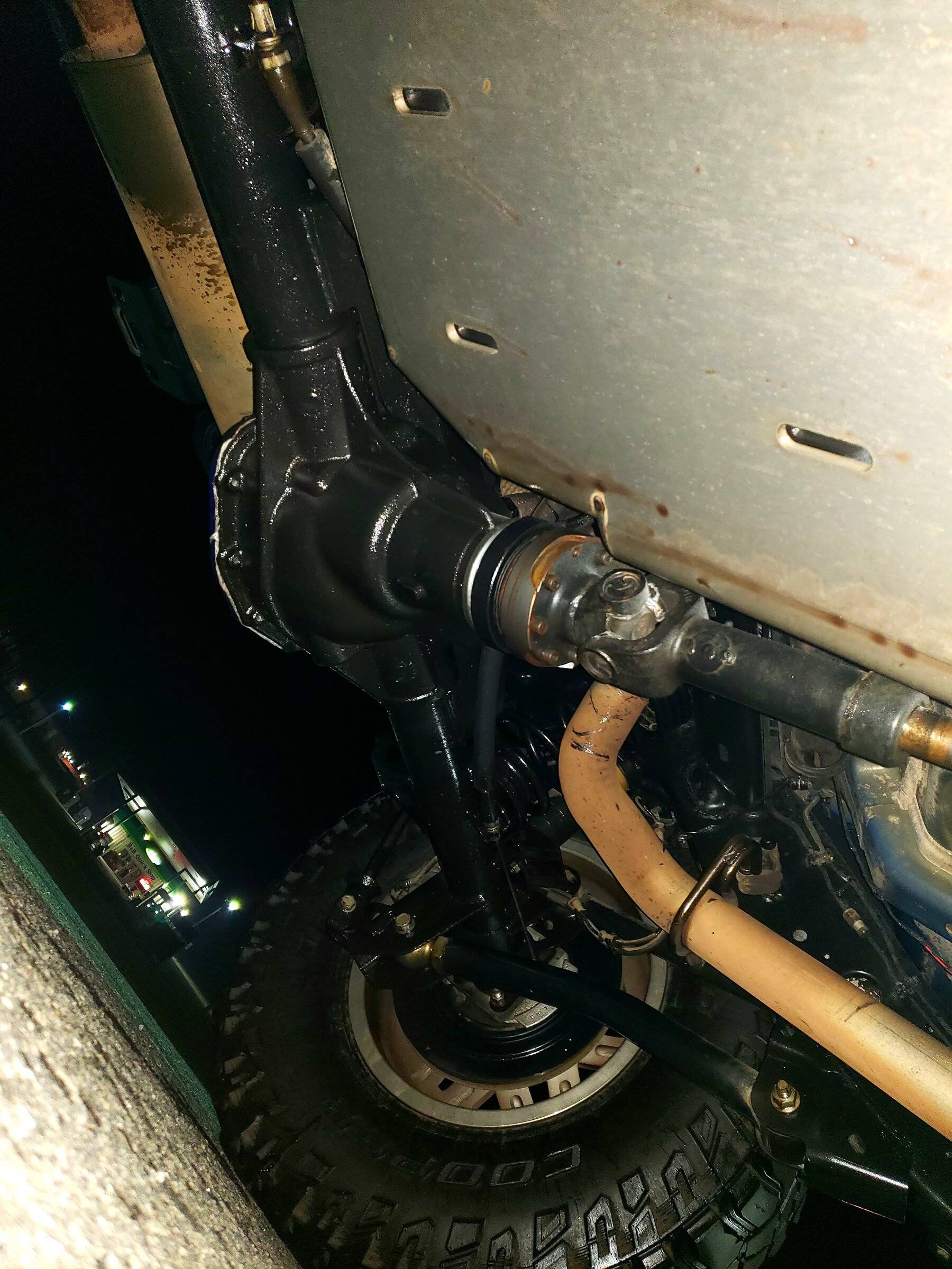

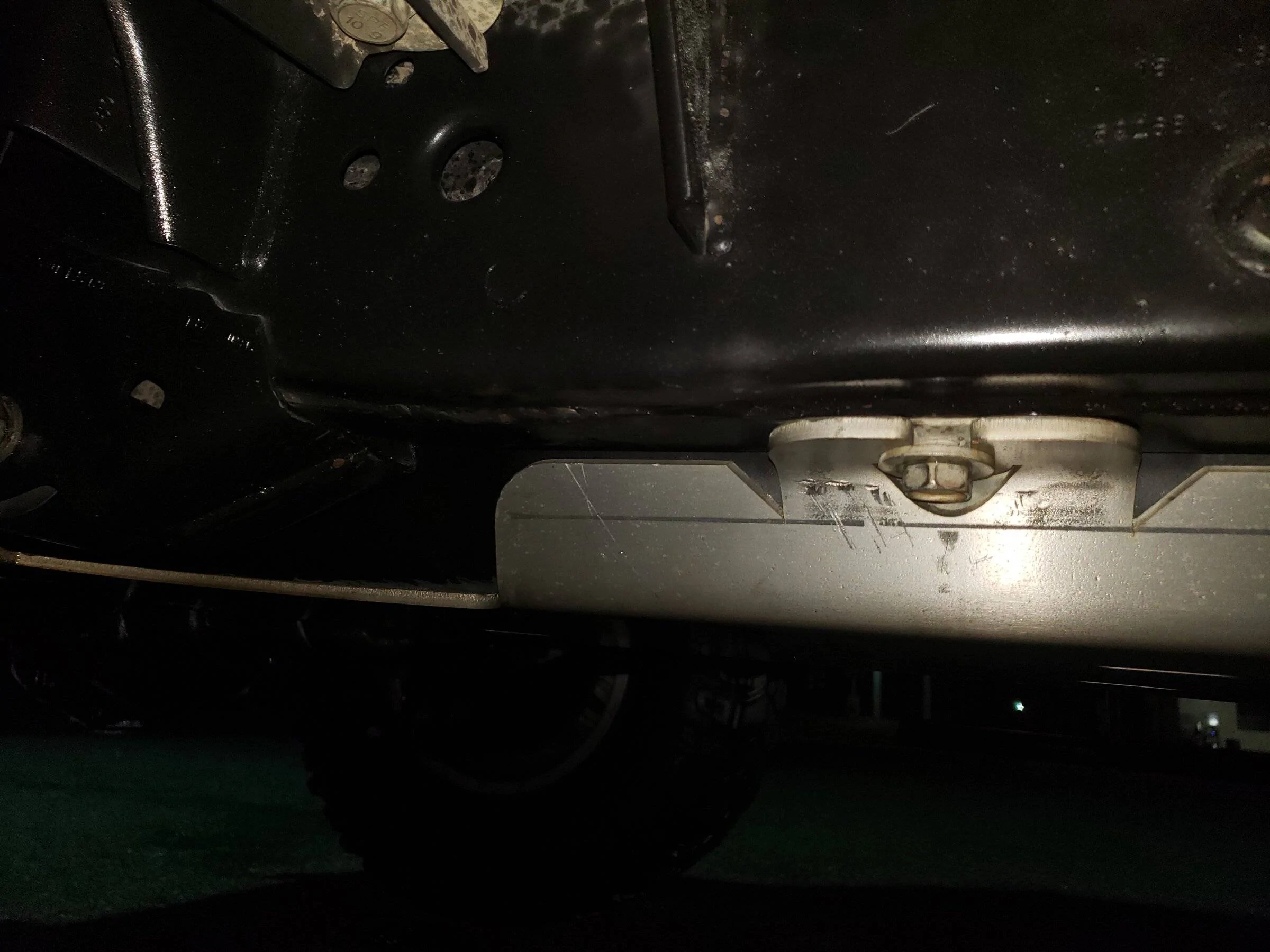

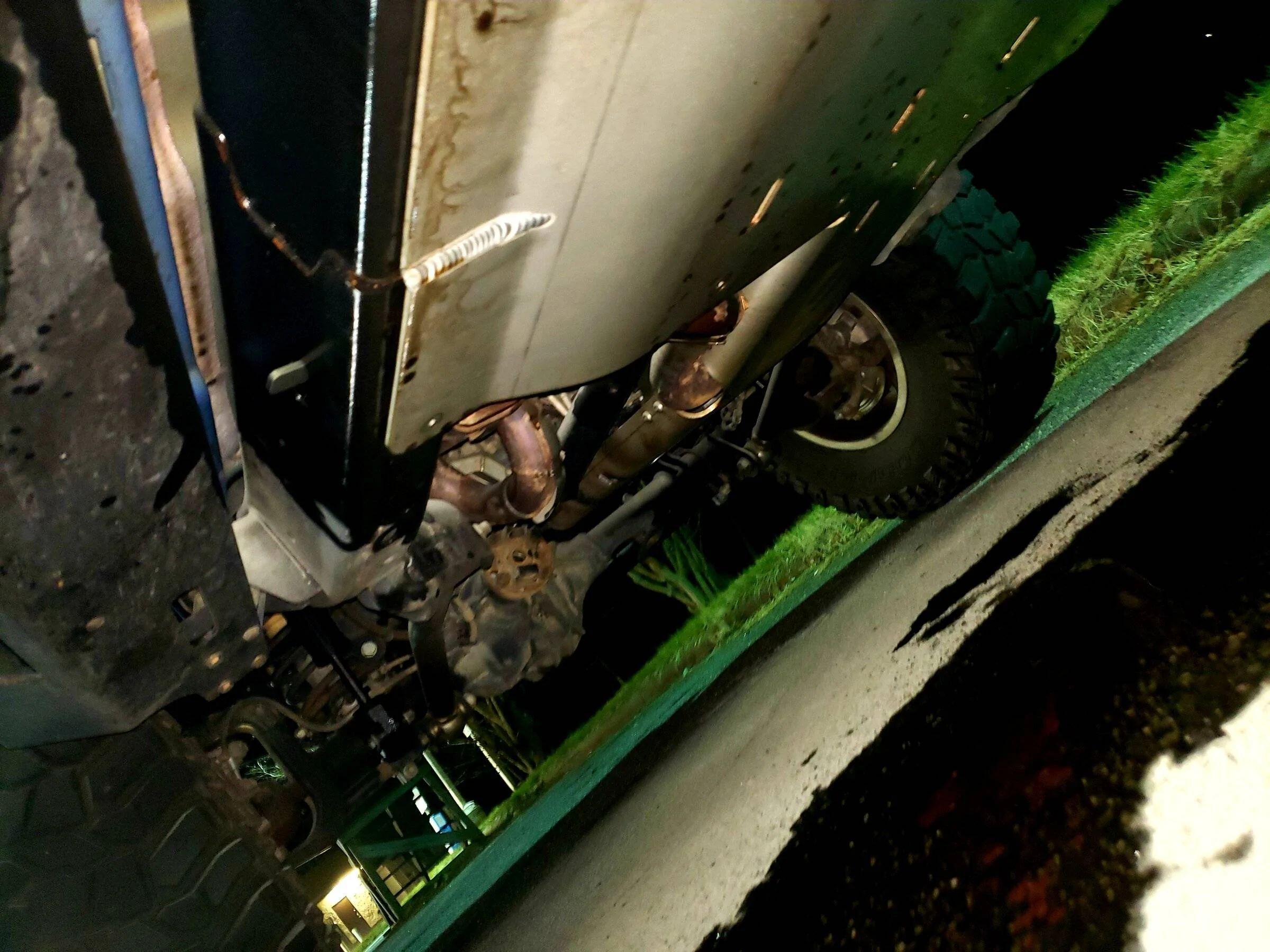

Just got off the phone with the service writer at Lake Norman Jeep in NC. He keeps saying it was something to do with the driveshaft failing. BULLSHIT, I had Adams 1310 driveshafts on front and rear and they don't just fail going down the highway with the cruise on at 70 mph. The insurance adjuster and service tech said in both writing and on voice message "it was an internal failure of the transfer case / transmission that caused hot oil to spray on the exhaust causing the fire" An "INTERNAL FAILURE OF THE TRANSFER CASE / TRANSMISSION" is the key words. It failed, so replace it or buy it back and I'll get a Gladiator. They don't even want to honor the warranty I purchased in March of this year when I purchased it off lease!!!! @Jeep Cares or @Jeep or @FMC needs to step in and do the right thing!
These pictures are from right after it happened and not great, it's hard for me to get down on the ground, especially with all of the oil around. As you can see part of one driveshaft is visible in the one picture. I have not seen the Jeep since then and pretty pissed the Dealership has not kept in touch or sent any pictures of the damage.

Was your front driveshaft detached for some reason? In the last picture it is not where it is supposed to be.

They claim it came apart and that's what caused it transfer case failure. The issue is it started revving up like the transfer case / transmission was slipping really bad and it was in 2wd and not 4wd so the front was not under load. They just serviced it two weeks before.
