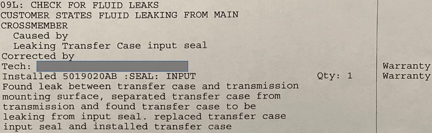

I took it in for service and the first response was that it was the red clay/mud + water packed up in there that was dripping, BUT I had not driven it in TWO months and there was no way it was wet. After they went back, sprayed out the mud, they found it was indeed leaking on the seal on the transmission and the transfer case was also wet - so they're replacing both seals under warranty (should do both if going through all the effort to get to these parts). Assuming I DO get it back in 2 hours as discussed, it will have taken 2 days due to parts but they lent me a JKU. I would say it was a pretty good experience, but I learned to ask for the mechanics that work there that I know in my club. Don't take no when you have clear evidence of red fluid on your garage floor for months.
Where I had seen the fluid underneath was on the screws (middle one but also the passenger side) holding the main crossmember below the transmission just in front of the transfer case.

Here's the outcome from Fury in S. St. Paul, MN; it's all good (luckily I didn't accept their first explanation)! Did take 3 days with the need for parts, but they lent me a JKU.
