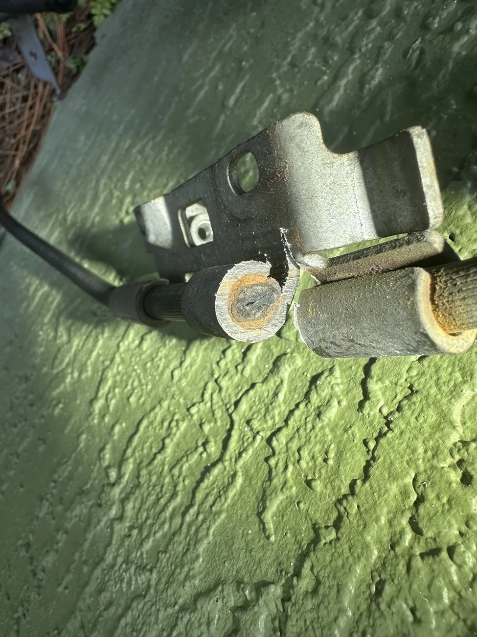

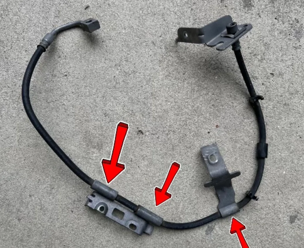

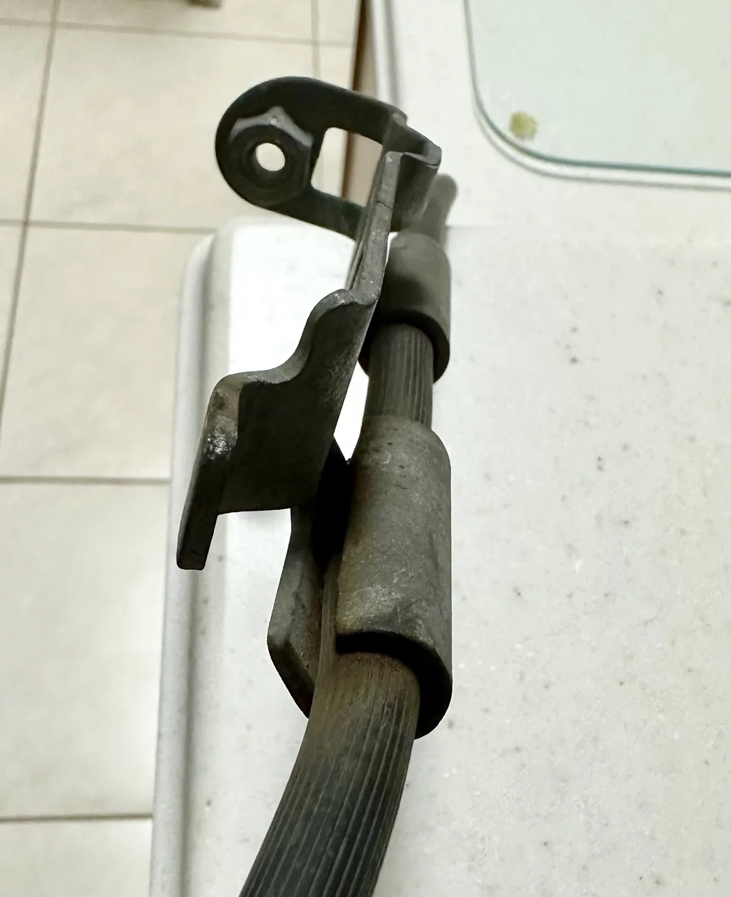

Whew, sorry it's so long. So finally another cousin(paint and body shop owner) said hey, I know what the problem is, happened on a camper of mine. Turns out, it is Jeep in their infinite wisdom, put steel, NOT stainless steel clamps on the front brake hoses. These said clamps are ALL facing upward so as to catch road salt, dirt, etc... Yes, they did this on purpose!! We all know that rust expands and it will expand in the direction of least resistance. So the steel clamps started rusting as planned, and slowly squeezed off the brake line. So every time the brake was pressed, it essentially locked the brake. I sawed one of the clamps open to prove what was going on. Please see attached images.
In the end, everything is shifting like new, brakes don't pull and mpg improved tremendously.
P.S. They put not one, but THREE clamps on the hose.

More common than you would think. I’ve fixed a few suv models with this issue. Always check rolling resistance of each wheel in neutral. Then check for seized caliper piston. Then brake hose. Crack the bleed valve and press brake pedal is quick test. That bracket looks much cleaner on the outside than any I’ve repaired. All manufactures use steel brackets

Yeah, no red glow since the line wasn’t totally occluded till the very end. Each time the brake was applied, the caliper would lock apparently, then bleed off and restart the process. Also yes, probably all steel now, but I feel like in the past I’ve worked on a car that utilized a stainless wire/spring combo.
Pretty sure they know exactly how to build reliable cars, but why do that when they can design a minor part to fail and sell you a new transmission! Functional obsolescence.
