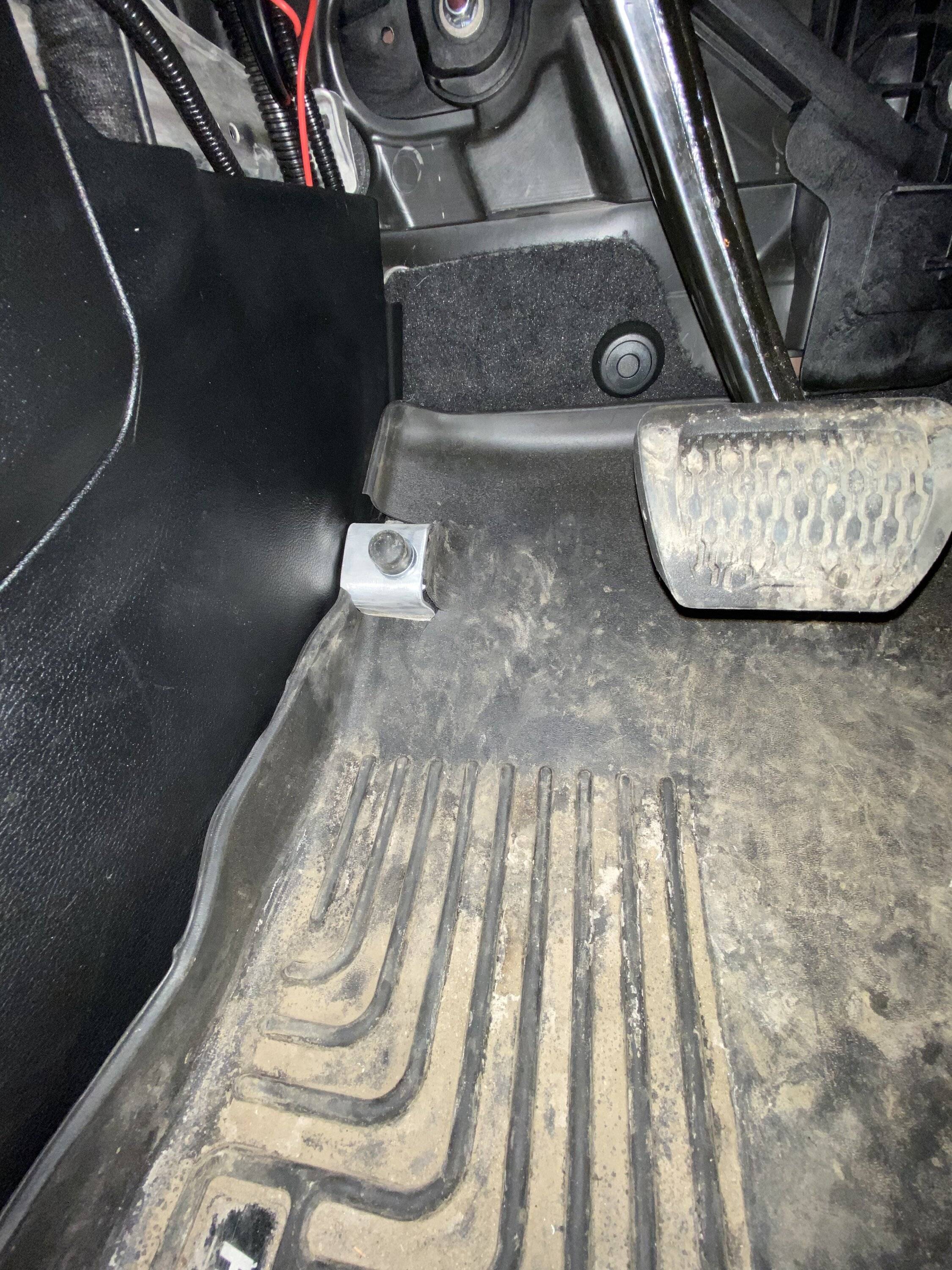

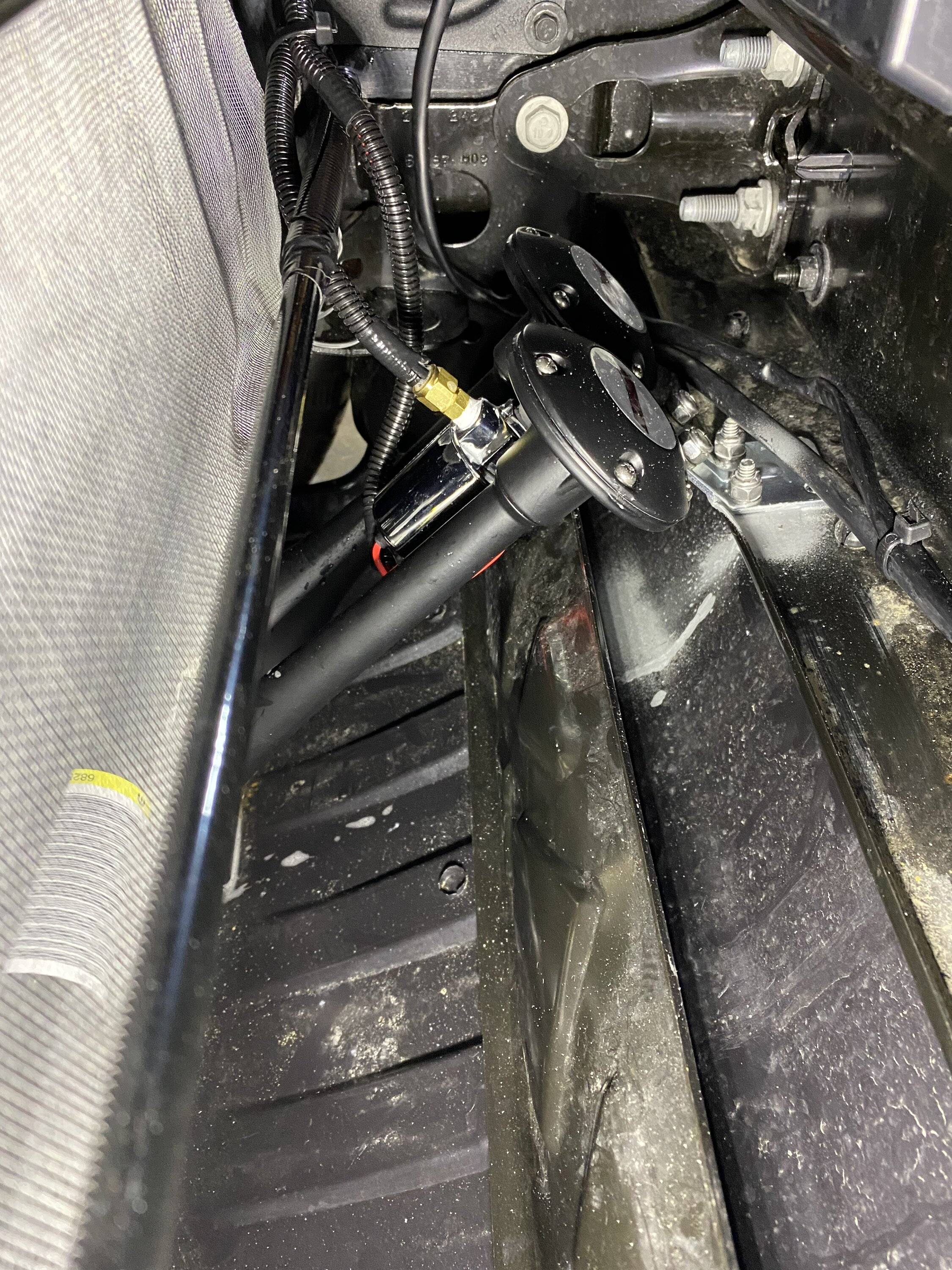

I mounted mine behind the front bumper pointing down towards the axle. Switch for the left foot too. I don’t have a tank, just an ARB single compressor, so it kicks in of course when I hit it. I have 5 horns on my Ram 3500 with a 5 gal tank and the same foot switch.
And No, I don’t carelessly use these. They are for scaring wildlife into making a decision or for preventing a traffic mishap. Also great for scaring friends and family too?
