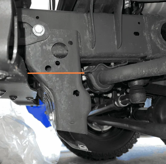

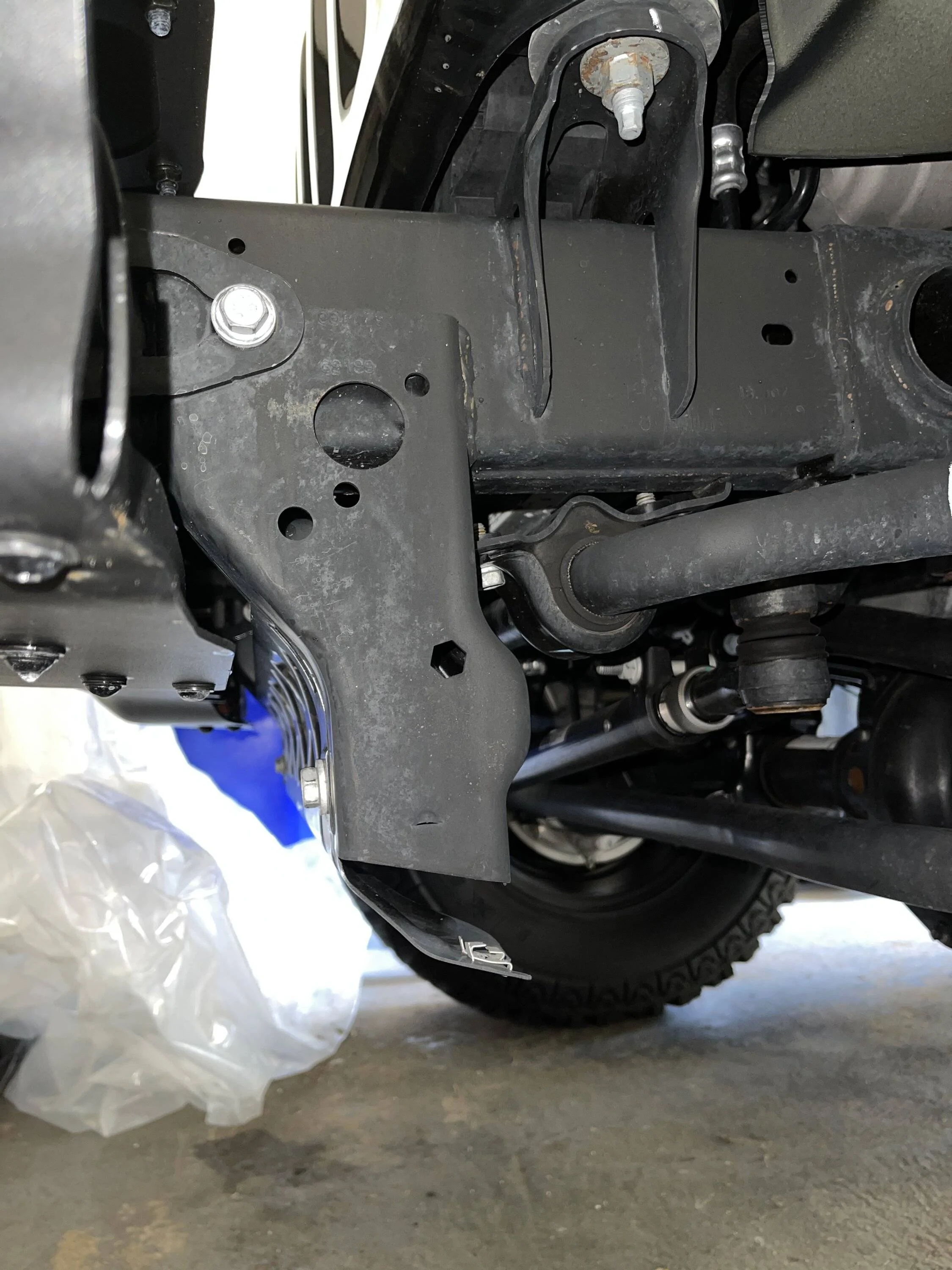

Hi All - How does one go about removing the front two horns that are used to mount the steel skid plate under the airdam?
Jeep Wrangler JL How to Remove Front Airdam Horns 9083A85E-9ACD-4503-BC30-47D4A81047B1
Id really love to remove the steel plate but I hate how the horns make the front end look.
Any help here would be greatly appreciated.
Thanks!

Cut to fit GenRight high clearance bumper.......Can use a sawzall or cutoff wheel......then shape and smooth with grinder and prime/paint.

Like Chocolate Thunder said, or 4” grinder with a cut off wheel. Both are good tools to own if you don’t have one. Or a friend or family member likely has one.
Boom! Thank you for the visual explanation, it's super helpful.
Looks like I just found my plans for the weekend ? ?

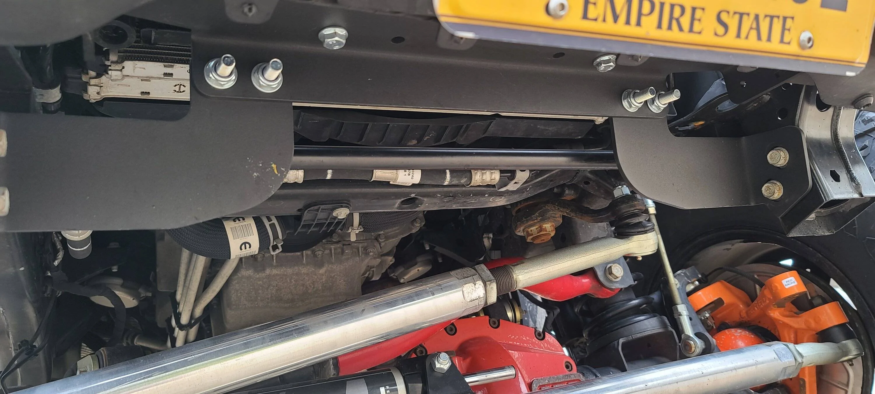

I almost cut mine off after I deleted the sway bar edisconnect system, but ran out of playtime on that particular day. Glad that happened when the Warn winch and mounting plate showed up a few days later and I realized that the mounting plate ties into those horns for added structure. And yeah, now that the underside of the bumper is opened up, those horns are the only protection for not shearing the sway bar bushings off of the frame. Also, in my opinion, they really don't seem to stand out...
