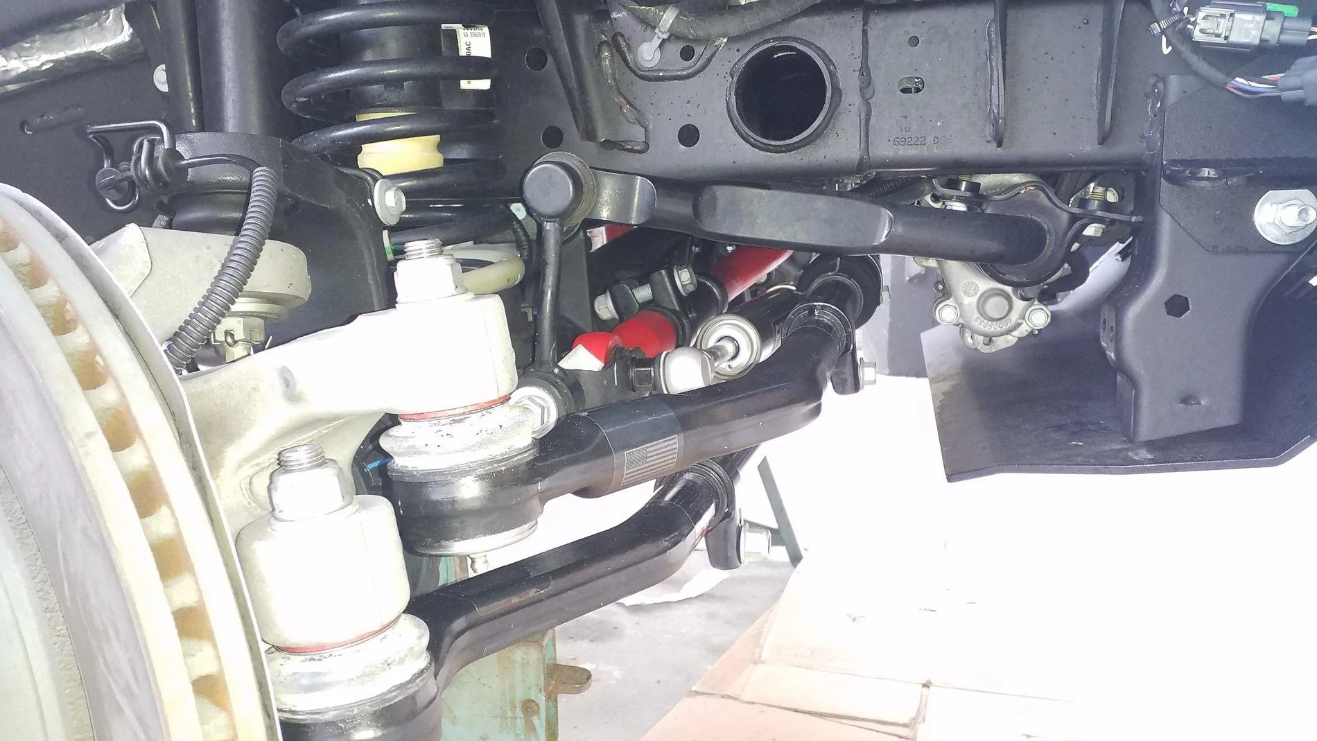

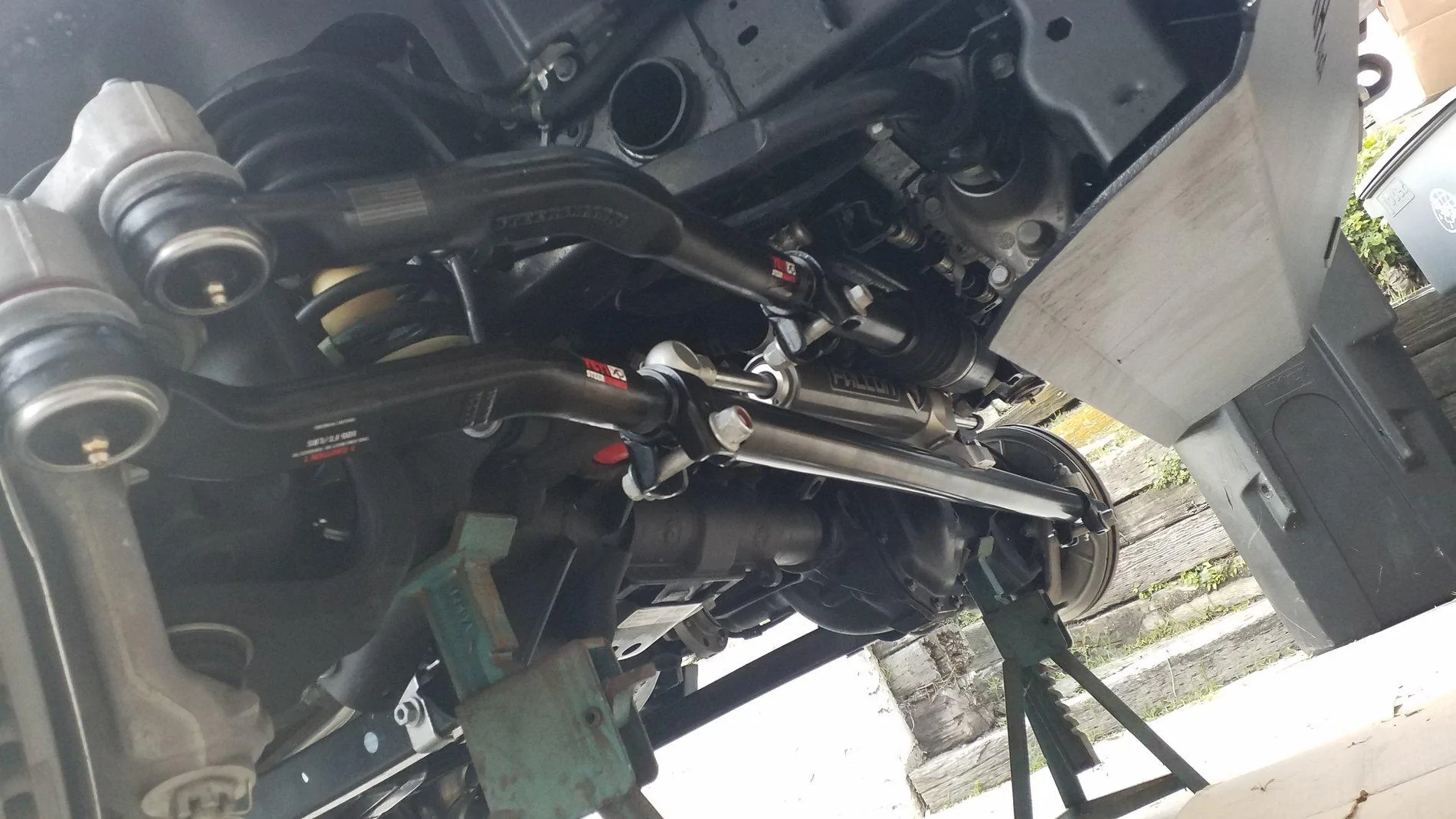

I have the stock diff cover, so I don't know . I also installed the SteerSmarts draglink with the attenuator. The attenuator is basically a bidirectional spring to absorb the shock from a tire impacting something sideways, so it doesn't break steering components. Between these two parts, I was unable to install a steering damper on the center-left side like other components might accomodate. If I had bought the draglink without the attenuator, I could have installed the damper between them. Instead, I had to put the damper in the stock right side location.
The picture below shows a Falcon damper between the yeti trackbar and draglink w/attenuator. It just doesn't have enough room for suspension articulation and full steering movement.
Thanks. This is helpful to see everything together. We all want bigger or stronger but you run out of real estate quick down there. I've read several comments about difficulty fitting the through shaft stabilizer even without the attenuator, so that makes sense. I was already worried about that but the diff cover was a new one. That 2" forged end is a half inch bigger around than most aftermarket 1.5" DOM, so I could see that getting tight.
