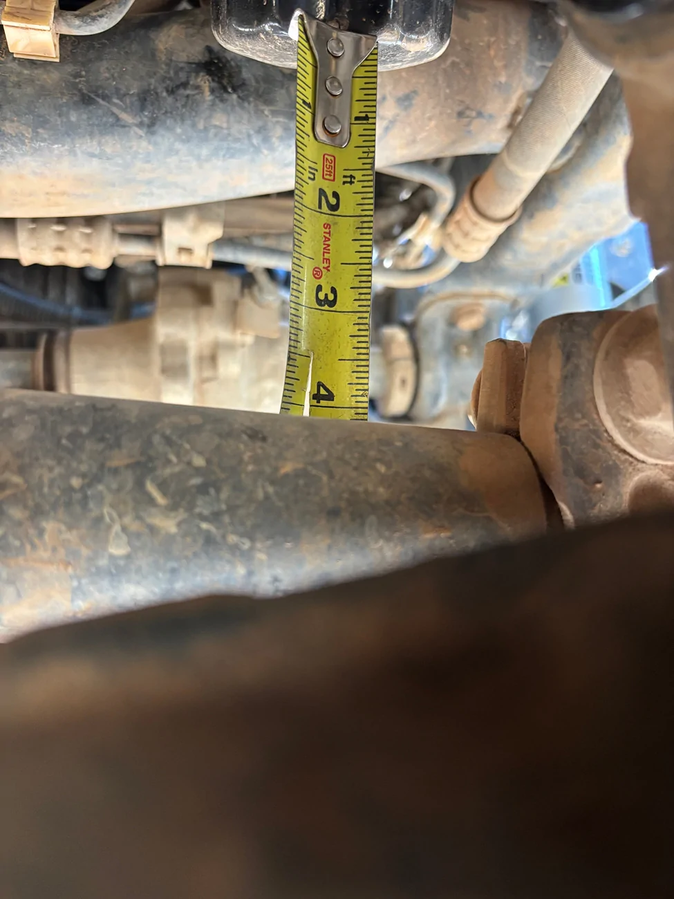

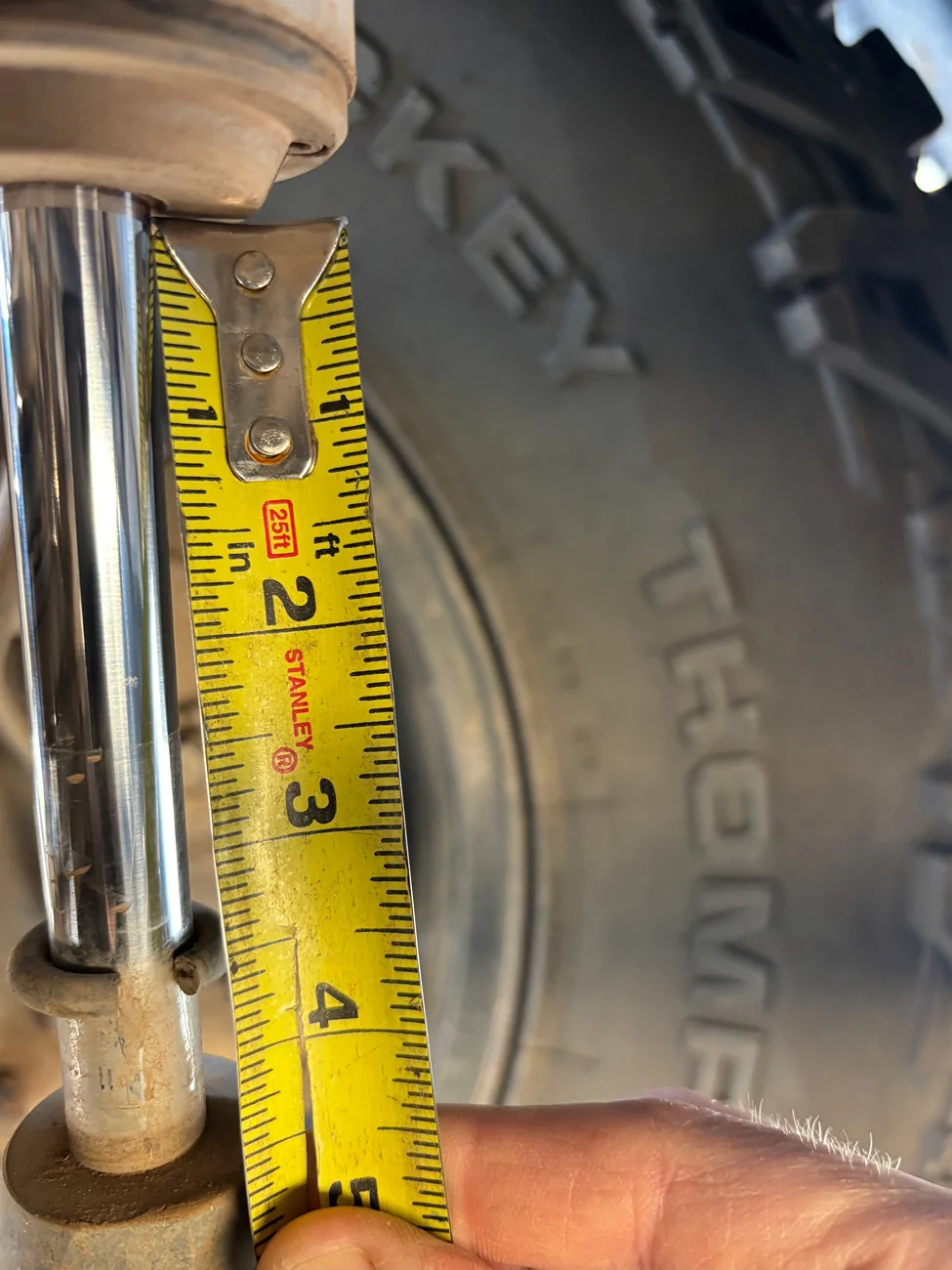

Has anyone else have issues with the adjustable trackbar hitting the oil-filter? I am talking about mostly the clamps of the adjustable trackbar. I have the small oil-filter 0339 installed And a steersmart yeti xd adjustable trackbar.
I've got the Steersmarts Yeti adjustable track bar also with no issues reagrding oil filter contact.
This is with the Wix OEM equivalent filter (57060) which is 3.5" tall. The clearance from the track bar to the filter is about 4-1/8"; my axle up travel with stock bump stops is about 3-5/8" as shown after a recent outing that drove the axle solidly into the bump stops. Sorry about the angled picture of the shock measurement - a straight-on view gave the 3-5/8" measurement.
The track bar clamps appear offset enough left-right that they won't contact the filter.
The resulting clearance is about 1/2". Enough for the stock filter but might be an issue with larger options.
