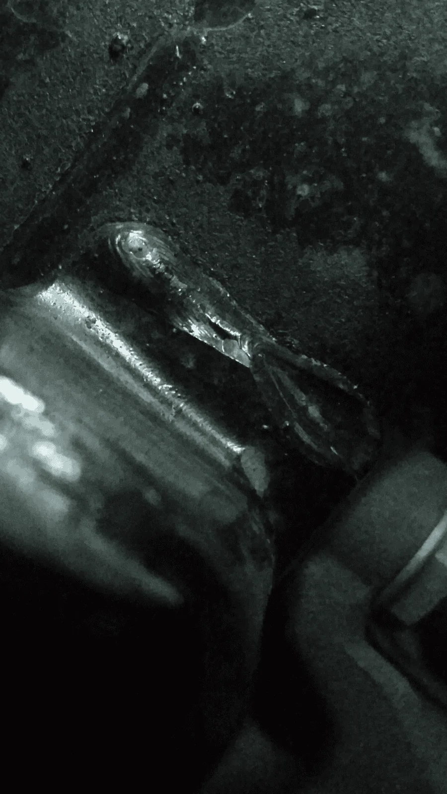

Track bar weld repair
TDjeep
Oct 23, 2018
Pa
2018 JL Wrangler
My jl is on the recall, including the build number, so my dealer will be taking photos to submit on Thursday. I'm wondering how everyone else is feeling about the fix. I'm very curious to see how good the repair weld is. Has anyone had a repair yet? My outside weld looks pretty good, inside weld is shaky at best.

Pic of interior weld
Jeep Wrangler JL Track bar weld repair Screenshot_2018-10-06-09-25-56
