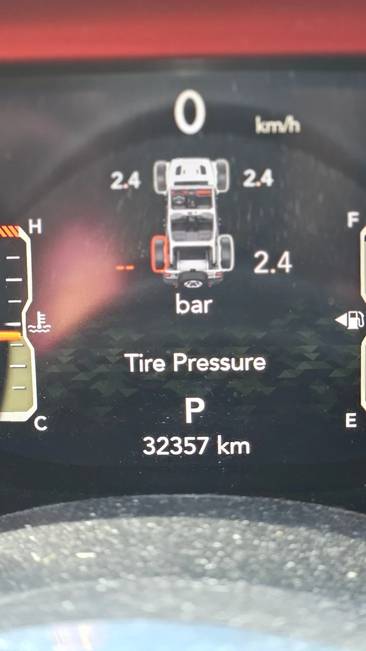

I am not sure if theis is appropriate message here but I have the (picture attached) on my dash cluster after rotating the tires. I understand the left rear needs air but am unsure as to what the 2.4 refers?

2.4 bar is a measurement like PSI. you're in metric. drive it a bit and the sensor should pick up

Thanks that explains it. Being an older fellow (75) I was brought up with pounds/sq inch and sometimes for get that we have metric now in some places.
