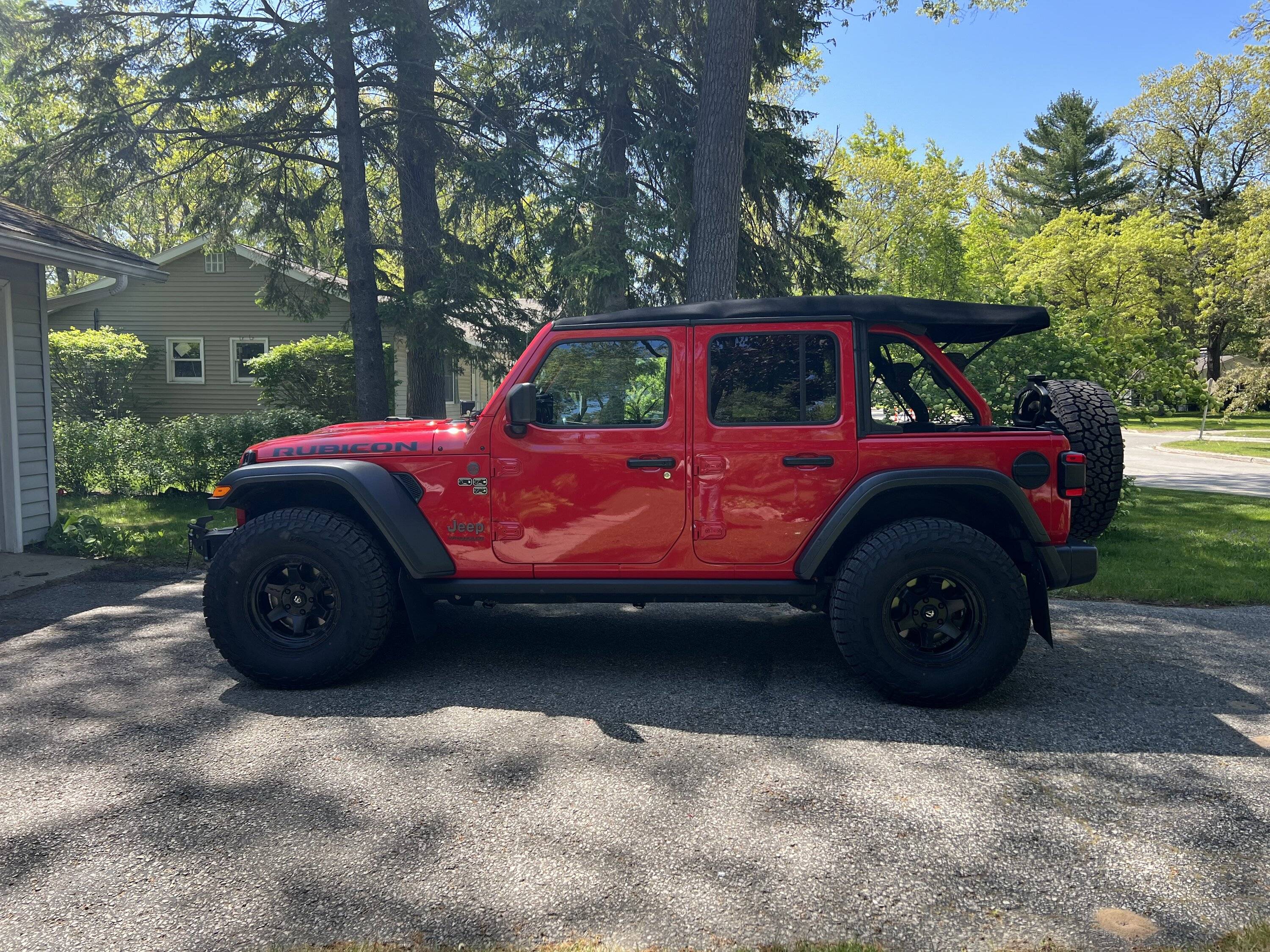

Pics for attention: 35x12.50 Falken Wildpeak AT3/W on 17x9 +01mm Fuel wheels
