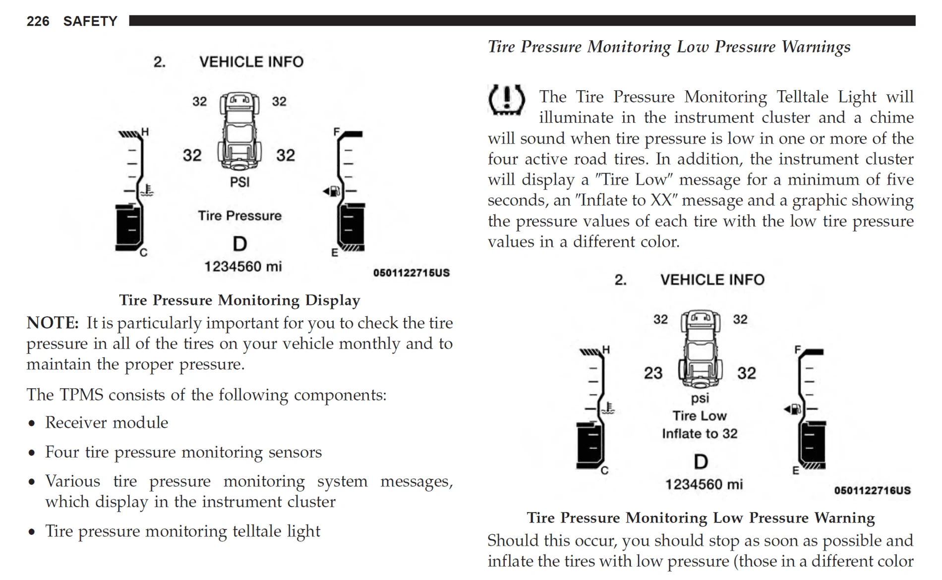

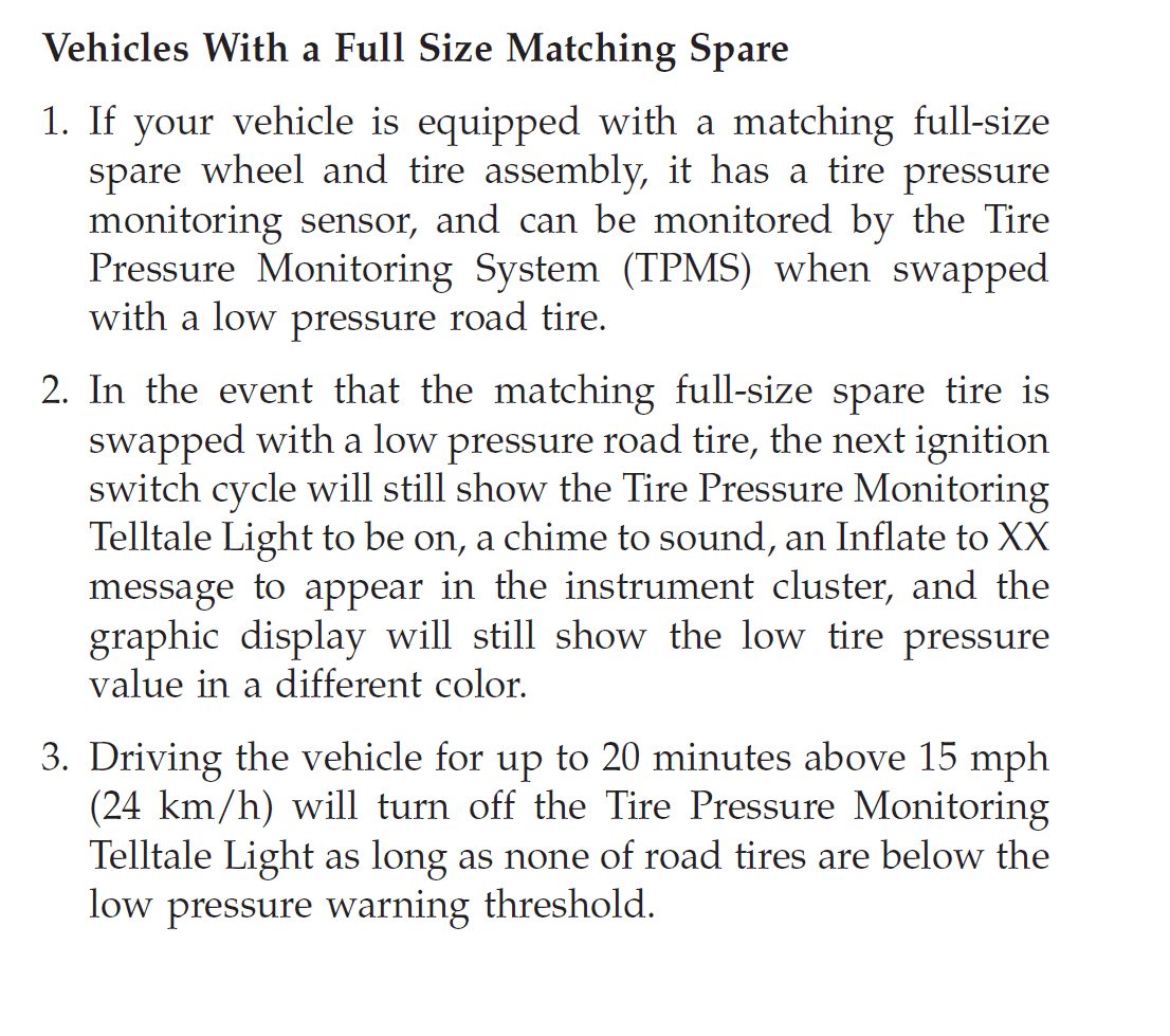

Here are pages from the owner's manual:
For those stumbling on to this thread/post.. and to the OP, that has a 2018 JL.
For those reading this post..... this info is out of a 2021 Owner's manual.... Much you read in this excerpt will not apply to say a 2018 or 2019 JL.
