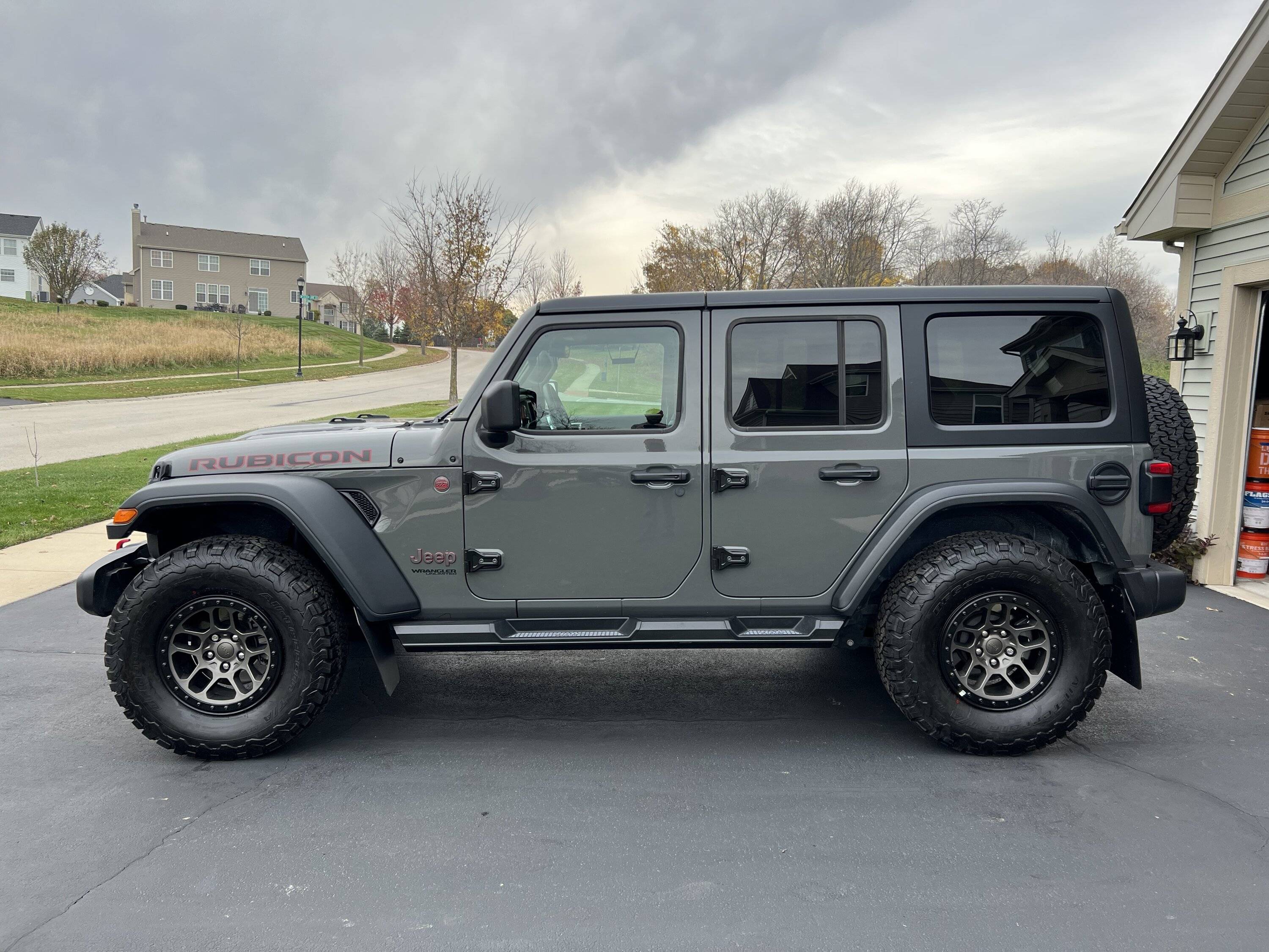

I have a pre 6/21 build 2021. I put on 2023 392 XR take off wheels with the new TPMS design. JL now says no sensors detected. Is there anything I can do to get the 2021 to read the new style sensors, or am I stuck with needing to get the sensors swapped over?
Thanks in advance!
