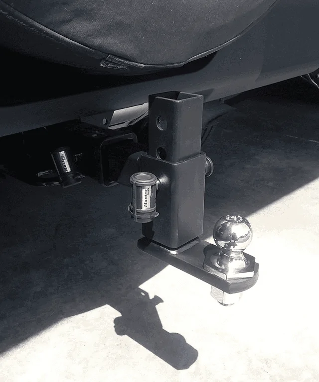

I will be moving in a month.
I am planning to rent a uhaul trailer.
I was looking at trailer hitch with ball, 2"
What sort do I need? I have a 4" lift and 37s.
I will likely only use it once as I don't tow anything, so nothing expensive, but nothing dangerously cheap either.

U-haul states:
“The optimal ball height for towing U-Haul trailers is 18½ to 18¾ inches. This is measured from the ground to the middle of the hitch ball, prior to connecting the trailer.”
Measure your receiver height, do the math, buy a drop that makes it work. None that you buy will be “cheap”, just vary in price.
Walmart is always a good option. Just be sure the ball shank matches the hole in the drop!

UHaul sells a variety of ball drops so you may be best off just letting them help you out. Otherwise, I like farm supply stores for things like this, such as Fleet Farm, Tractor Supply, etc.

Something about like this would likely work for your lift + tires, but you'll have to measure to be sure: https://www.uhaul.com/MovingSupplie...unts/Ball-Mount-(7-3-4-drop-16-length)/?id=96
EDIT
I just did some measuring on our Rubicon and Cherokee Trailhawk, and with your lift+tires this ~8" drop will be about right for towing a UHaul trailer. The factory hitch actually sits 2" higher on the Cherokee than Rubicon. We used a 4" ball drop for our cross-country move plus other tow jobs with the Cherokee. I added 6" for your lift + tires, then subtracted 2" for the vehicle difference. 4+6-2=8
I second this. When I rented a trailer at Uhaul the guy took a look at the particular height of my JL and assembled a ball drop that was the correct height. They actually know what they're doing, so I would just buy it from them.

To repeat what @AndySpill said: you're pretty much screwed if you have a soft top and want to rent from U-Haul.
Their site claims 18" to the bottom of the ball, but, but in person they'll say 16. Not exactly consistent. 18 is too tall.
