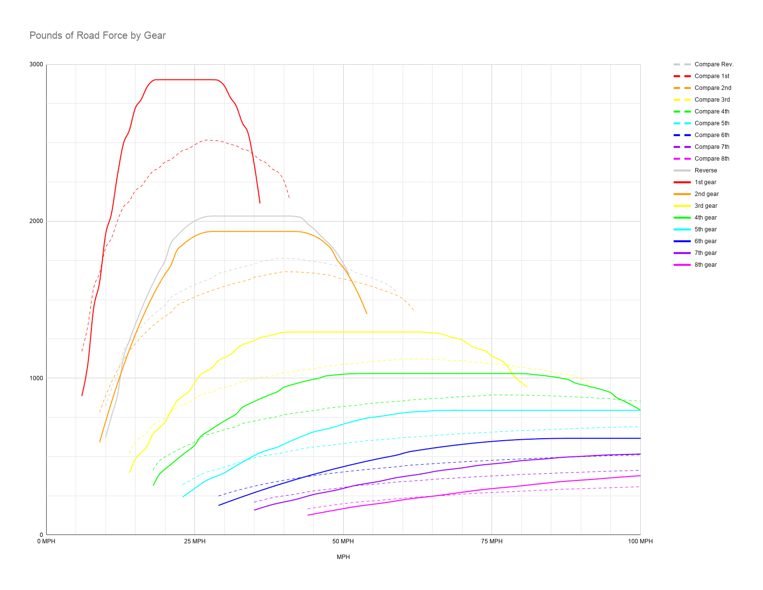

I haven't driven both engines with 35s, but I can graph out the road force for each scenario. I think that because of the 2.0's lower redline and higher torque, there isn't as much of a need to re-gear (at least in Rubicons). The biggest issue seems to be the loss of a usable 8th gear (or 6th for the manual). For a good comparison, I calculated that the 3.6 Rubicon auto has about 382 pounds of road force at 75MPH. Both scenarios you have described are about 290-300 pounds at 75 MPH, which may not be enough to use 8th gear.
This graph below is with 35.0" tall tires with 1.1" of tire sag, 3.45 differential ratio, & 17% drivetrain loss.
Solid = 2.0
Dashed = 3.6
Jeep Wrangler JL Tires VS Engine Pounds of Road Force by Gear
Solid = 2.0
Dashed = 3.6

Not being familiar with the road force you referenced is the loss of 8th because of available power? Drivetrain rotating slower because of the larger tire?
The road force is can be thought of as the amount the tires are pushing against the roadway. It is a similar concept to axle torque, but with the tire height also taken into account.
The loss of 8th gear would be because with 3.45 gearing the torque in 8th gear at 75 mph would not be enough to overcome wind resistance, drive-train loss, etc. Going to a numerically higher gear ratio is one way to solve this, weather that means using 7th gear or a different axle ratio.
