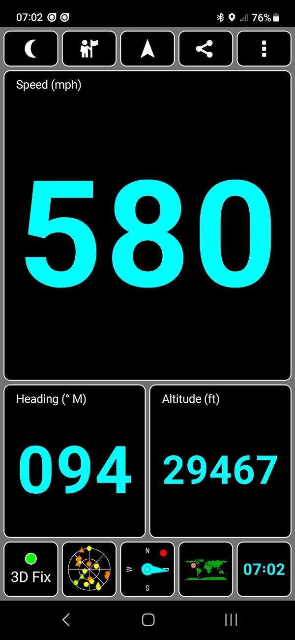

Old school. Yes there are different gears for the speedo cable output. You'd have to research that particular Jeep model transmission. Amazon/Autozone/O'Reilly's should have a "set".
Calculate real speed by time to do one mile @ 60 MPH or a phone GPS with options program. Calculate error % vs number of gear teeth. Change and re-check. I use "GPS test" phone app.
https://play.google.com/store/apps/details?id=com.chartcross.gpstest&hl=en-US
Fun when flying. Doesn't need a data connection.
I used a GPS app to validate the tire size recal on JSCAN. Worked great on a straight stretch of hwy.
