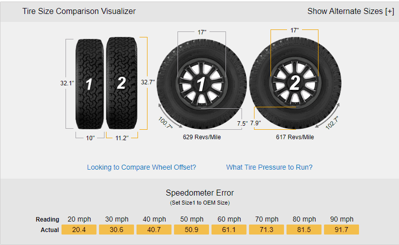

Download a speedometer app on your phone and go out driving and check the difference, it shouldn't be too much if at all. Most manufacturers have the speedometers a mile or two over actual speed. So if your speedo says 60 your really doing 58 or so.

Yeah I don’t care that much tbh, lol. I just was curious if going slightly larger made it necessary to recalibrate

Difference is not important enough to change anything in the computer. New tire size divided old tire size will give you the error percentage. Rule of thumb is that you can go up to 5% difference before needing to dial-in new tire size.
Your difference is not even 2%. So dont worry about it?

If you think you're going 79, and the cop clocks you going 81....you'd definitley notice the differnece here in CA between not being worth the cop's time and getting a ticket with a 3X multiplier on it....
CHP said I was going 75 in a 65, after a “puzzled” look at my speedometer he asked what it was showing, replied 68, he looked at my new tires and said they were throwing the speedometer off better get it recalibrated and left. There are descent ones.
