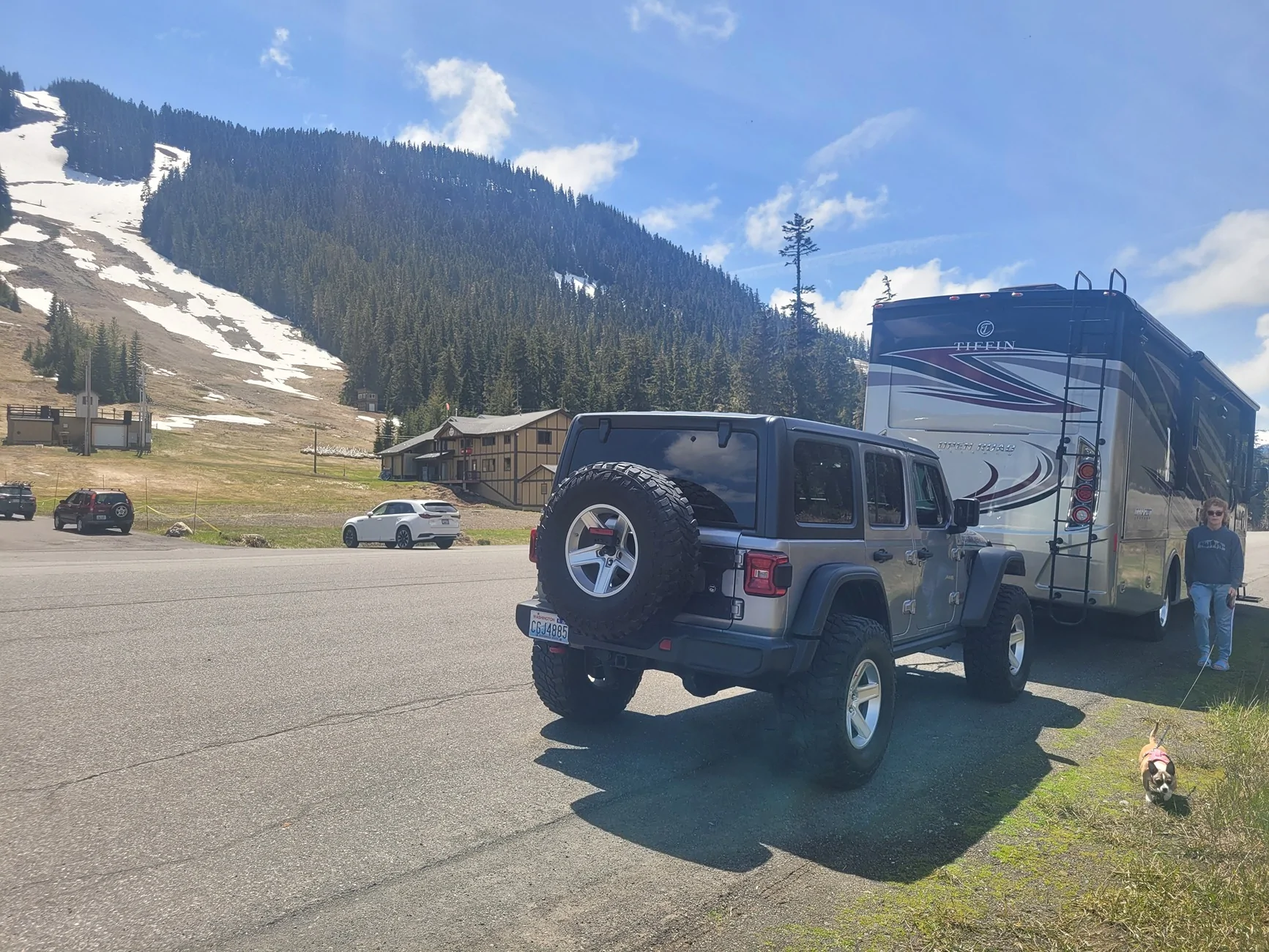

I've been flat towing Jeeps behind motorhomes since 2006. 4 different Jeeps, 3 different motorhomes. Keep a close eye on the driver's front tire. At the first sign of abnormal wear/cupping, rotate. They all did it. 33, 35, and 37 inch tires. MTs worse than ATs. All Jeeps were within alignment specs with no wobbles. I blame it on the crown of the road. Jeep wants to track towards the shoulder while the motorhome pulls it straight. Some may disagree, but that's my story! Happy camping.
Jeep Wrangler JL Tire rotation miles 20250521_125820
