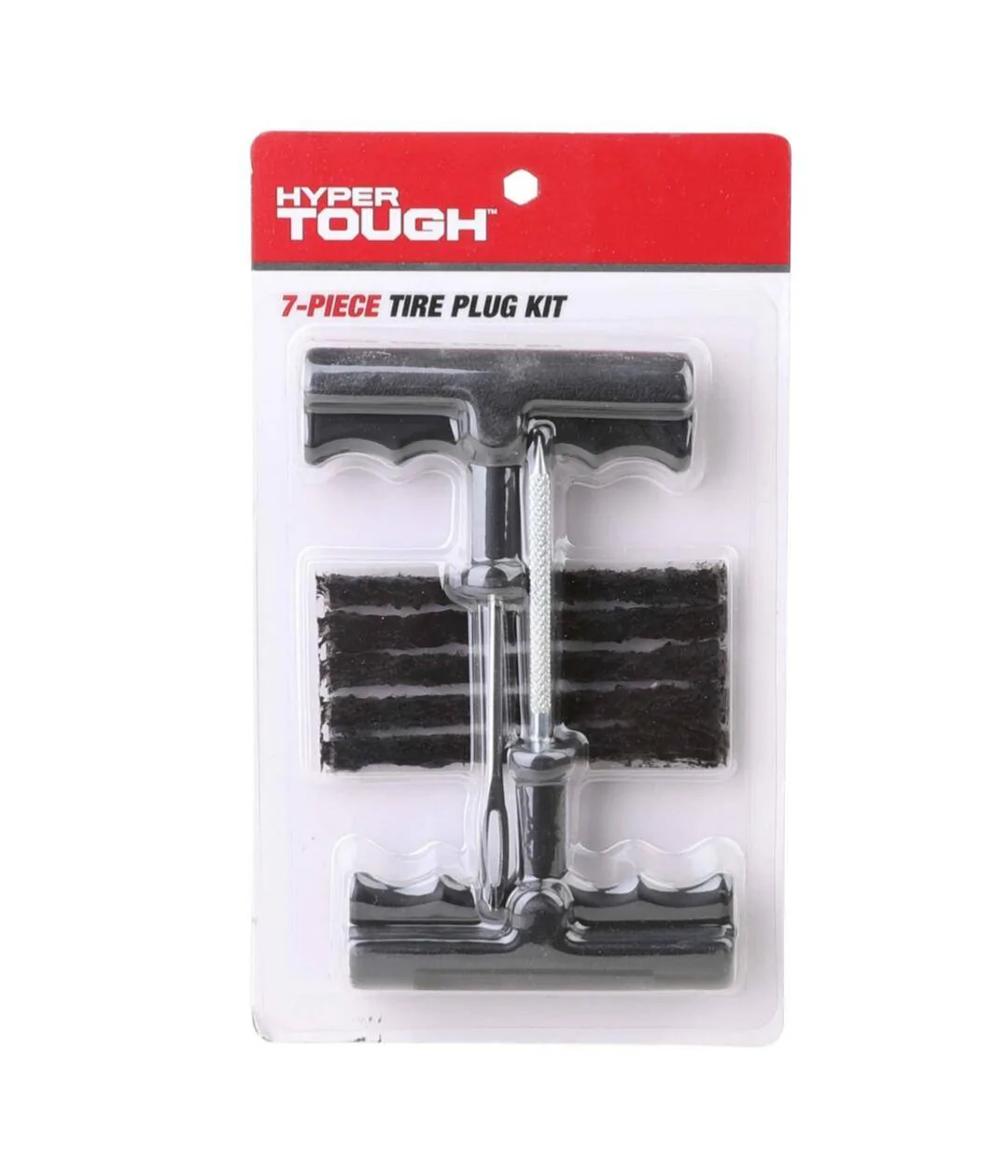

I've never tried that but it's got good reviews. Pricey. I typically use one like this with rubber cement. Do not use the white adhesive Slime kits have now, it's garbage. Use Gluetread for sidewall repairs.
https://www.amazon.com/GlueTread-Fu...c9ae84311a893371a3955092cf3f11e8&gad_source=1
Jeep Wrangler JL Tire plug usage Screenshot_20240715-132949
Thanks, the one I have right now is the orange colored plugs, I've not been impressed with it at all... I pulled a 1/4" steel rod out of my wife's tire, it was still in the tread, but too far out for local shops to repair it... For now, I just stuck a plug in it, but prefer to do something more permanent...

I use 10-15 plugs a year, between ATVs and vehicle’s and helping out random strangers. If I plug a tire for a stranger they always ask how long the plug will last. I tell them I have never had one that didn’t outlast the tire but if taking it to a tire shop and getting it patched from the inside makes them feel better then do it. I have had great luck with these and I never use the glue.
https://www.amazon.com/Bell-Automot...1721068854&sprefix=Monkey+grip,aps,167&sr=8-3
never delt with the plug patches from the inside because it’s a more involved process but I can understand why it would be more reliable for the long term.
https://www.amazon.com/BETOOLL-Repa...&sprefix=betooll+plug+kit,aps,124&sr=8-3&th=1
I use a similar plug kit to the ARB but to anyone looking to buy a plug kit I would suggest getting the tool kit that has metal handles on the tools not plastic. I was pushing a plug into a tire one day and a plastic handle tool broke and the metal shaft stabbed into the heal of my hand towards my wrist.
