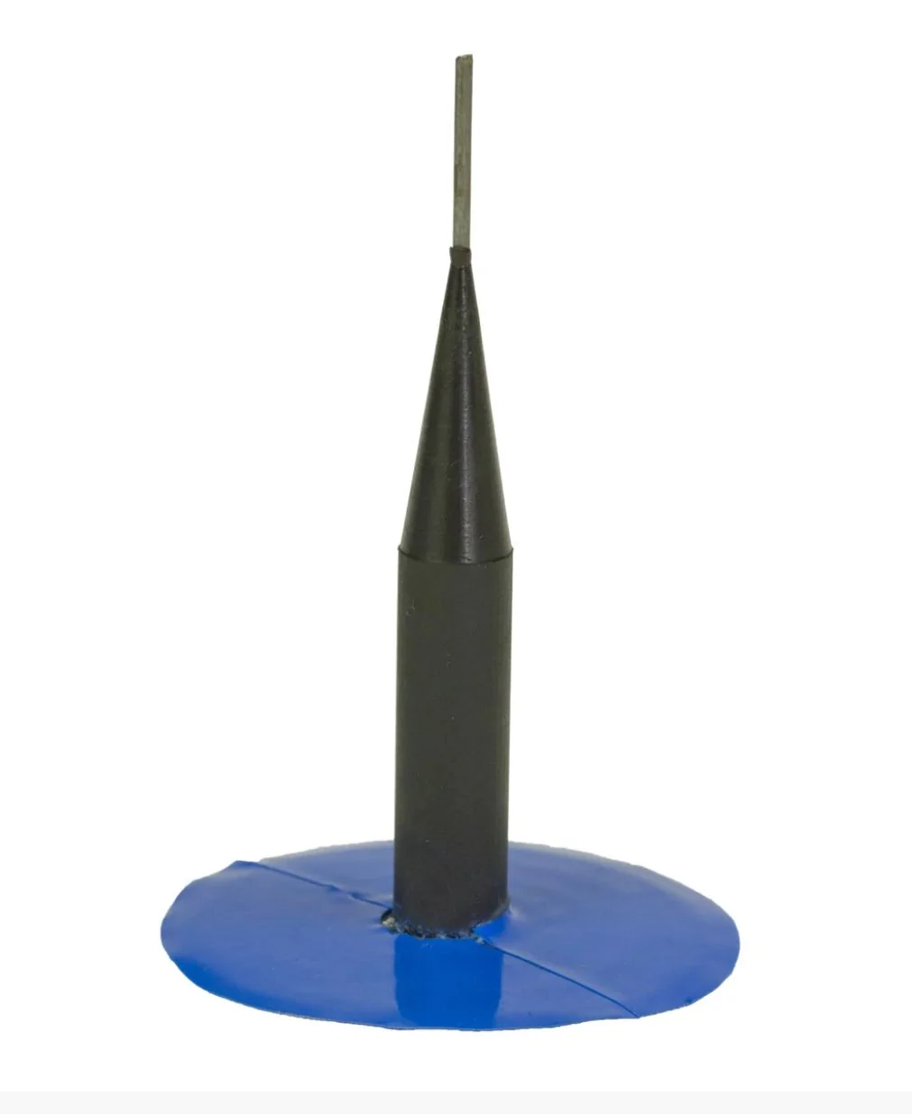

By the way.... a lot depends on where the puncture is. Also, repair if prudent is usually done with a plug/patch combo (not a plug or a patch) as seen in this pic..
