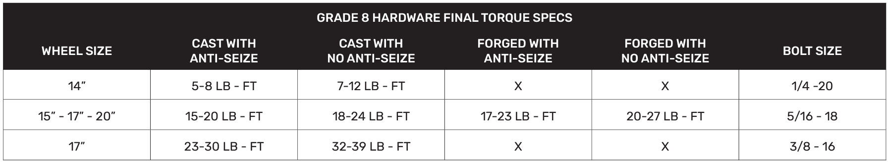

I currently have method racing (MR305 model I think) wheels with 35 Inch tires mounted - how often should I be tightening these beadlock bolts? What torq specs should I tighten them too? Is there anything else I should be aware of? I also know they are technically not street legal because they have beadlocks - but I’ve never heard of that being enforced??

I also have Method beadlocks, I just checked the torque on my the other day after 1000 miles and only a handful needed to be adjusted. The wheels come with a sticker that says check every 300 miles.

What specs do you torque them to? I don't have an impact or anything just a hand ratchet.

Mine state 18 to 22 pounds. I torque them to 22 pounds and everything is good.

Inch pounds or foot pounds?

.I go over them after the first 100 miles. Then again after another 100. I did not get any loose bolts on the second time around. IF I did I would keep checking them at a hundred until they stopped loosening. I will now check them at every oil change (3000 or so). I torque them to 20 ftlb. This is my third set of method beadlocks. After initial set in they have not really loosened up on me. I use anti seize when installing them. If you really beat on them I would stick to their recommended 300 mile check.
