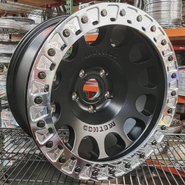

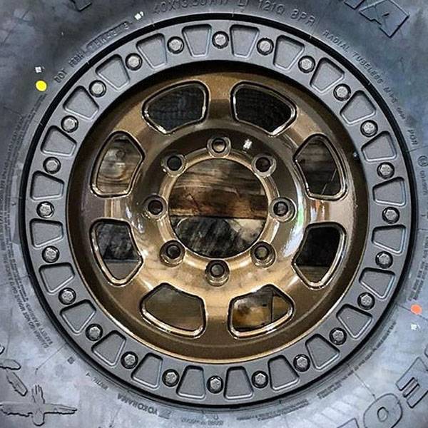

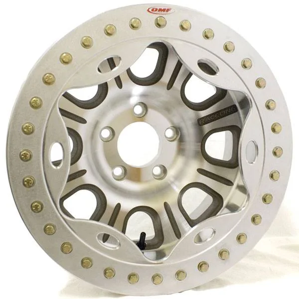

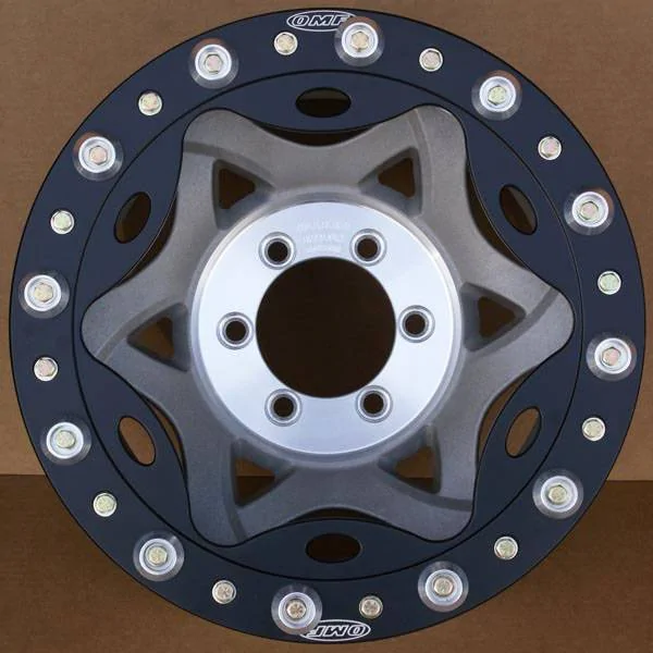

Thought I'd throw this out there to possibly help anyone else that may run into an issue like I have. I bought a set of Walker Evans beadlocks and mounted some 37" Mickey Thompson Baja MT's on them. The MT beads are really thick and after mounting I had some "coning" of the beadlock rings. Walker Evans does not make spacers for their beadlock wheels, so I was left trying to determine what other spacers might fit from other manufacturers. I ran across an old forum post on a JK forum and found OMF performance products https://www.omfperformance.com/index.php . They don't show them on their site but they have segmented beadlock spacers that will fit my wheels (and probably many others) and they can also do custom made spacers, just call them. A lot of the bigger brands already have spacers available for their wheels, but this is a good resource if you have some beadlocks and can't find spacers. They also custom make beadlock ring replacements https://www.omfperformance.com/prod...ent-beadlock-rings/replacement-beadlock-rings and it looks like they have a few different styles.
Jeep Wrangler JL Beadlock spacers and ring replacements omf-method-beadlock (1)
Jeep Wrangler JL Beadlock spacers and ring replacements omf-raceline-monster-beadlock (1)
Jeep Wrangler JL Beadlock spacers and ring replacements omf-walker-evans-beadlock (1)
Jeep Wrangler JL Beadlock spacers and ring replacements omf-trailready-beadlock (1)
