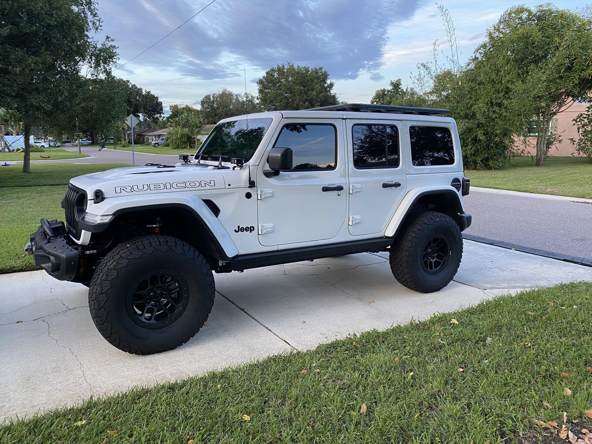

it would be beneficial to see a list of tires that have been used successfully with these wheels. I will start.
BF Goodrich KO2 35/12.50/17 load range E
