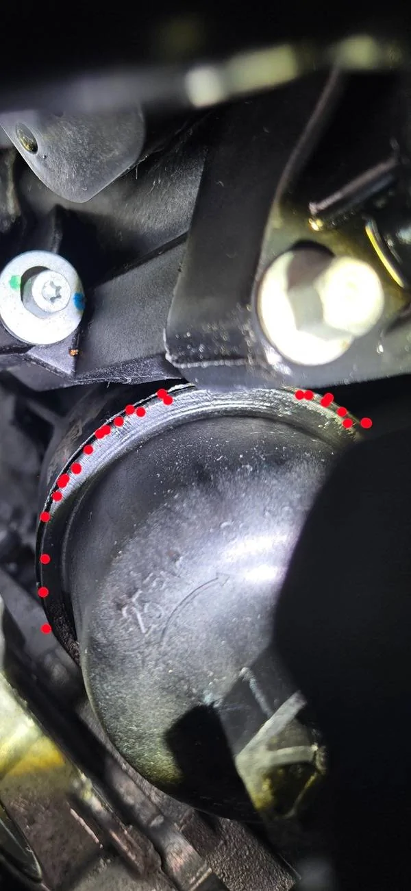

I clean that part with wet paper towel. But when I drive around and oil gets hot and Jeep sees 82 psi oil pressures, afterwards there is very tiny weeping from around the red dots, the location where the two thingies meet. And I clean it again with paper towel. It is very tiny amount of oil. Is this normal? Is it because of 17 foot pounds that I did, one less than the recommended 18 foot pounds.

Did you replace the o ring when changing the oil?
Is the housing cracked?
Was it torqued to spec?

If there is oil around there the cap might not be down all the way. This happened to me once. I thought I had tightened it but I hadn't. Got oil everywhere.

When I tighten the housing down, it almost comes to a stop. Then, just a light snug, done. So far so good. 👍

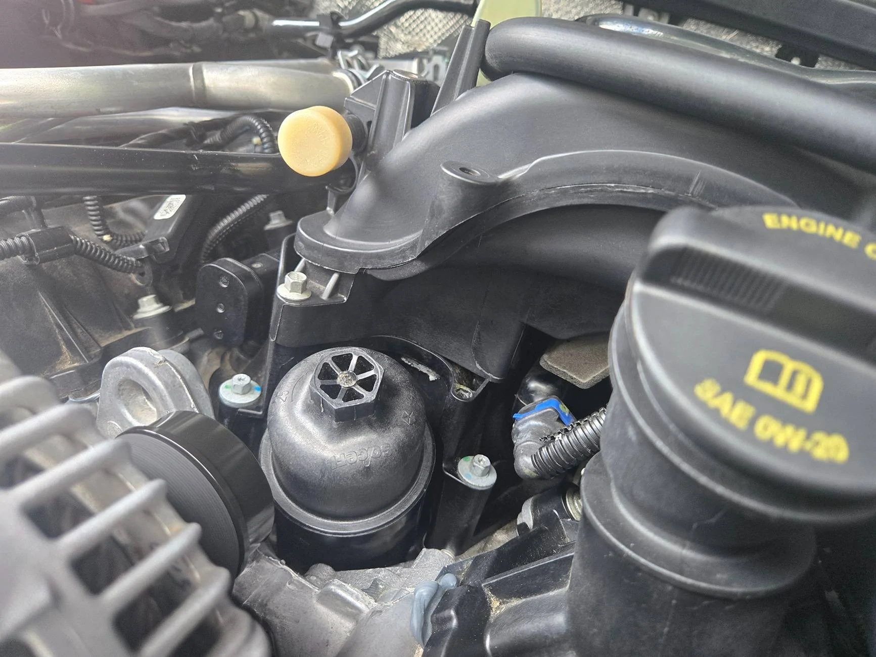

After a high rpm drive. Do you see some weeping there or it is just in my head? 🤔

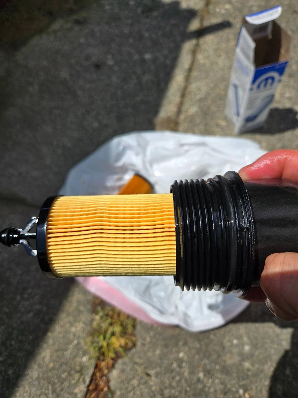

And why has that stupid plastic become like that? Chrysler must have made this plastic out of discarded shopping bags in India 😡

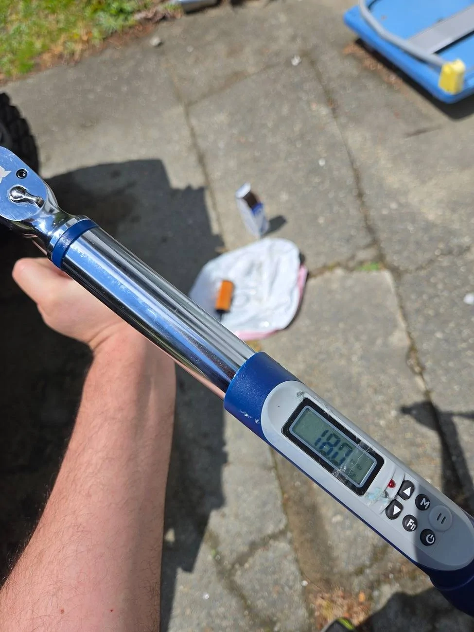

Guys that's 25.5 newton meters, it is more than 18 ft pounds. I am setting my wrench to 25 NM.
