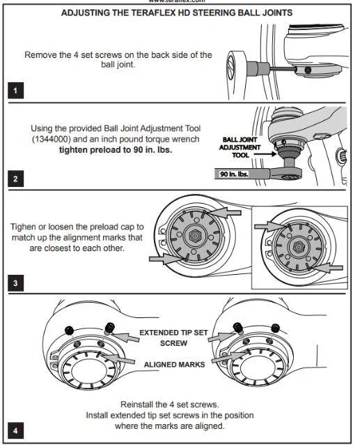

I put Teraflex ball joints on my JL back in Dec. I haven't had any problems with them and I like that they are easy to grease and can be adjusted for wear.
