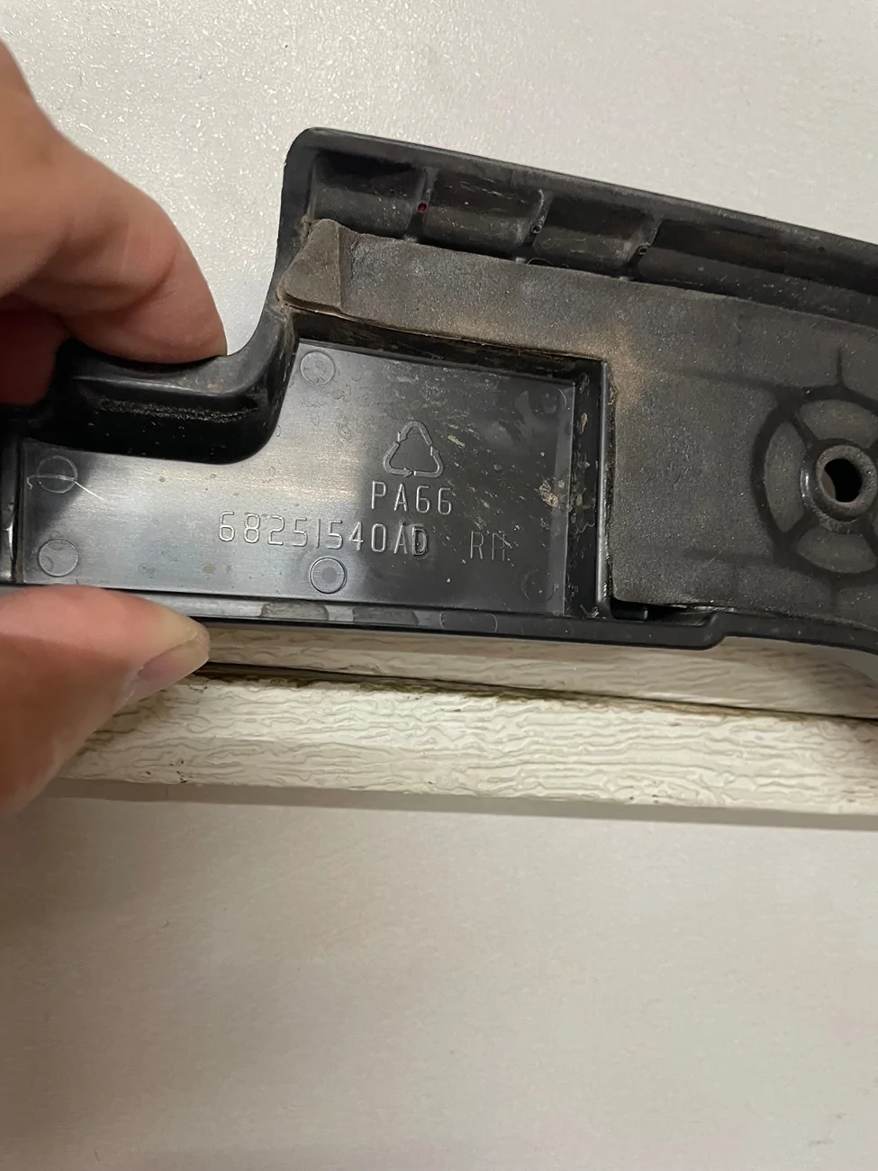

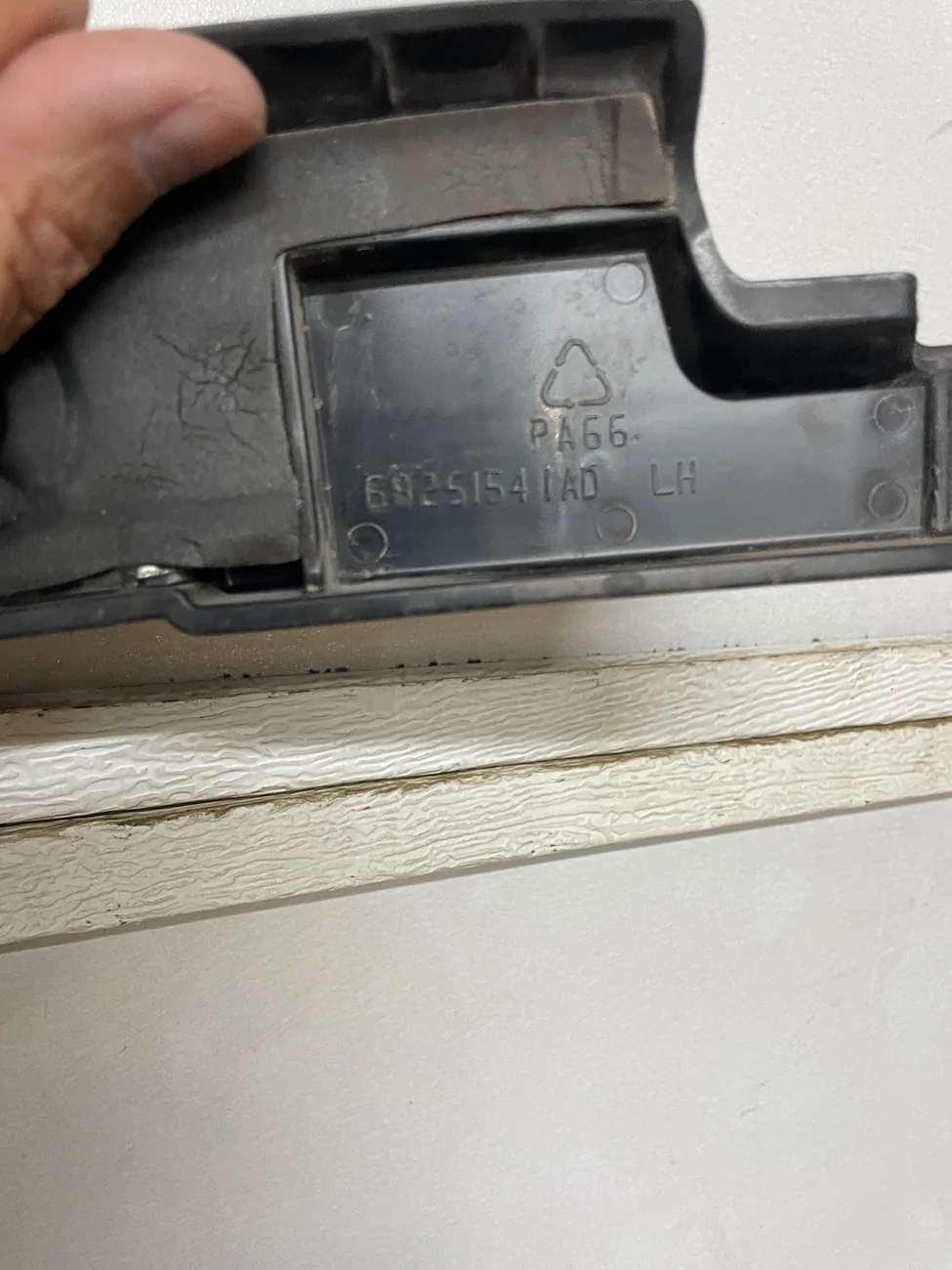

The corner brackets are part numbers
68251540AD RH
68251541AD LH
you need two bolts
6512230AA M8 x 1.25 x 28
Could not find a number for the tailgate bar.
Jeep Wrangler JL JLU own soft top replacement parts IMG_9411
Jeep Wrangler JL JLU own soft top replacement parts IMG_9412
