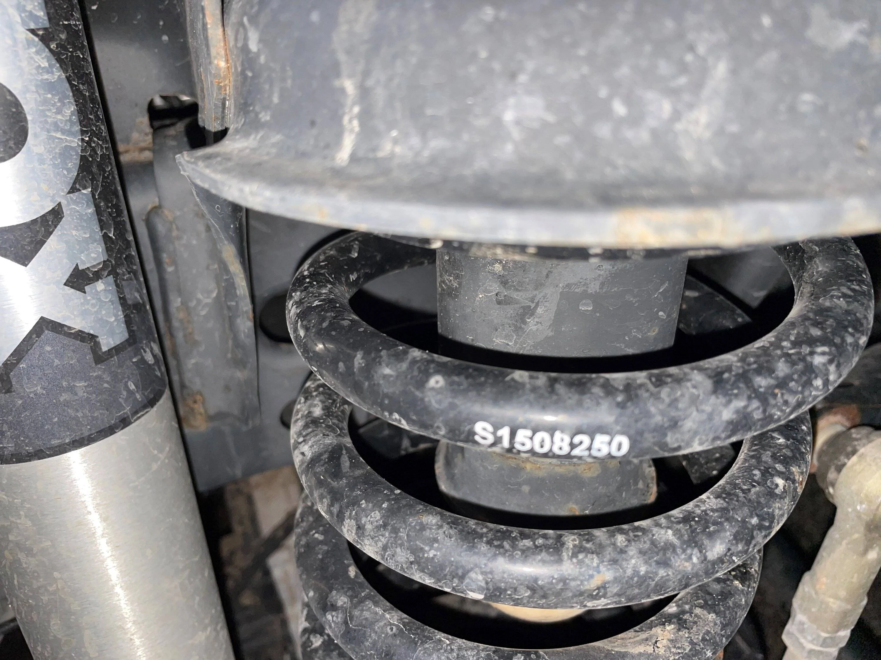

2020 JLUR. Bought it used with a (at most) 2" lift and 37's with a heavy offset (no clue on the actual number). It rubs into the fenders front and back on both sides at almost full flex. We enjoy moderate rock climbing and like the extra clearance on 37's so not going smaller.
Still trying to research what lift is on it but I think it might be the Mopar with Fox. Happy with the road feel of this setup. Cheaper options are body lift or small enough spacer to not screw with the driveshafts... Otherwise it'll be new fenders & liners all the way around.
Has anyone done a body lift? Pros & cons?
Also if you know what lift this may be, please chime in.

Looks like Clayton 2.5" springs. I'd try adding bumpstops before anything. It looks like it's only got the factory stops.

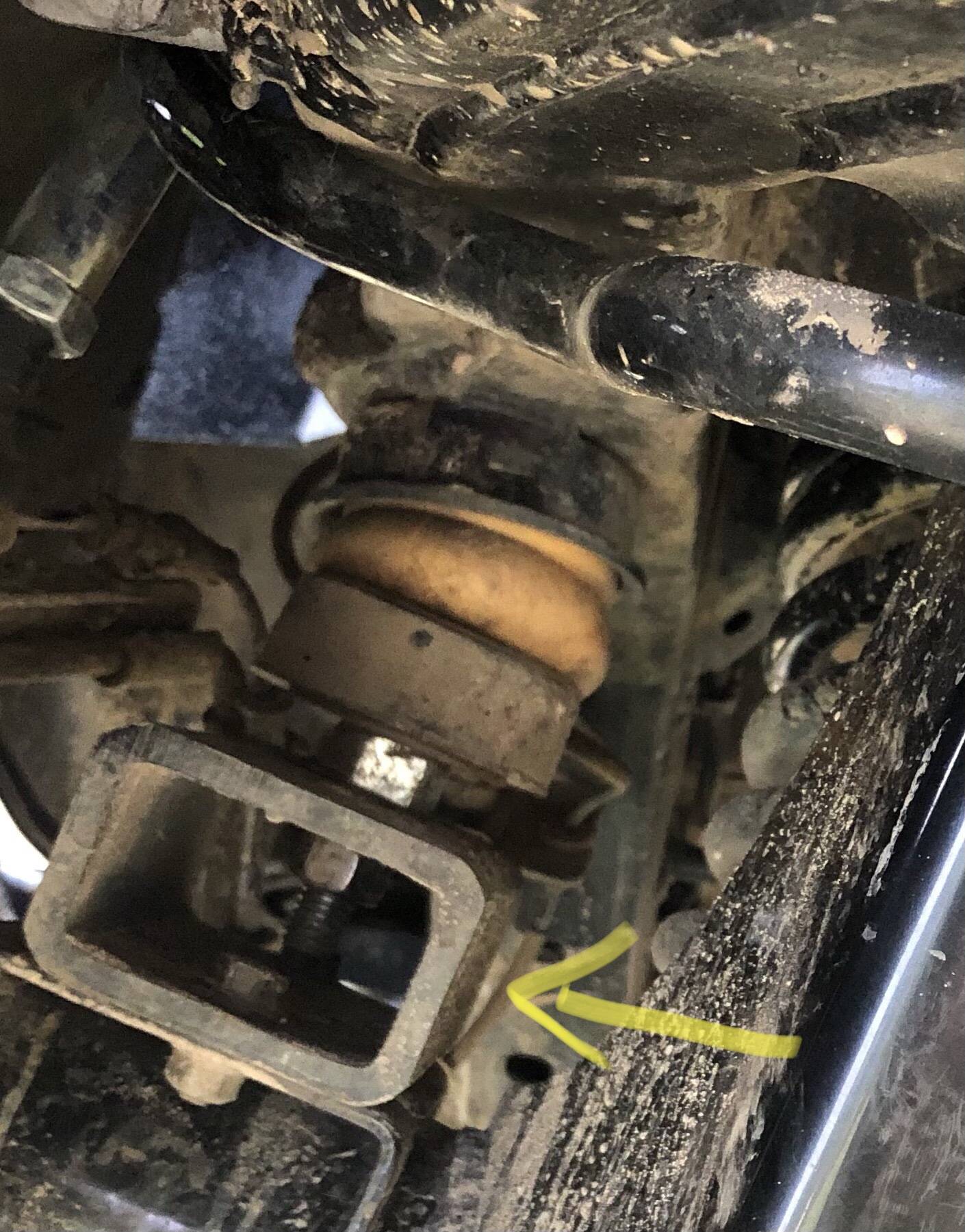

I personally wouldn’t do a body lift….. if you look at the rear bump stops if there is any, the Mopar lift bump looks like this, minus the puck, it’s just a 2” square tubing…

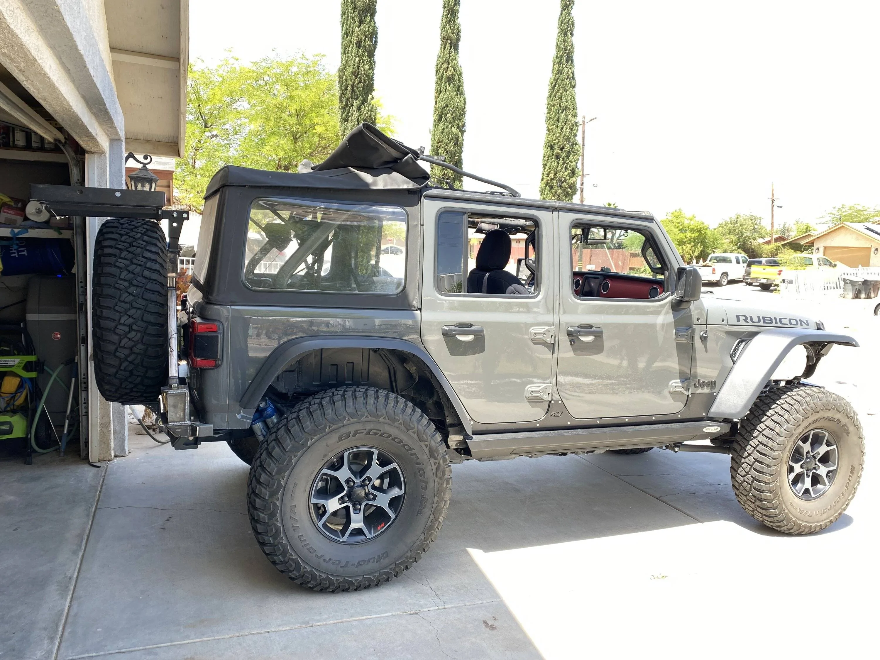

3” front, 2” rear, and 1.25” body lift here running 39” tires along with gutted inner fender liners. Very happy with my setup.
One thing to watch for for anybody doing it though is I had to make an extension for my power steering reservoir. If I hadn’t have taken it loose I might’ve cracked it while jacking up the body.

Ok. Figured out the lift is a 2” by measuring the springs vs a non lifted JLUR.
It also appears that when it was lifted, there were no bump stop extensions put on. Now to see what she wants done to “her” jeep
