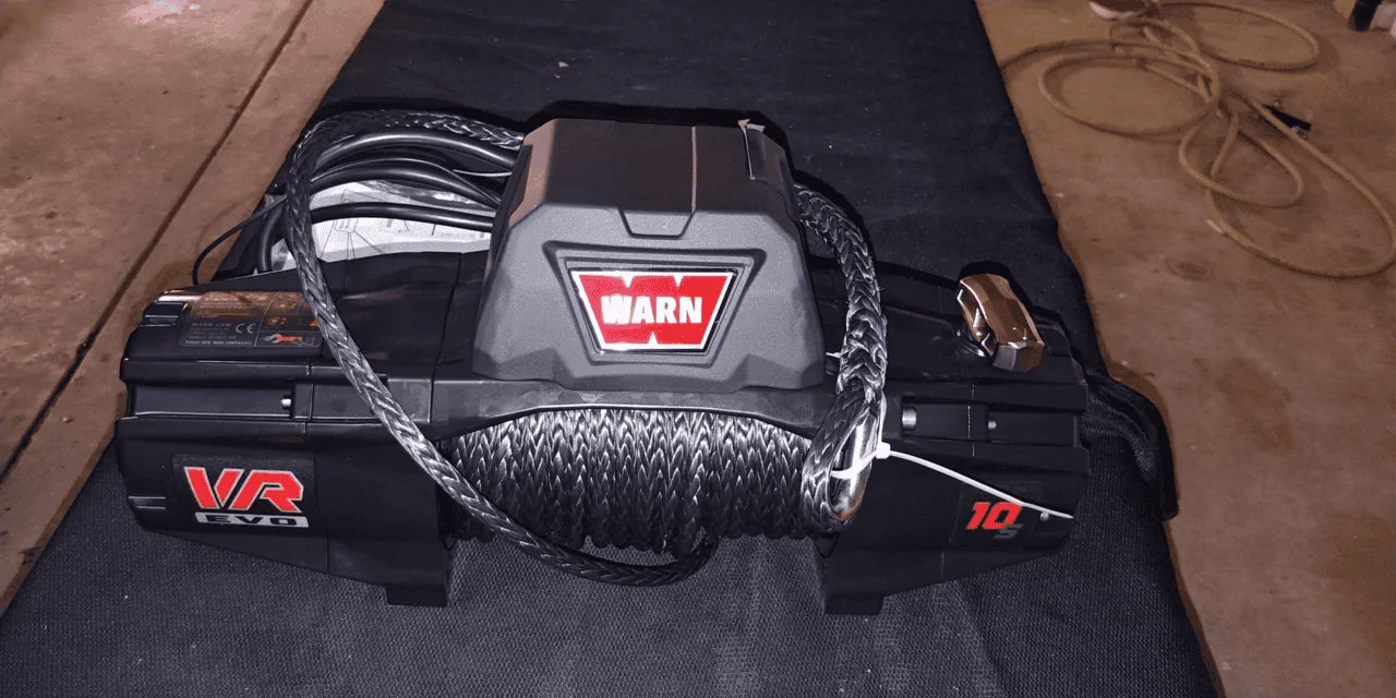

Warn's Evo is a great winch functionally, but why on Earth did Warn design it with the cables sticking out the side? I know appearance shouldn't matter in a winch, but that kept me from buying one. There is no way to hide that.
Easy fix though, split loom and electrical tape around the split loom could make that look like 1 robust cable which would look better. The VR Evos are a value orientated brand so warn has spent the money on winch components being quality over aesthetics eating up the cost to produce.
There are a few weird things Warn has done recently. I'm amazed that Warn did the Zeon Platinum series with no mechanical clutch or non-wireless option. I understand the niceness of having that cool remote, but if you're remote has power issues or connectivity issues your winch is useless. This was the only reason I didn't get their platinum zeon and went with standard zeon.
