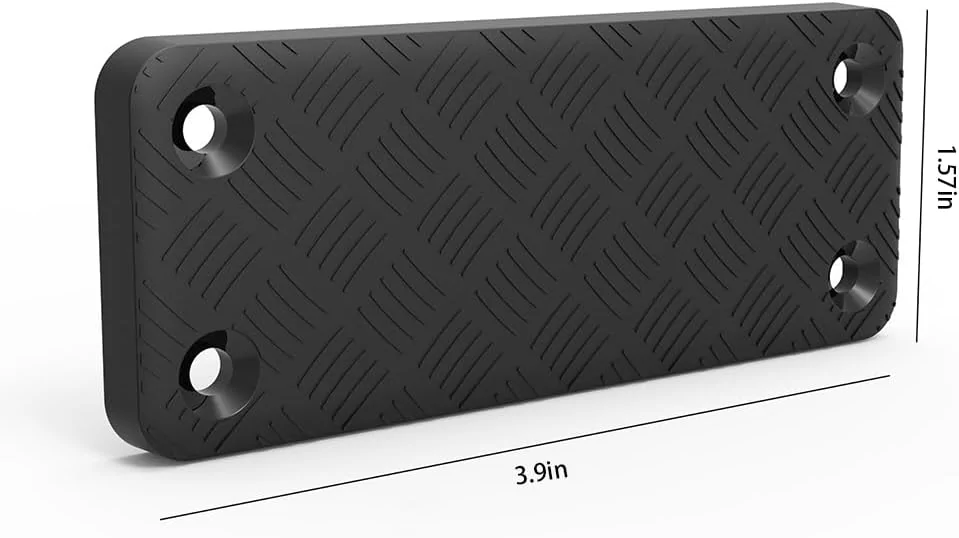

Regardless of whether you run with a stock oil drain plug or the forum favorite, a Fumoto Oil Drain Valve (Terrific) it is a very positive thing to add a magnet to the mix..
Consider buying a gun magnet with rubberized coating and attaching it to the bottom of the JL's oil pan. You remove the gun magnet just before you drain the oil pan and then after oil is drained re-attach the gun magnet.
Buy the gun magnet at Amazon. Here is one example..
Here:

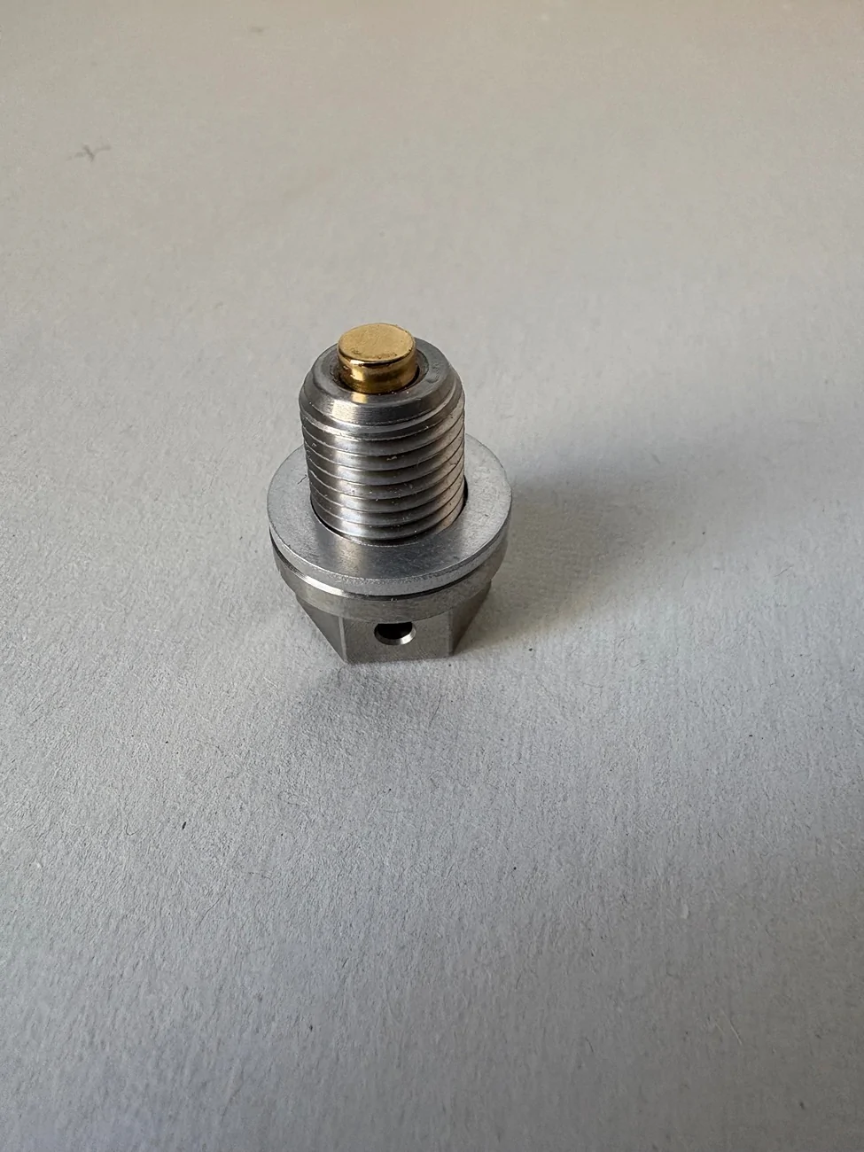

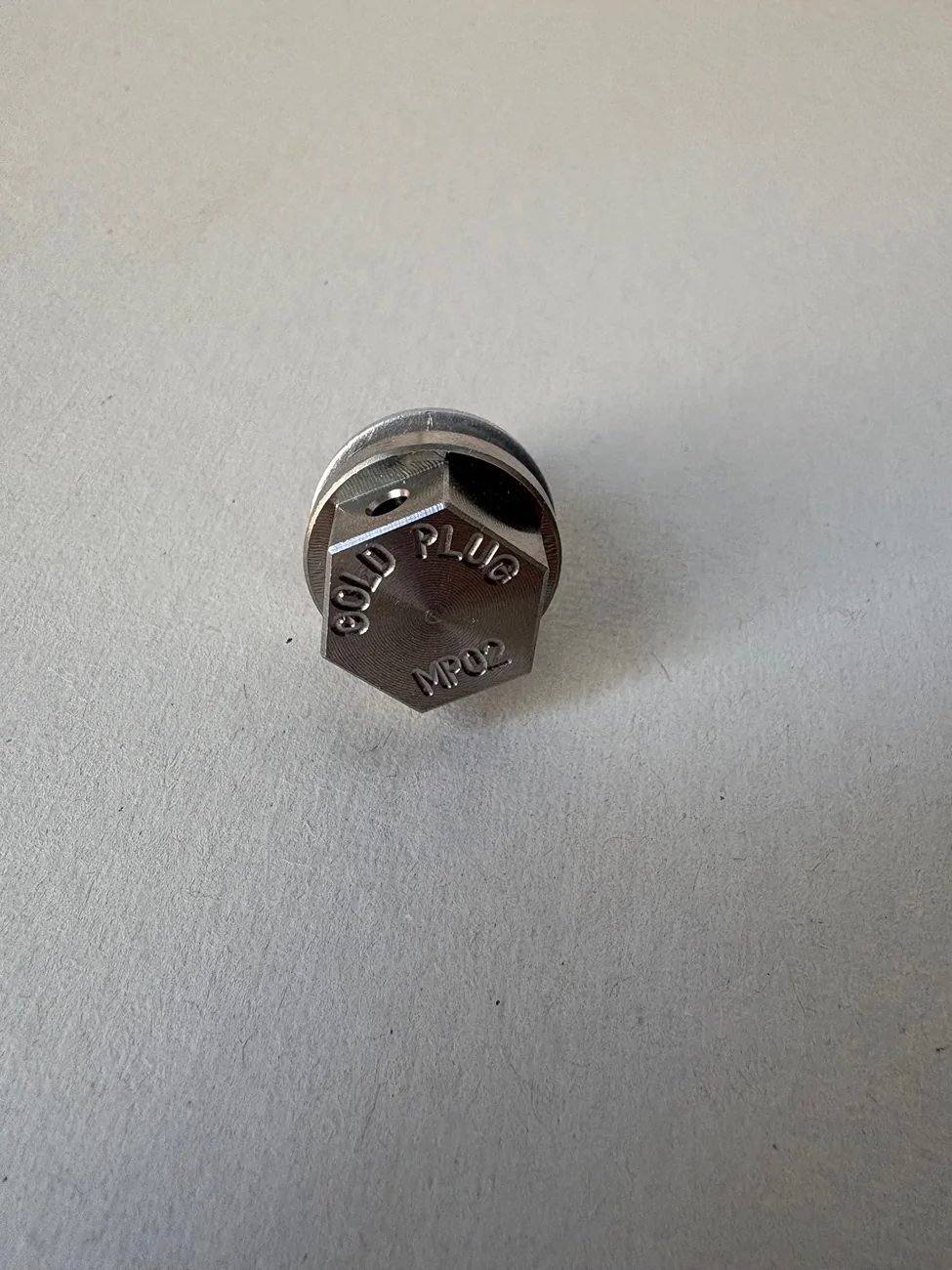

Note: For those that want to stick with an oil drain plug but want one that actually has a magnet on it... Well, The oil drain plug is a M14-1.5 . You can find a magnetic plug in that size most anywhere. Pick your brand... shop on eBAY, amazon, etc. It's the same size as the Wrangler JK uses..

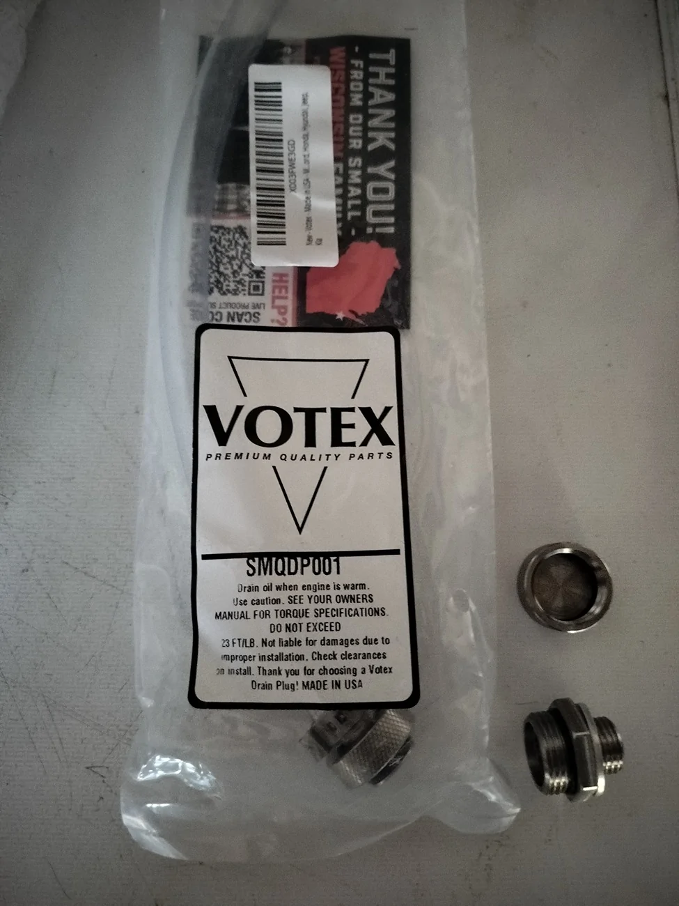

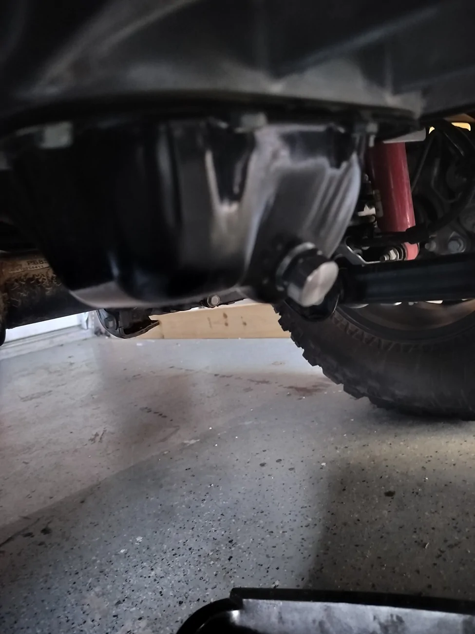

This is how it looks installed. Works great and I have not had any issues. Would recommend.
Jeep Wrangler JL This easy drain plug looks much safer 41d1501e-c224-458d-b386-82c3e9d88ef4-1_all_221
Jeep Wrangler JL This easy drain plug looks much safer 41d1501e-c224-458d-b386-82c3e9d88ef4-1_all_222
