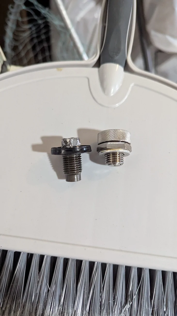

You see this guys, it is small and doesn't stick out, almost like the stock drain plug. What do you guys think? It is a good company too, their magnetic drain plug feels solid.
Except it does stick out, at an angle. I had one, and happened to land on a rock right on the extended portion of the plug, which bent the oil pan enough to cause a drip leak.
A new oil pan later, I'm sticking with the regular plug (and I've since added a skid plate).

In my opinion, it’s worth every penny if even just one time, I can avoid searching the bottom of a pan full of scalding hot oil for the drain plug.
And FWIW, “faster” isn’t even on the radar for me. It’s all about cleanliness. If you pull enough drain plugs, you’re going to drop one in the pan and/or spill/splash oil where you don’t want to.
Unless you store the plug with the tube perfectly straight (not curled at all), guess what happens? You have to stay there and hold the tube, otherwise it sends the oil well away from your drain pan.

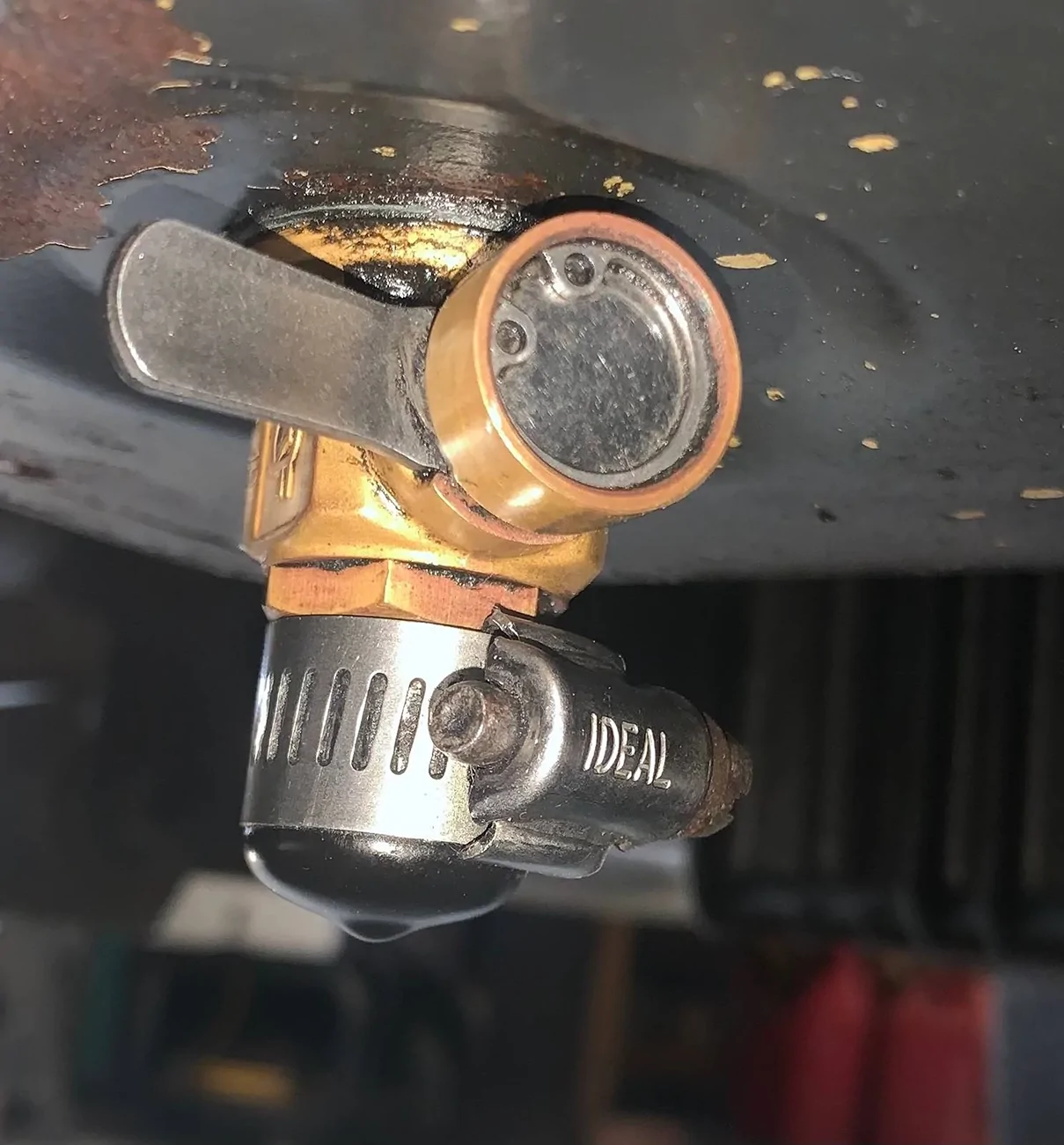

I use Fumoto drain valves on most of my vehicles. One of the things I like about them is they make obtaining consistent oil samples more reliable than other methods - at least as consistent as I can easily manage.
Obtaining reliable samples of any fluid, from mountain streams to the fluids in your vehicle, requires consistent, clean sampling techniques. I wouldn’t trust pulling a sample from the oil filter. I don’t want to run the chance of pouring contaminates captured by the filter into a sample possibly making the UOA more concentrated by contaminates. The same goes for shoving a suction tube down the dip stick tube to an unknown depth and location in the pan.
The method I use to obtain an oil sample using a Fumoto drain valve is as follows:
I purchased a Fumoto valve with a short nipple and capped it with a rubber hose plug to keep it clean. Just to make sure the cap doesn’t come off, I put a small hose clamp over the plug as pictured below.
Jeep Wrangler JL This easy drain plug looks much safer IMG_5822
When I draw the sample, the clamp and plug are removed exposing a fairly clean passage through the Fumoto valve. I open the valve and let the initial stream go to waste. This gives an opportunity for any sludge that may have collected around the valve opening inside the pan to be washed out. After the valve has been open for a few seconds, I close the valve and place the sample bottle under the valve, open the valve and capture the stream in the bottle. I then wipe the inside and outside of the Fumoto nipple with a lint-free rag and reattach the plug and hose clamp.
