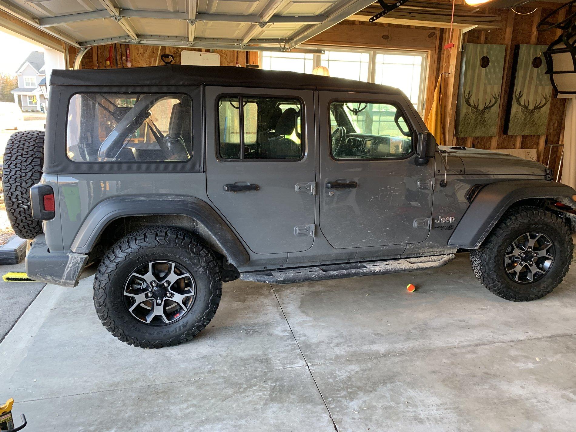

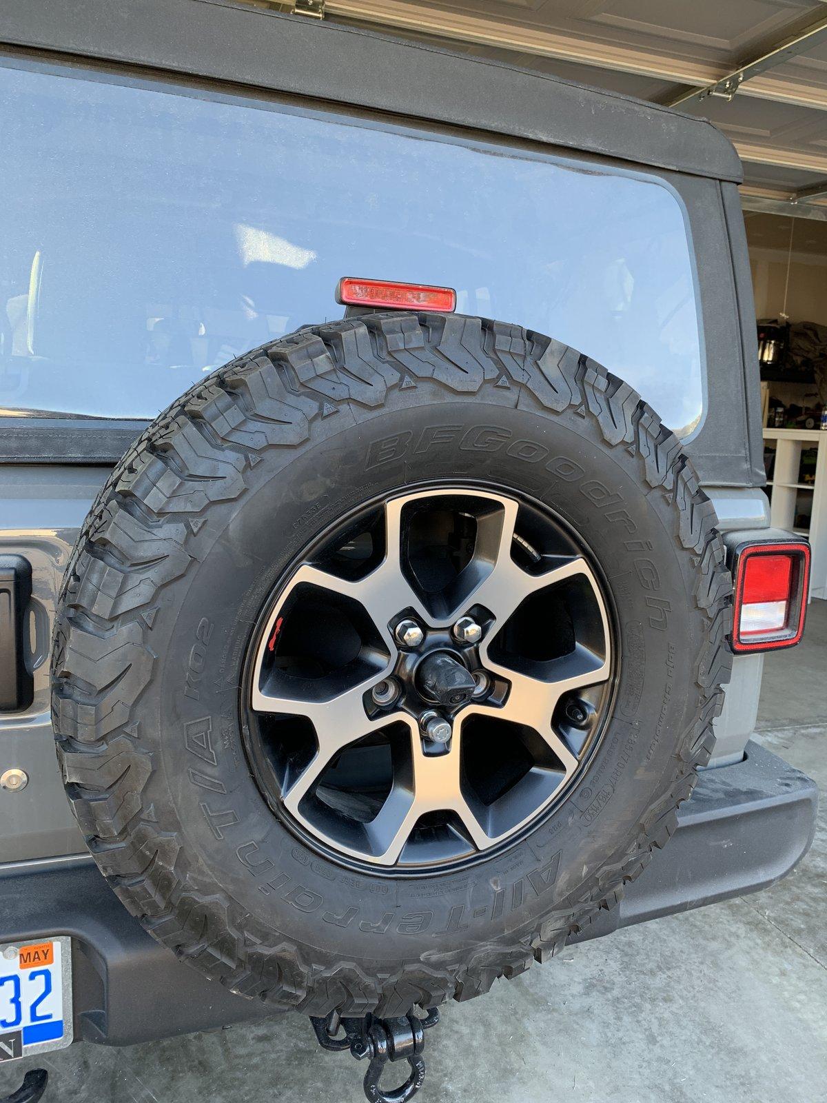

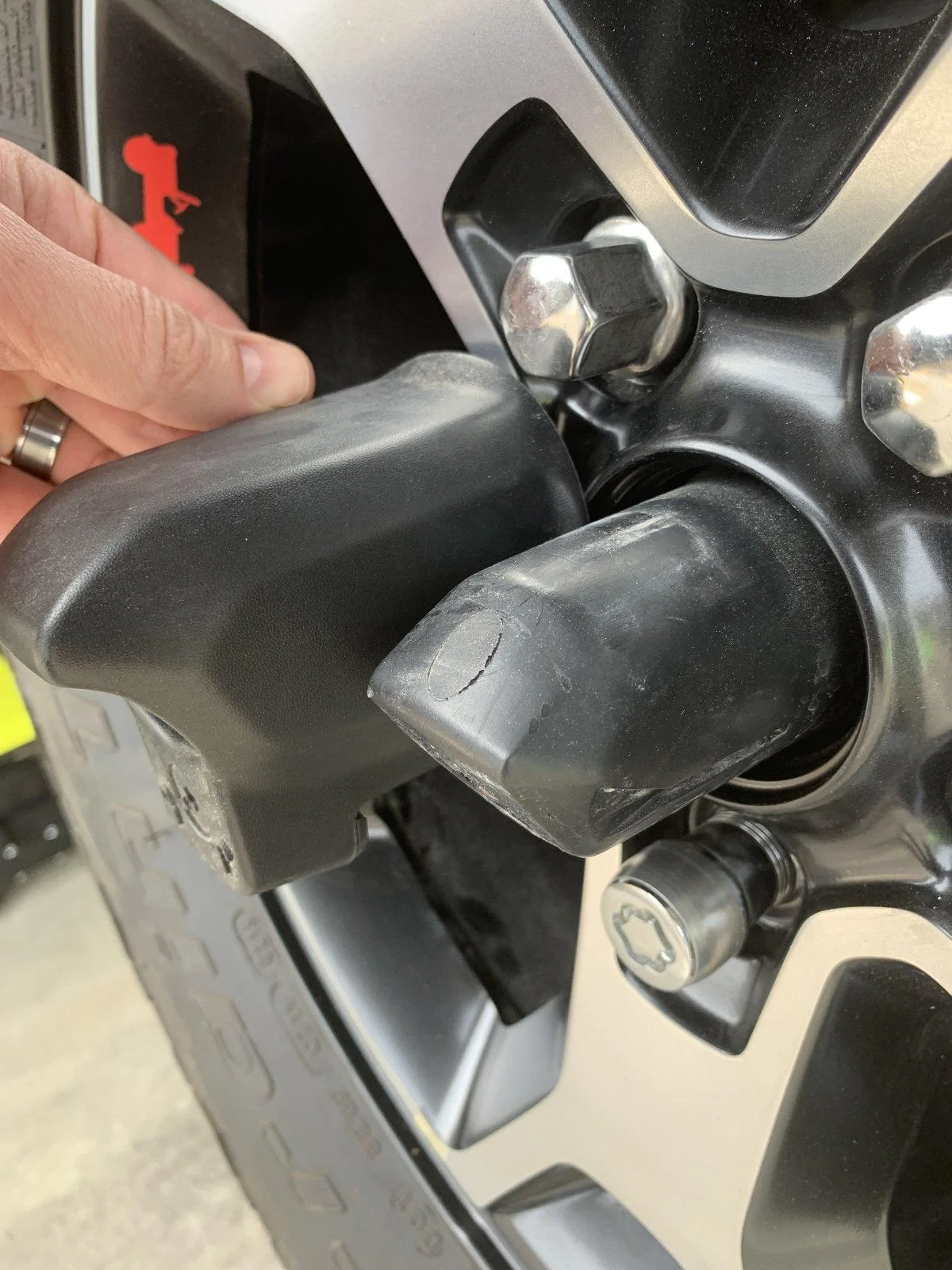

If it makes you feel any better mine doesn’t either I just have it laying in the cargo box..I couldn’t find any discussion on my issue so I figured I’d ask here. I added some Rubicon takeoffs to my Sport this weekend and very happy on how they look/fit but I did find that the rear camera cover on the spare doesn’t fit back on now.
Has anyone figured this combo out the the oem spare tire holder? The camera cover seemed basic in setup but worth reusing if possible. I don’t know if there would be any specific risk to the rear camera with the cover off from the elements...

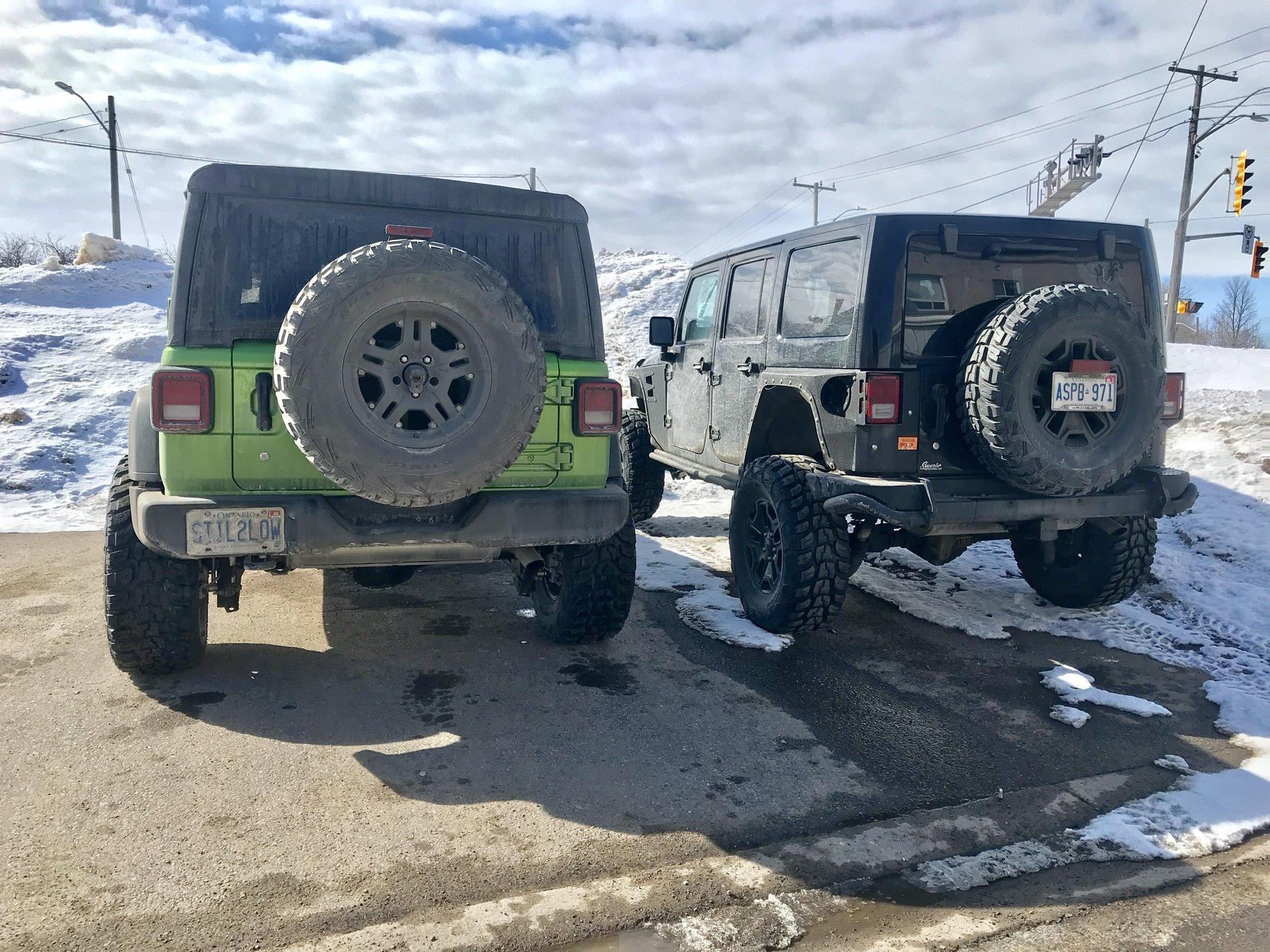

Strange it doesn’t fit, mine fits with an ATX wheel and it’s fairly thick hub on them

The cover is at least 1 inch out from the camera length with the Rubicon rim

Is it hitting you locking lug?

Perfect, thanks everyone for the confirmation. This is why I enjoy the Wrangler community so much - awesome to have this forum for help.I went to the same set up. I went from stock steelies to Rubi wheels. The back pad on the rubi wheels is much thicker because theyre aluminum wheels. The steel wheels can get away with a thin backpad. The sport camera cover is longer than the all the other wranglers camera cover for this reason. Only the base sports as sport s has alloy wheels. You can buy a non-sport camera cover or just go without it. I havent been running mine for a long time now. No issues. Eventually ill grab one if i remember and theyre cheap enough. not a big deal though.doesnt offer any real protection. Mines been rained on and covered in mud. No issues
