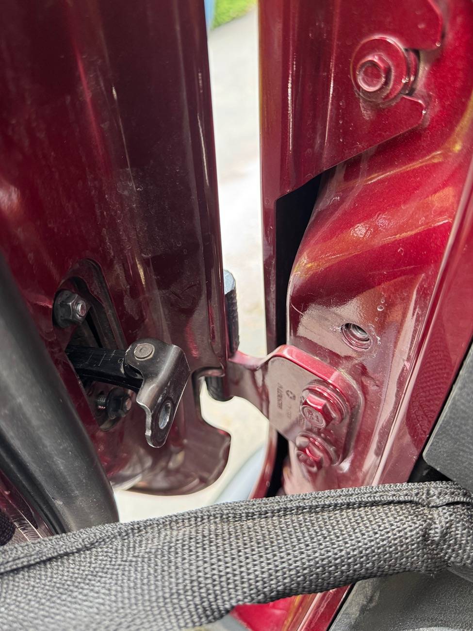

Okay might as well post here... when I took my doors off last weekend I accidentally forgot to remove the bolt that controls the swing detent and max opening and now it is crammed into its receptacle.
Any ideas on how to fix? I tried pulling it back out with as much for force I could give but it didn't get back over center and full length.

Can you close the door as much as possible and put a long punch/screwdriver through the detent hole and into the bolt hole then open the door?
Don’t know just a thought

Thanks for the suggestion and did already try that... but the angle is such that I can't get a screwdriver to line up with the two holes to pry it.
Seems I have to take off the interior door panel and maybe get a new one if I broke it. I have got to think others have made this bonehead move before.

Problem solved....
Seems potentially harsh on the threads but it worked. I've seen other threads that suggest knotting a piece of paracord through or around the door detente and using that to pull it out. Personally, I put a small clamp on the detente arm when I pull the door that (hopefully) will keep it from retracting back into the door.
