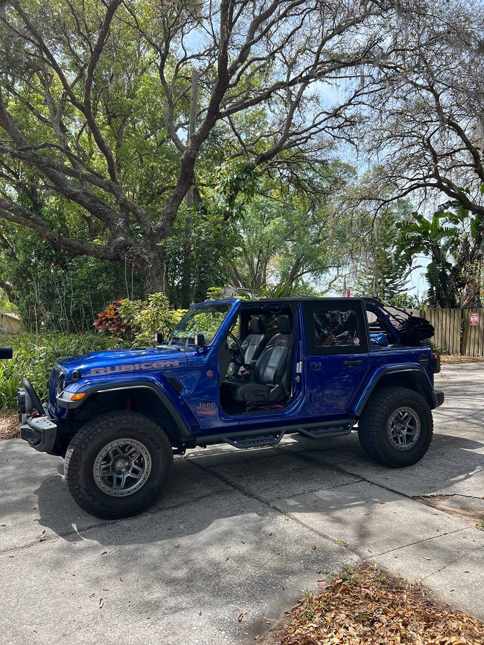

Nope... the JL/Us are now designed to automatically know that the doors are off once the door harness connectors are unattached.
ONLY flaw I have found is with having the half doors and when I ride no doors front & Half doors on in the rear (my autistic kids need the full half doors on when I drive with them) and I have to take my key fob and unlock the doors for them to open the rear doors as the jeep still automatically locks the doors once you start driving.
In this configuration:

i'd never thought about that configuration. i'm surprised that i actually like the way it looks as much as i do!
