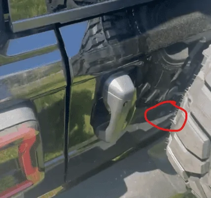

This hole is where the bump stop should be:
I will try that next! I still have them at home from when I took them off. Care if I post another video once those are in if the rattle persists?

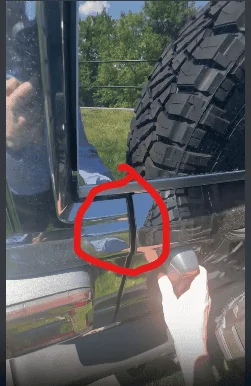

What's with this gap here? Unless that is an optical illusion, something isn't right with your tailgate. Also, in the video, it sounds to me like the rear glass above the spot I circled is rattling, not the tailgate.
