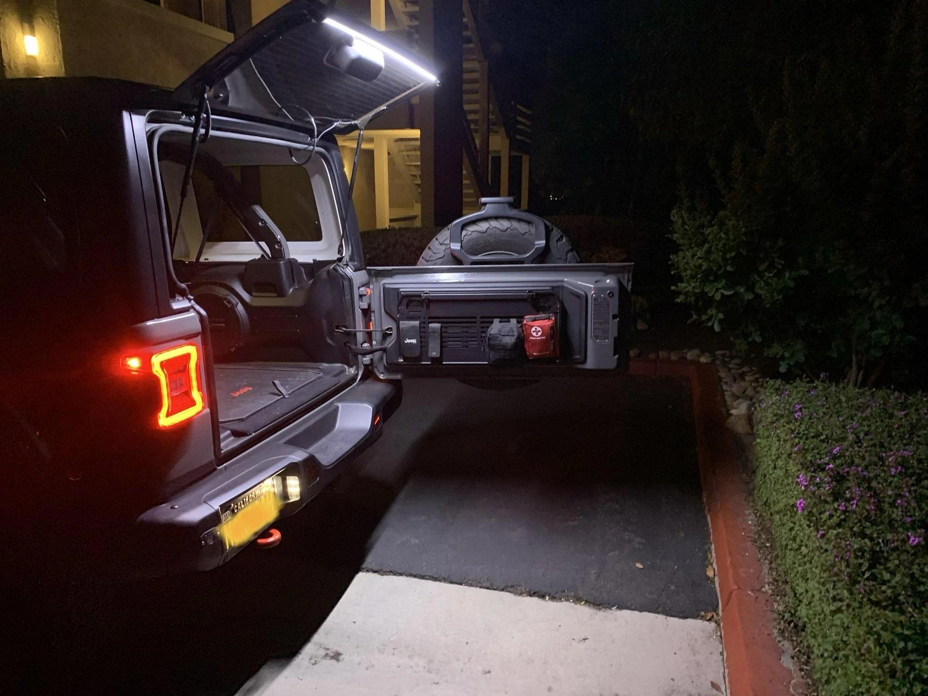

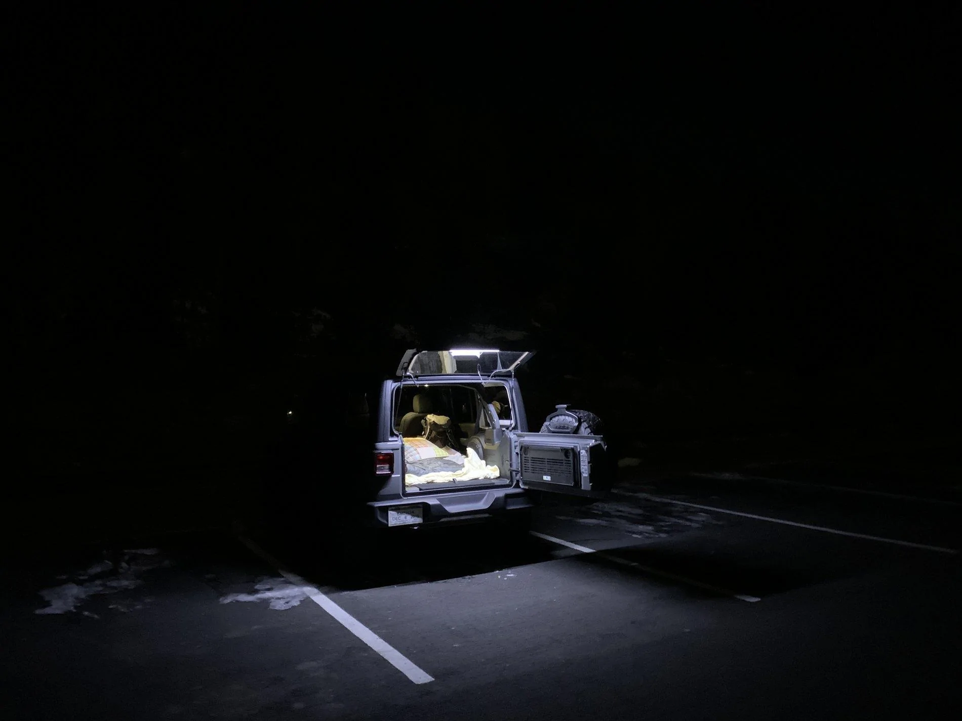

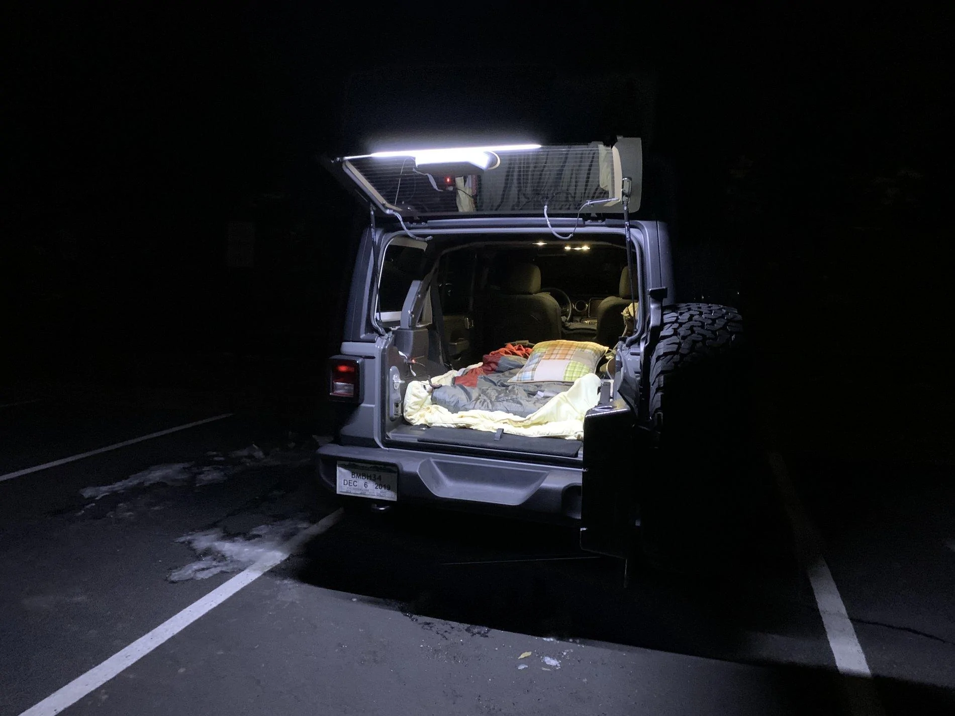

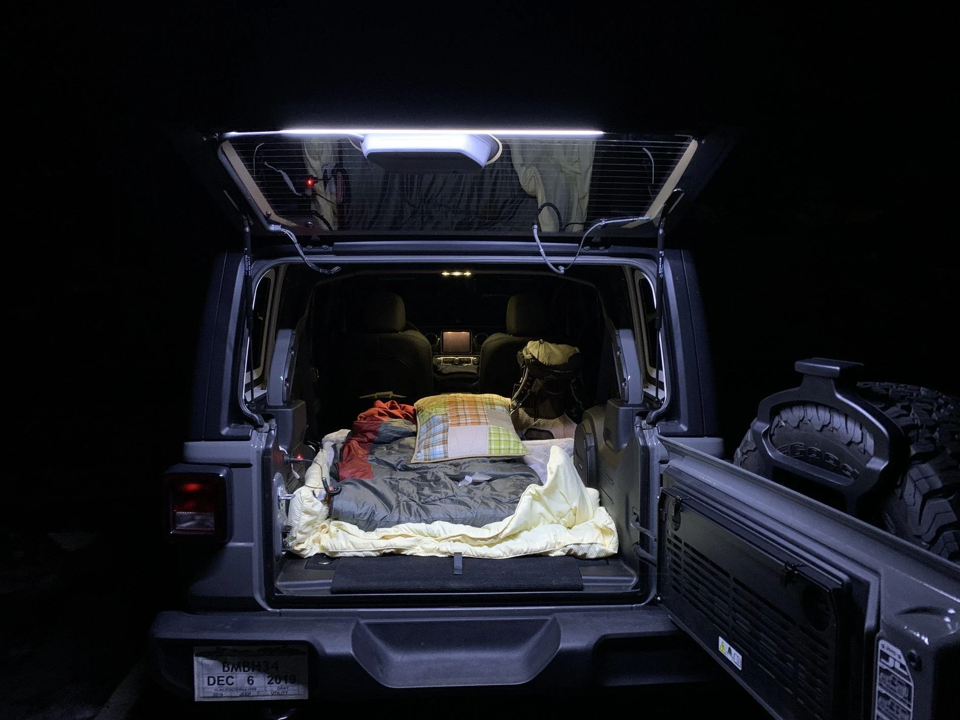

So I installed mine last week. Haven't hard wired it yet but plan on doing it this weekend. Need to figure out how to tap what wires for the 12v cigarette lighter. Also need to find a switch I want to use.
Here is mine in complete darkness out in RMNP this last weekend.

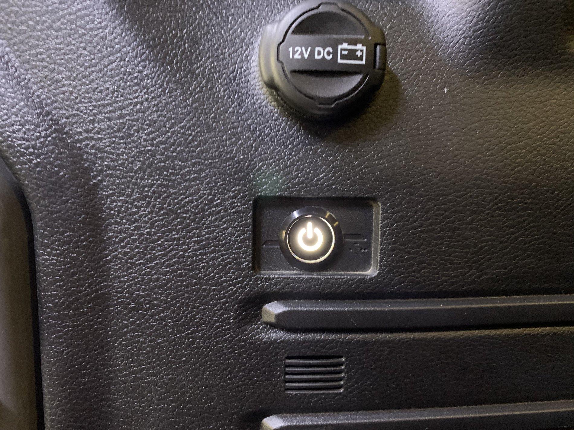

Awesome switch you have there! Where did you source it?
thanks. It’s this one
Quentacy 19mm 3/4" Latching Pushbutton Switch 12V Power Symbol LED 1NO1NC SPDT ON/OFF Black Metal Waterproof Toggle Switch with Wire Socket Plug (White) https://www.amazon.com/dp/B07RY6NKL2/ref=cm_sw_r_cp_api_i_StFPDbHPN5RAJ
the only thing is with the harness it’s a bit longer than I’d like on the back side so it causes the panel bulge just the slightest bit. Not really noticeable but if there’s a shorter version available it would be even easier to re attach the panel. If you search for Latching Button on amazon you’ll see a ton of options.

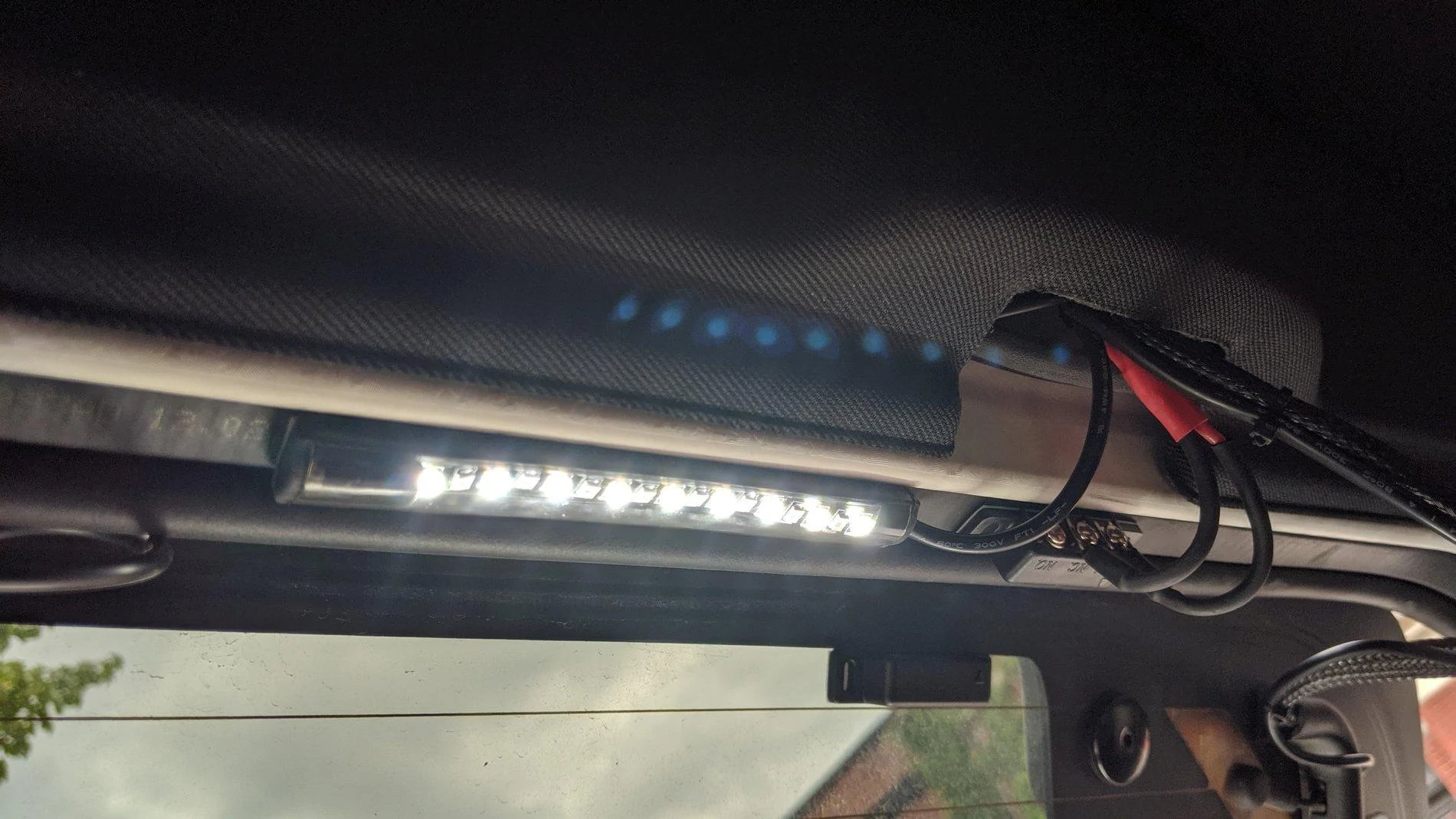

I installed my rear window LED light strip a couple of weeks ago, but I finally rewired it to turn on when the glass is opened. I used a magnetic relay switch that can handle a small load and tapped power from the unused 1-touch sliding roof (pins 13 and 14 on the back connector).

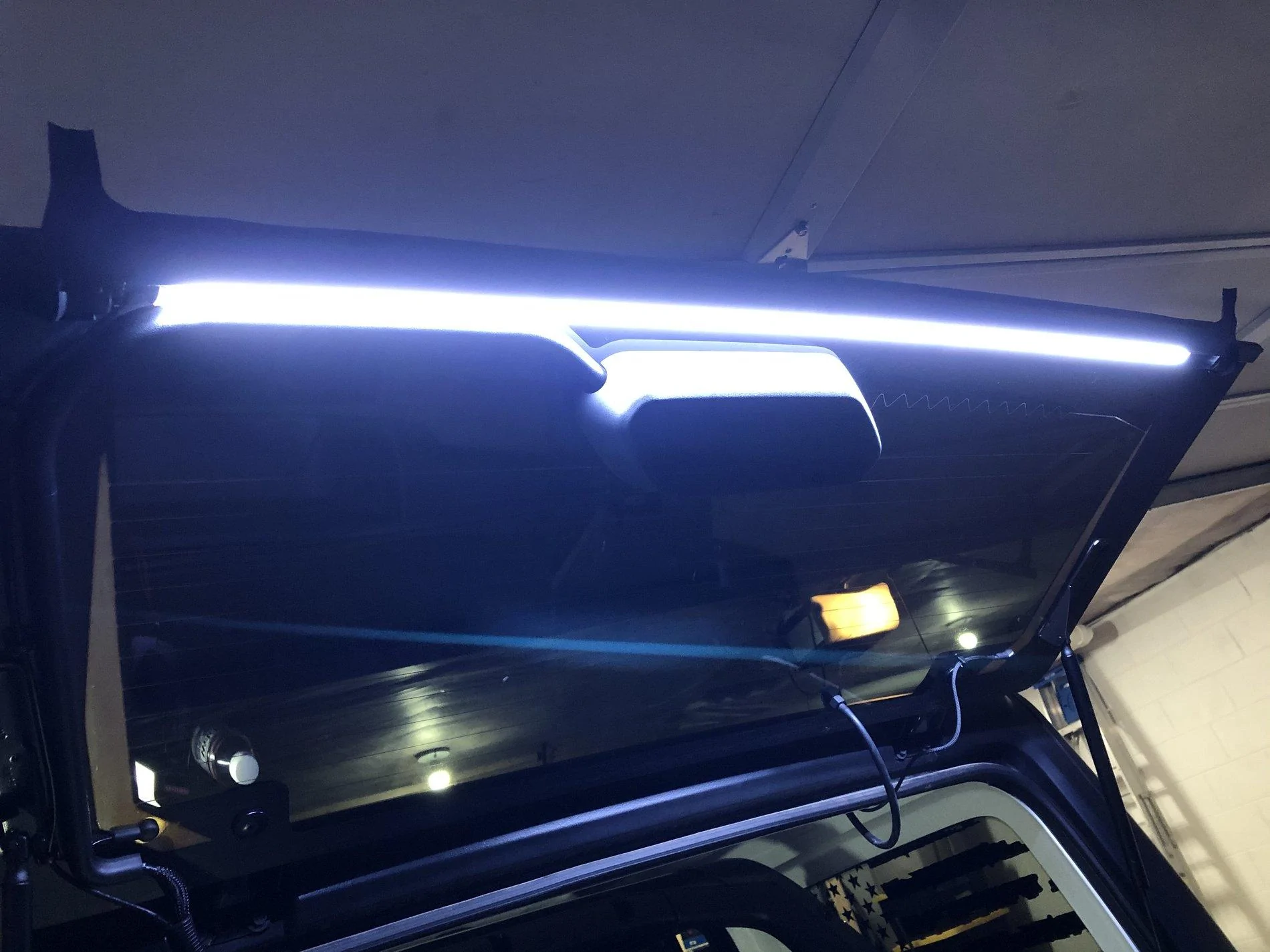

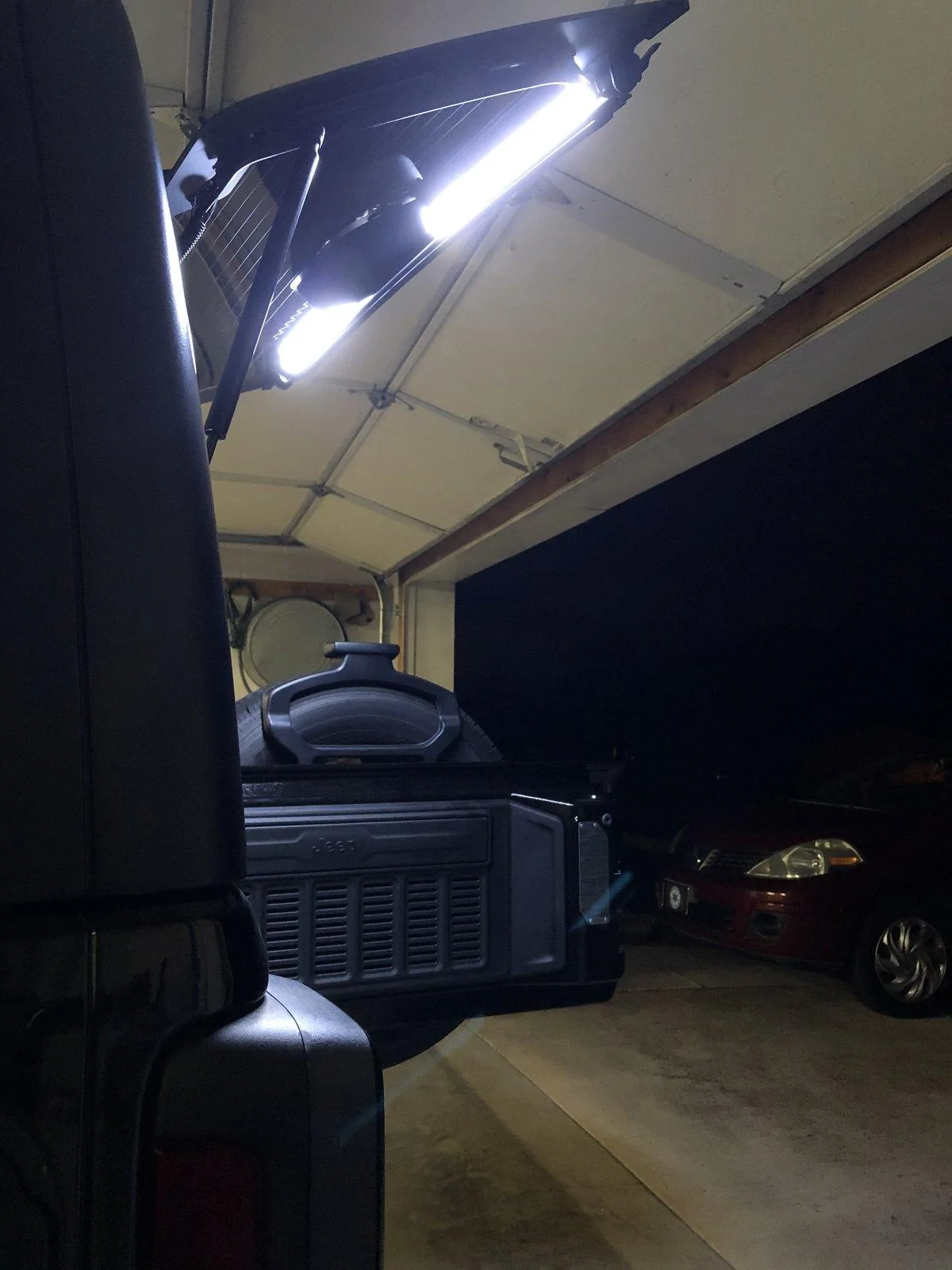

Got mine wired up tonight with a push button switch. I put the button up out of the cargo area to keep it from getting bumped constantly... I need a new soldering iron, mine is too big for small connections...
wiring from the light down through the channel was the easy part, wiring the switch took me forever because of the small amount of room I had to work.
Brawlee Light Link: https://www.amazon.com/gp/product/B07KNM7Y2M/ref=ppx_yo_dt_b_asin_title_o05_s00?ie=UTF8&psc=1
Switch Link: https://www.amazon.com/gp/product/B01KA4FLHW/ref=ppx_yo_dt_b_asin_title_o06_s00?ie=UTF8&psc=1
