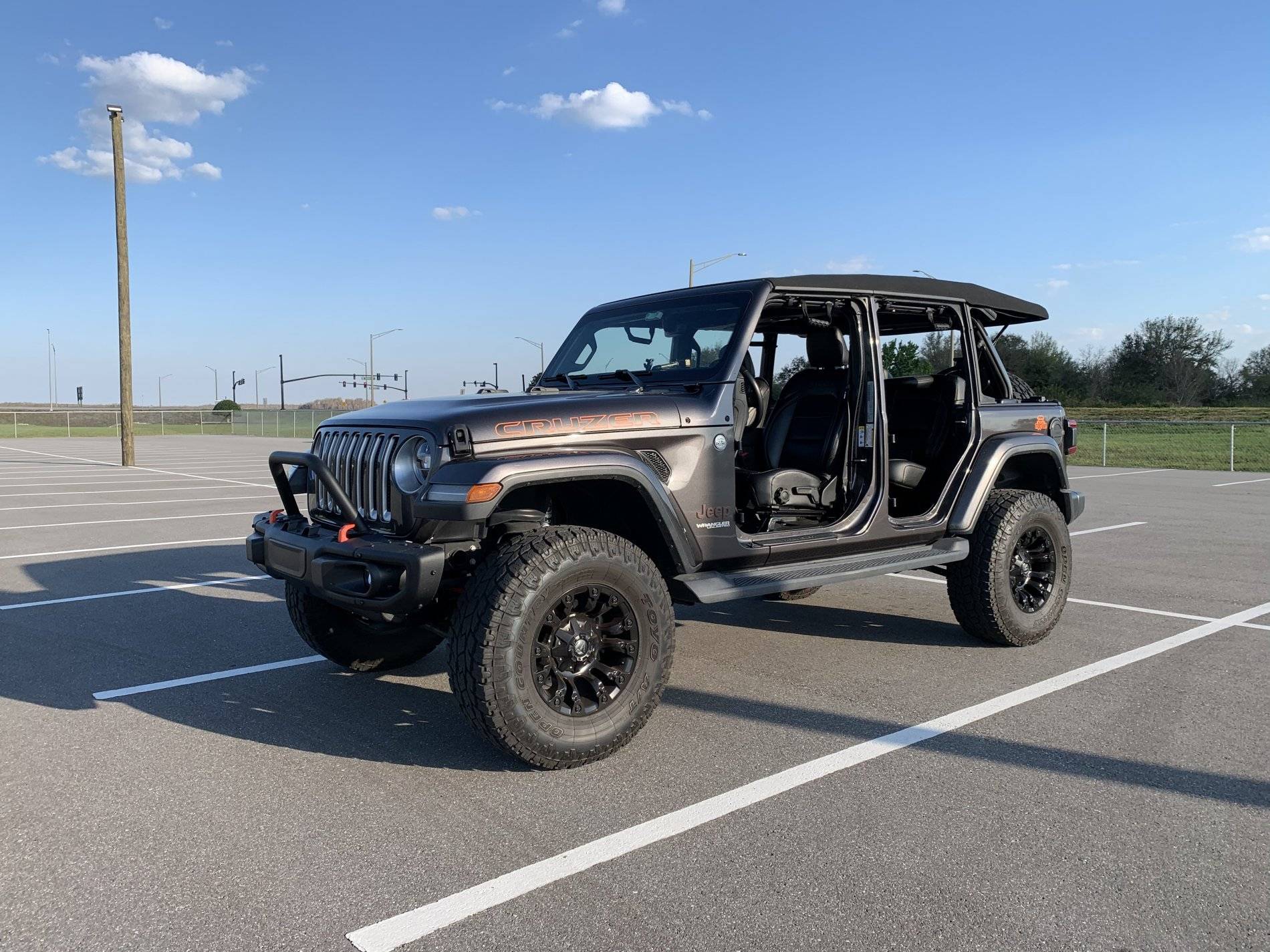

I recently purchased the Synergy front lower control arms for my JLU. My rig has the 2” Mopar lift, 35 OC AT tires, adjustable trackbar(yeti XD).
I need guidance on how to measure the FLCA to the proper length. I understand how to install them but not sure how to measure to get the most of these adjustable FLCA.
Can some one assist/guide me? Thanks!
