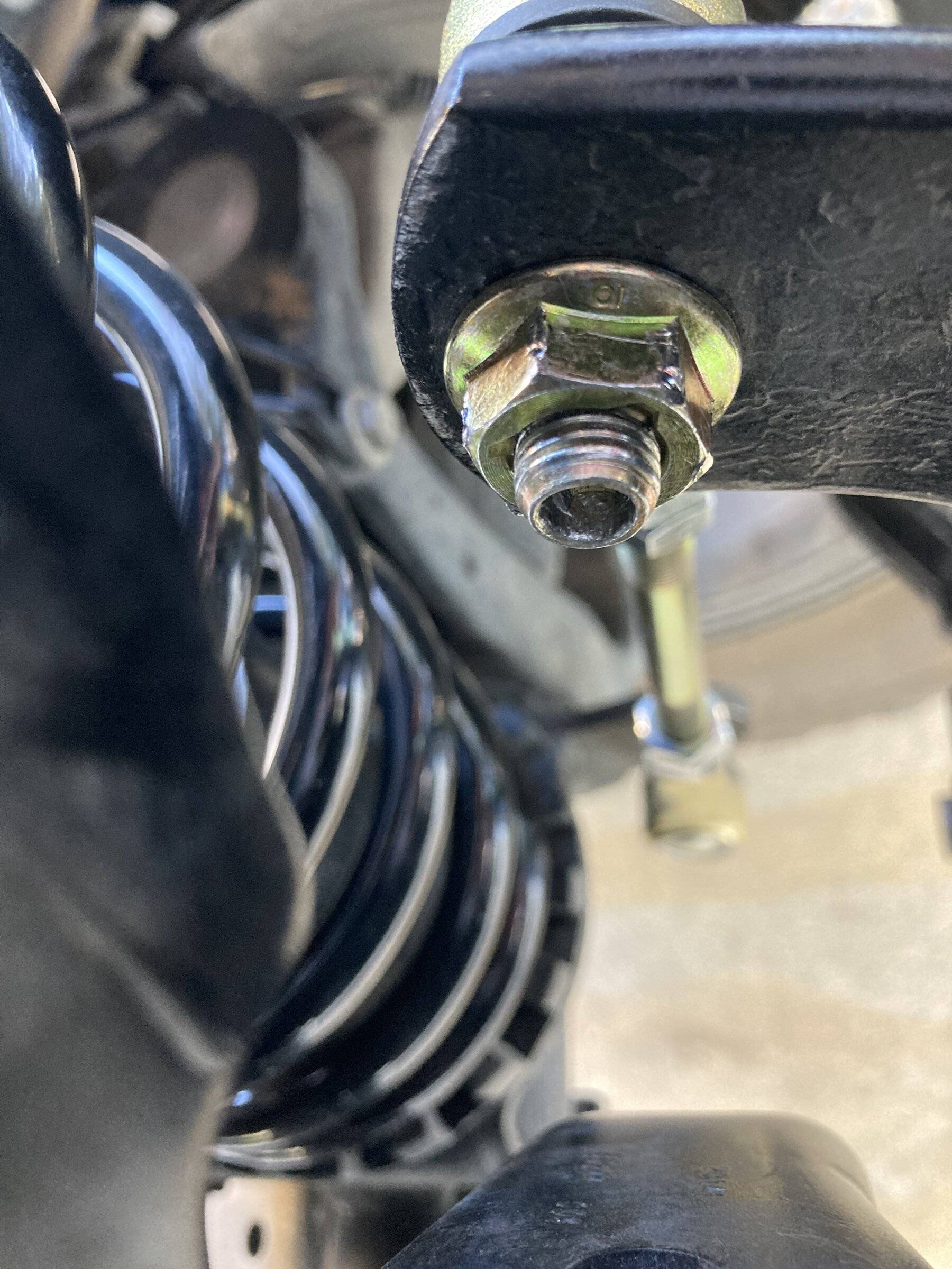

I’m not sure if the stock nuts are deformed to hold, or the wrong thread, but if you reused them, if may be worth getting a new set of nuts.
When I put the mopar links on, I could not get them to fully seat and I broke out an impact to drive the hex. A set of the correct flange nuts from lowes spun right on.
Using what came in the kit from Clayton. Possibly the shop cross threaded them and I was actually never getting it any tighter and was just stripping out the allen slot on the inside of the nut.

I had to use a pass through wrench with the Allen wrench inside of it

It just keeps spinning if I don't try to use the 6mm.
I wonder if it’s not some kind of deformed thread lock nut. Look at the notches by the threads on the nut.

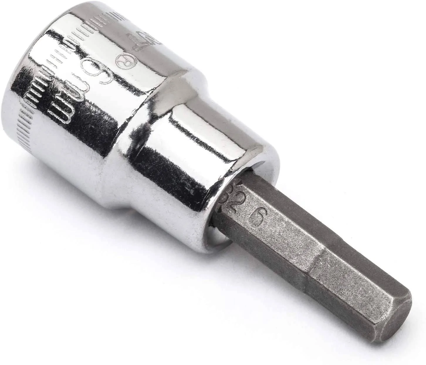

I had this annoying knocking sound a few days after installing the 1.5” Clayton lift and found out it was the rear passenger sway bar endlink not being fully tightened. I used an Allen wrench the first time and thought I had it tight as hell, but I was at my friend’s garage and didn’t have anything else. Today I tightened all 4 bolts with an 18mm wrench and a socket wrench with this bad boy:
Jeep Wrangler JL Sway link help 1649040850963
This made the process 10x easier, so it’s definitely worth the few $$ it costs. For the front sway bar I kept the JKS quick disconnects and they are solid!
I'll definitely pick one up next time I'm at the Auto parts store.
I noticed the one I was trying to tighten was a little stripped out so I just clamped the other side of it and used a socket on the nut and I was able to get it tight, I don't think I can do it any other was as I'm fairly certain the inside part is to stripped to tighten =/
