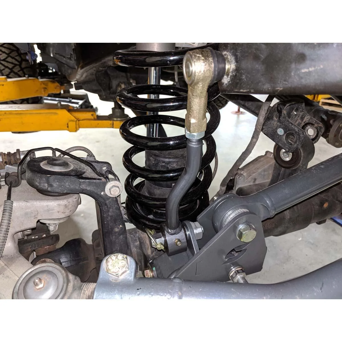

8855-01 is our front track bar relocation bracket on the axle side in our installed pictures. It also relocates the sway bar link up so you can use the quick disconnects. It is not released yet but will be very soon with our 3" Stage 3 Suspension System.

Do you have a picture with the Fox 2.5 with DSC mounted up? The resi and hose aren't mounted here and I'm trying to see how that works with the swaybar mounting spot. Does the disconnect interfere with the resi hose?
The resi hose just goes in front of the disconnect bracket on the frame side. Unfortunately, I don't have any pictures right now.

Has anyone installed front synergy quick disco sway bar links? Any feedback?
I did them last weekend. All super simple except for the passenger side sway bar relocation bracket. I think the factory weld was off by an 1/8 of an inch and really had to hammer on it to get into place. They are easy to disconnect and the ride fees much better without sway bar links that are to short.
