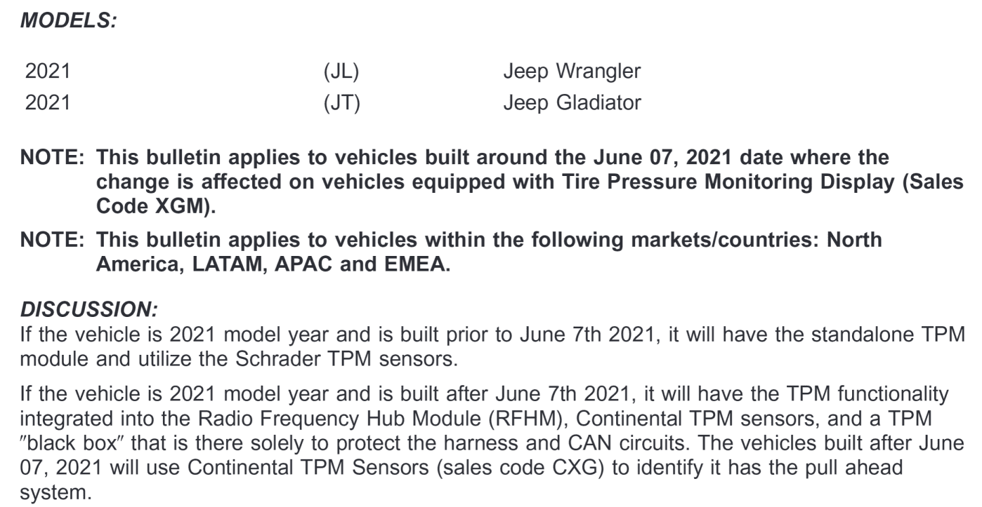

Keep in mind that there were sensor changes in mid-21 model year so someone buying your take-offs for an early 21 or before won't be able to use those sensors from a 22.

Build date is the only thing I've seen so far. Even the build sheet gives no details at all.
Look for MDH on the sticker, that will be Month, Day, Hour
MDH: 062209 is June 22nd 9am

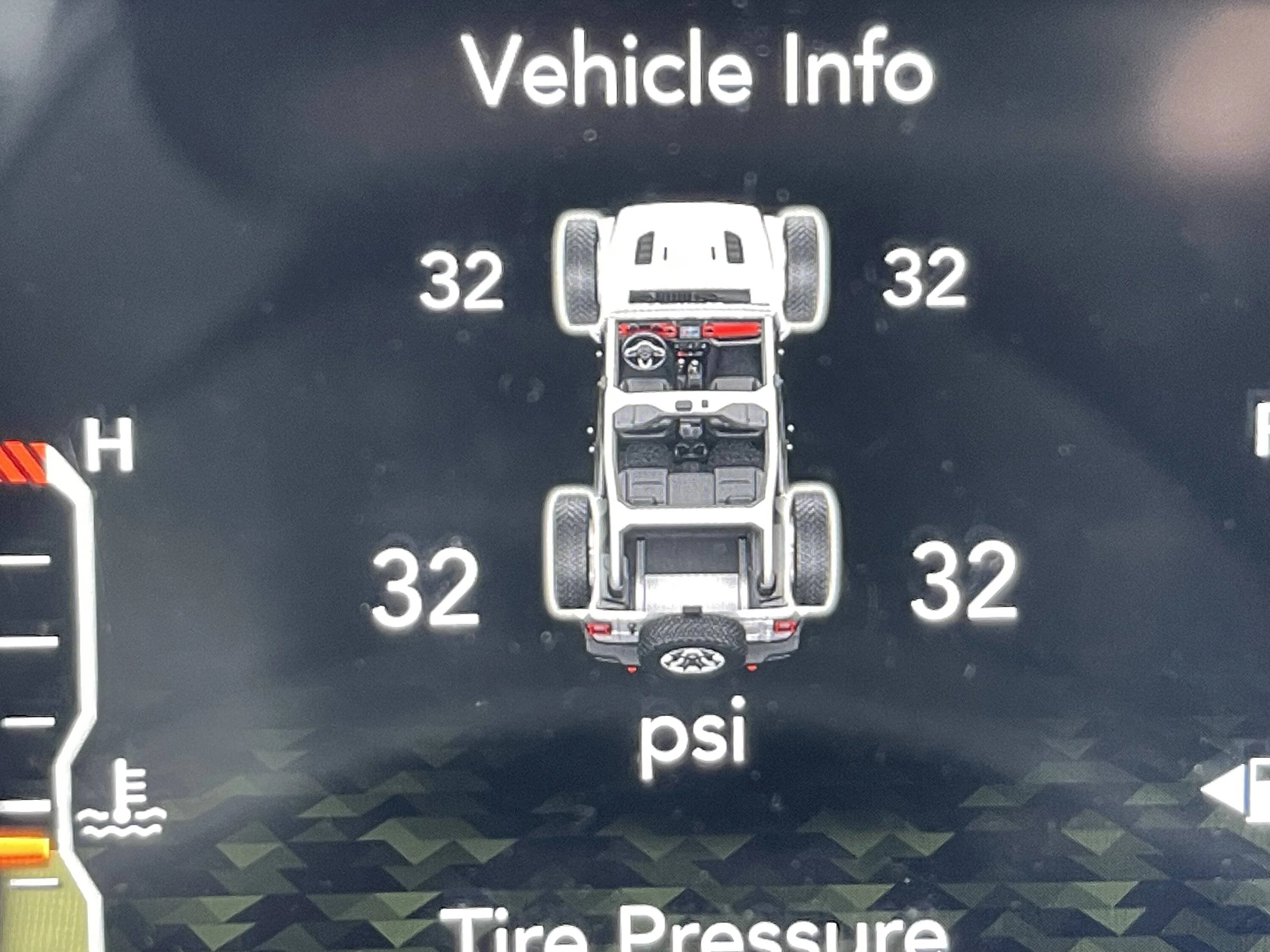

You will have the 5 TPMS's installed in your wheels. Set tire pressure on all to exactly what the driver's side door placard recommends in regard to tire pressure. Now, go for a short drive and your JL will automatically, again automatically, will recognize the TPMS's.

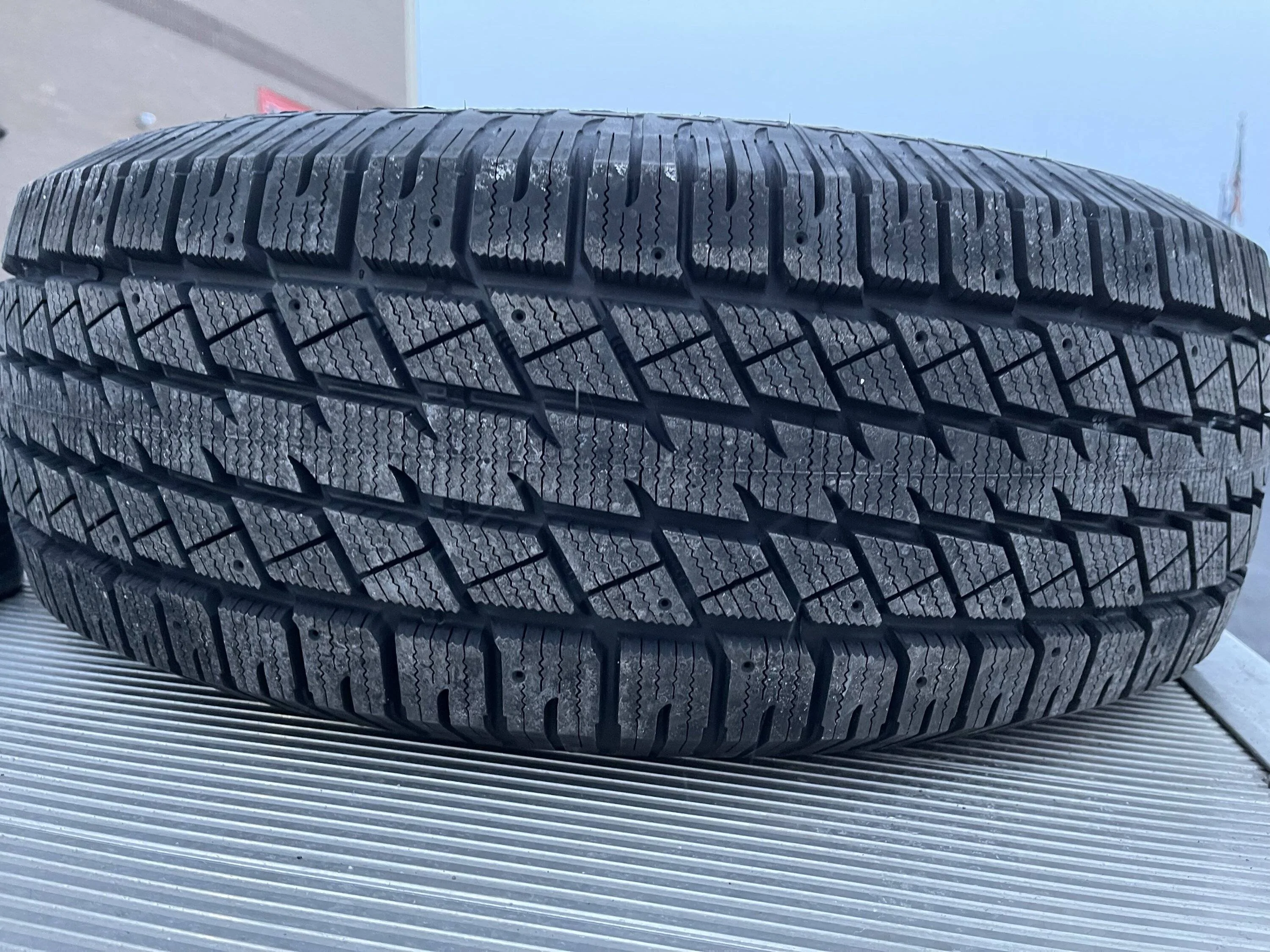

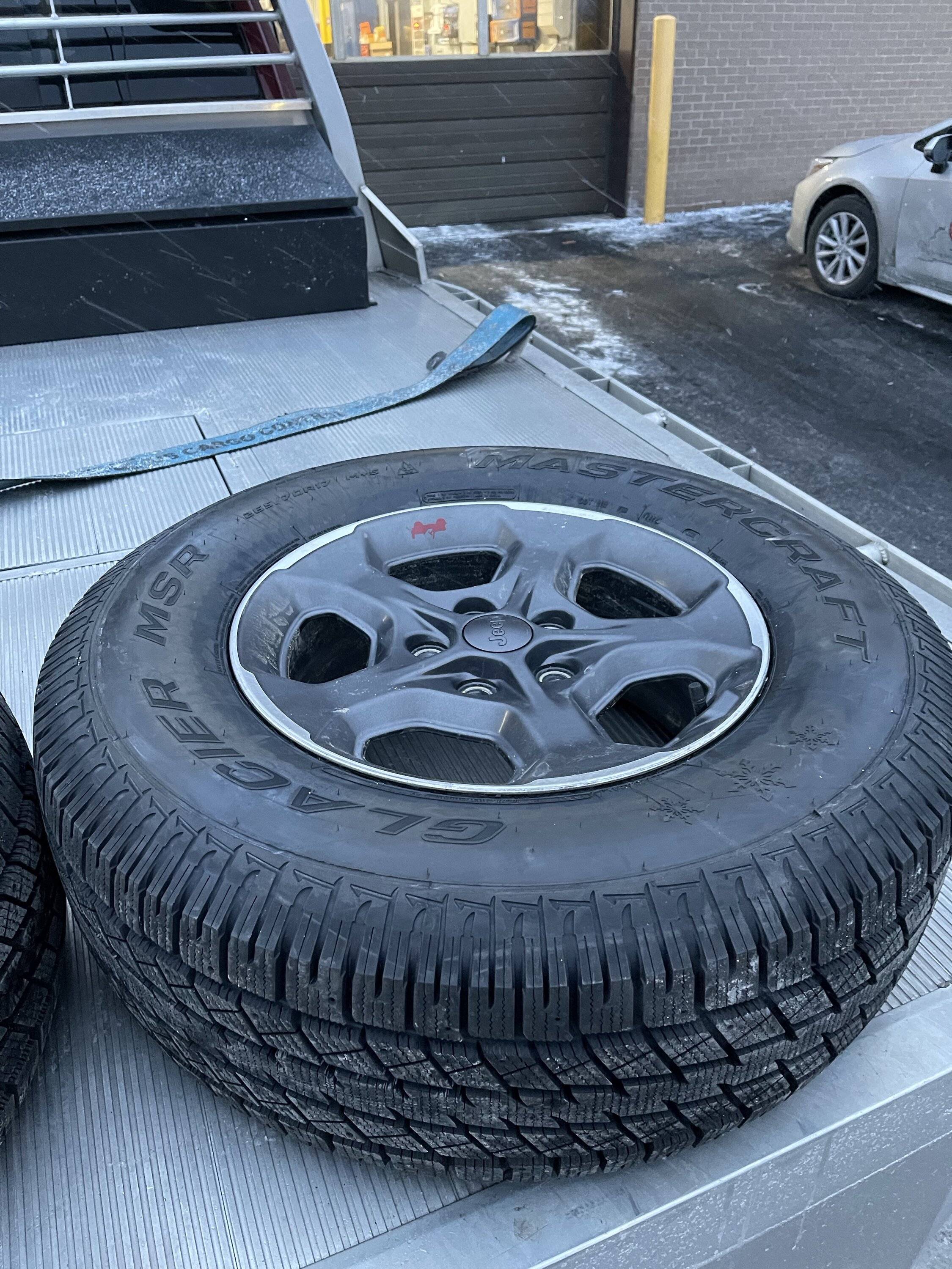

When I recently purchased some used Gladiator wheels to run some snow tires on my 2022 Willys XR, I went the simple route, as well as supported my favorite dealer, and went OEM.
No “syncing” required….just drive for a few minutes and they start communicating.
