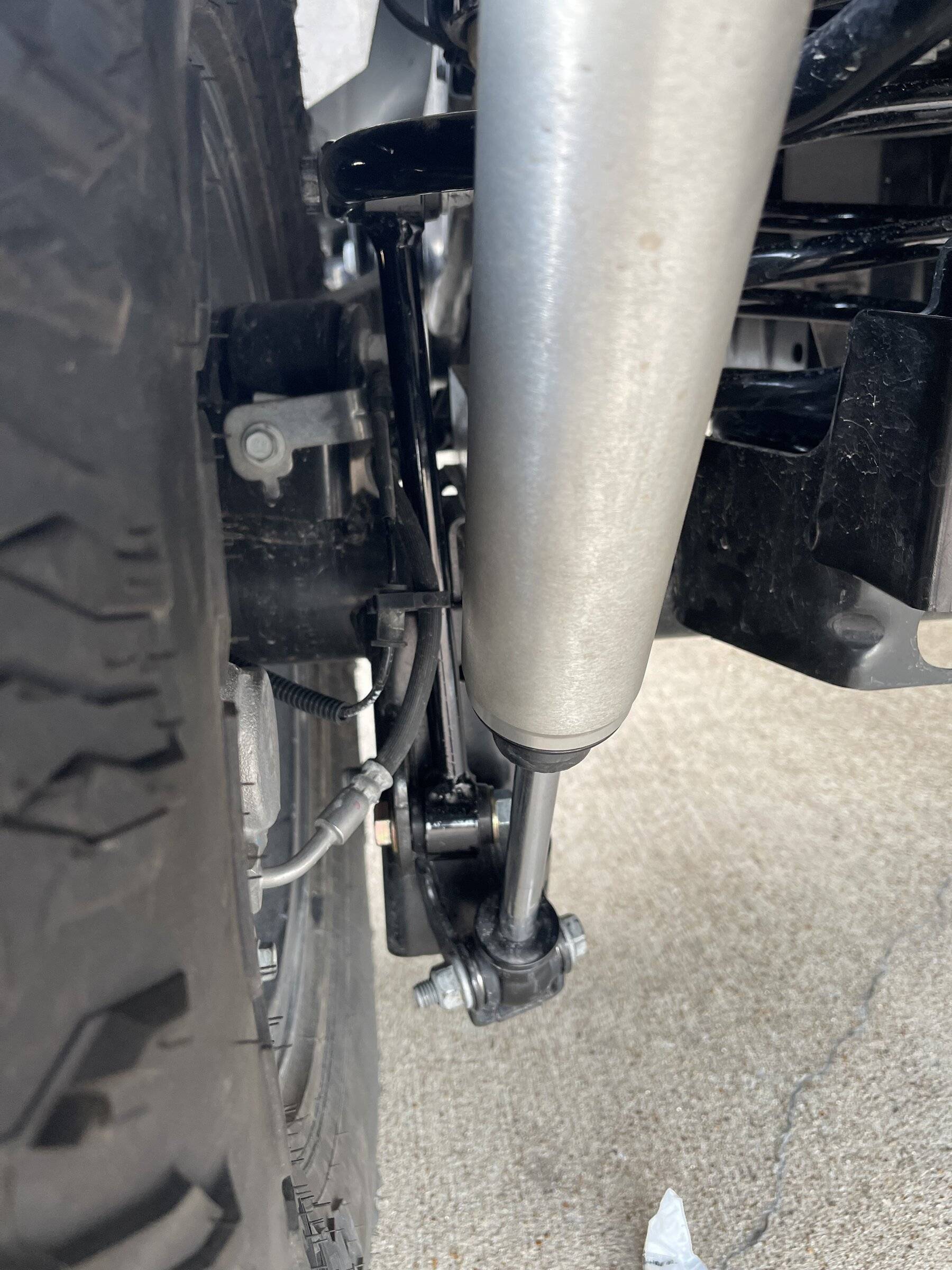

Did you torque the control arms with the weight of the Jeep on the axles/tires? I only ask because you might have the factory control arms preloaded. Cycle the suspension one corner at a time and see if anything is binding.
Pretty sure this is my issue. My buddy helped me out with this, but I’m 9000% sure this is my binding point. I don’t think the rear links go this way.
You are correct….. they go outside/outside .
