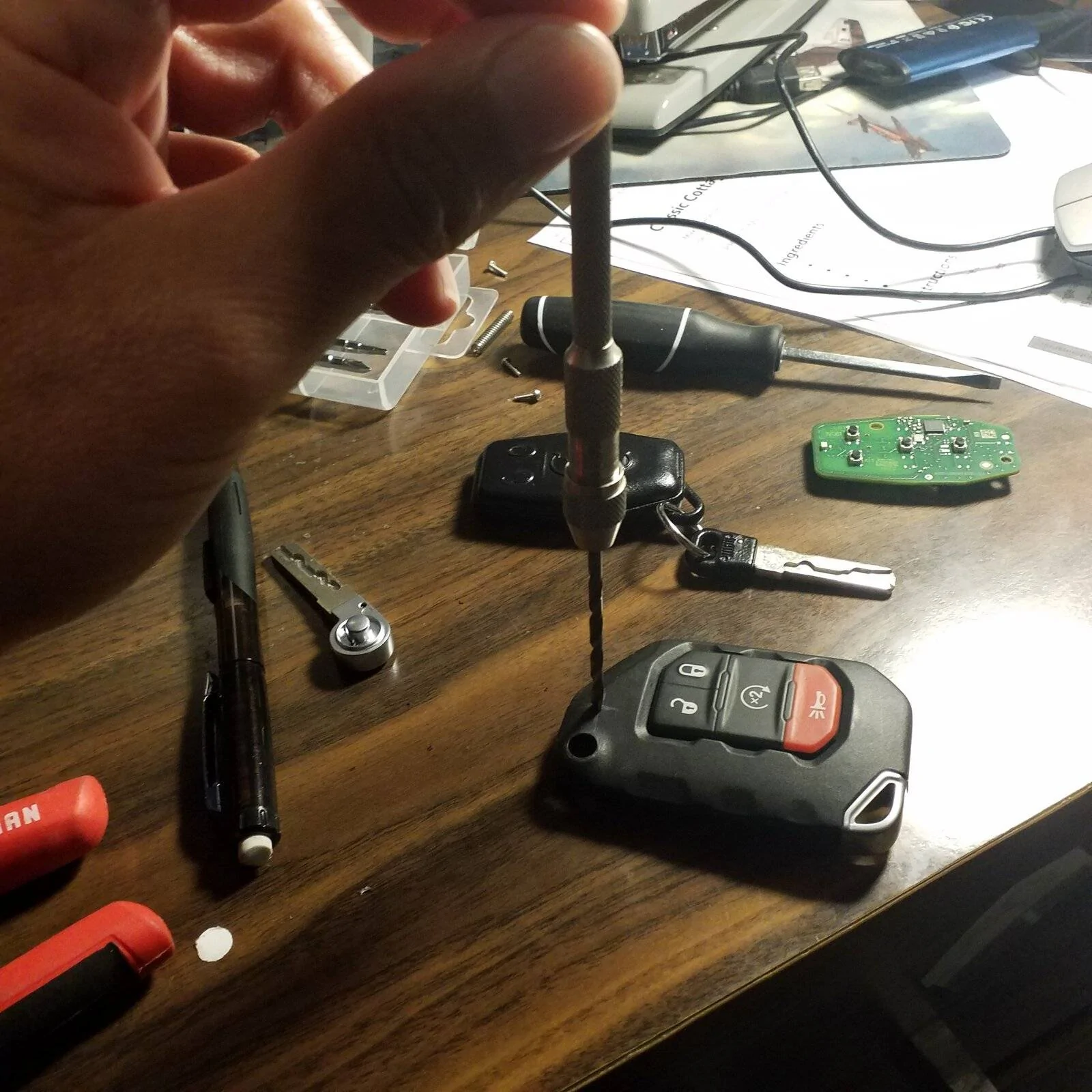

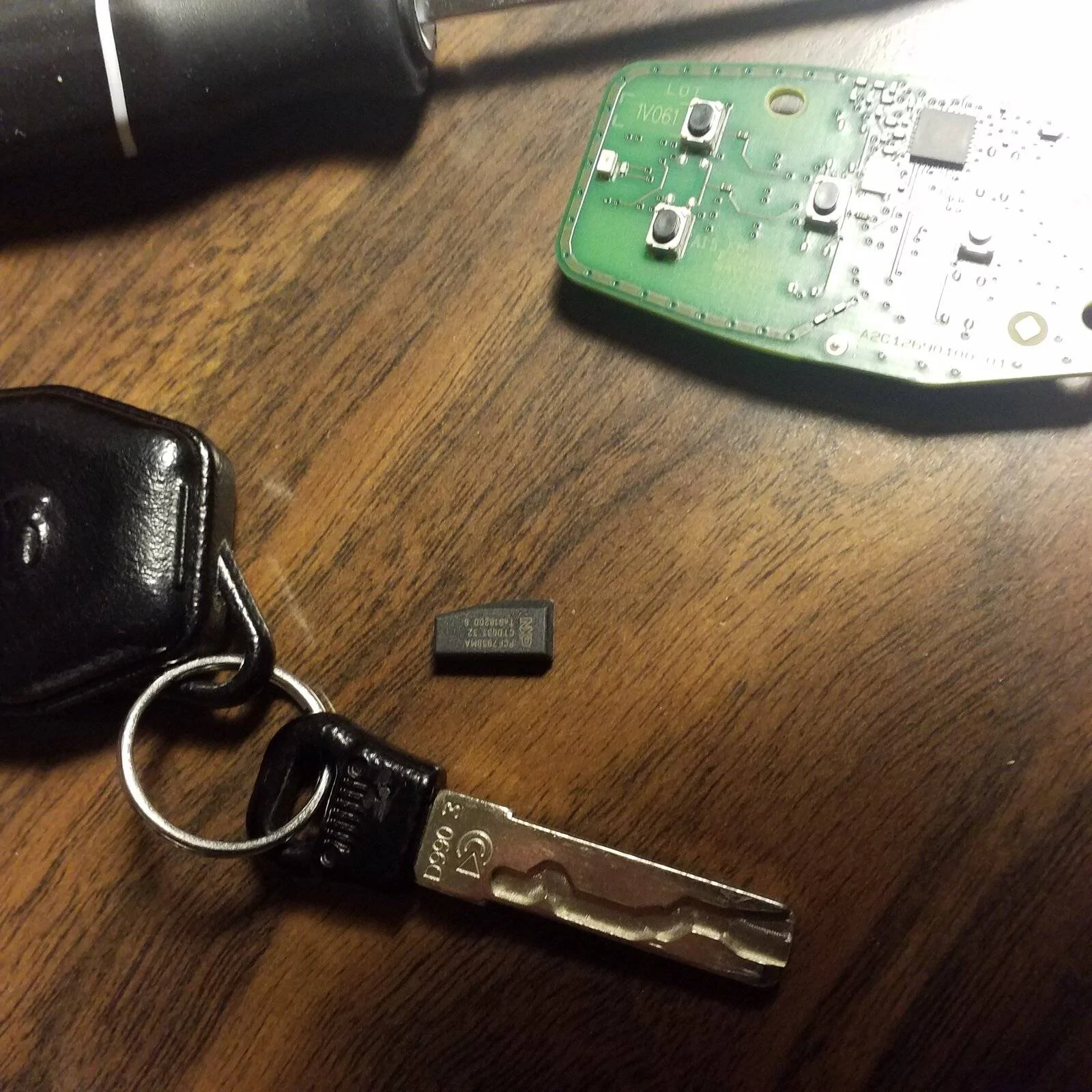

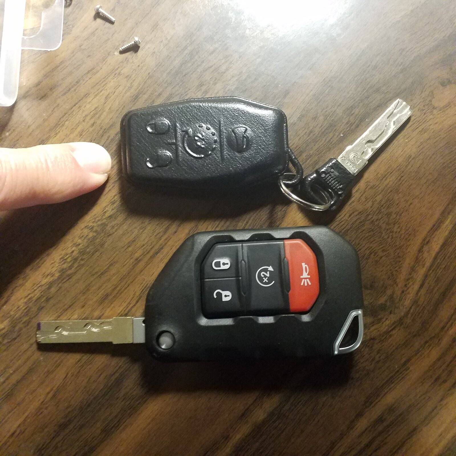

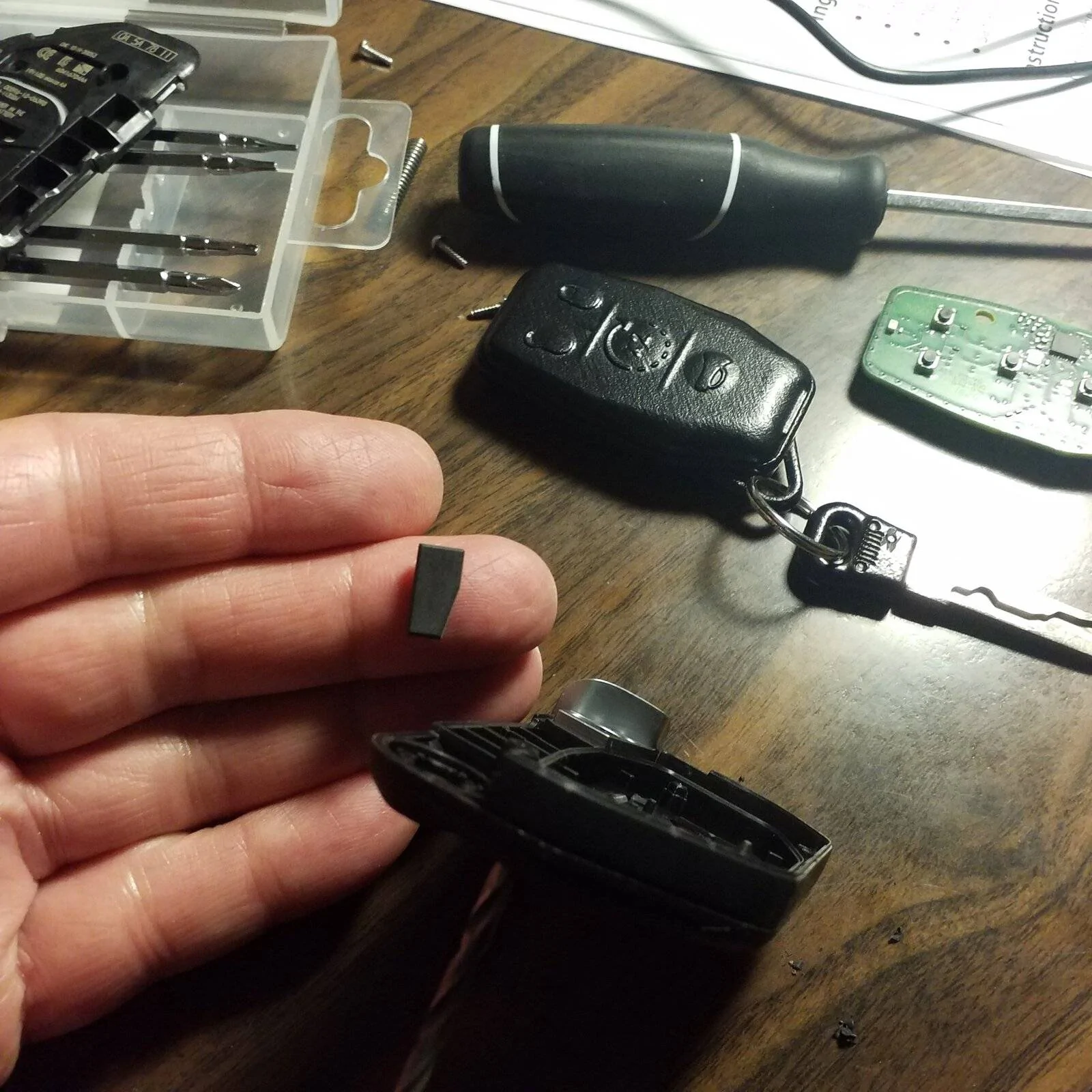

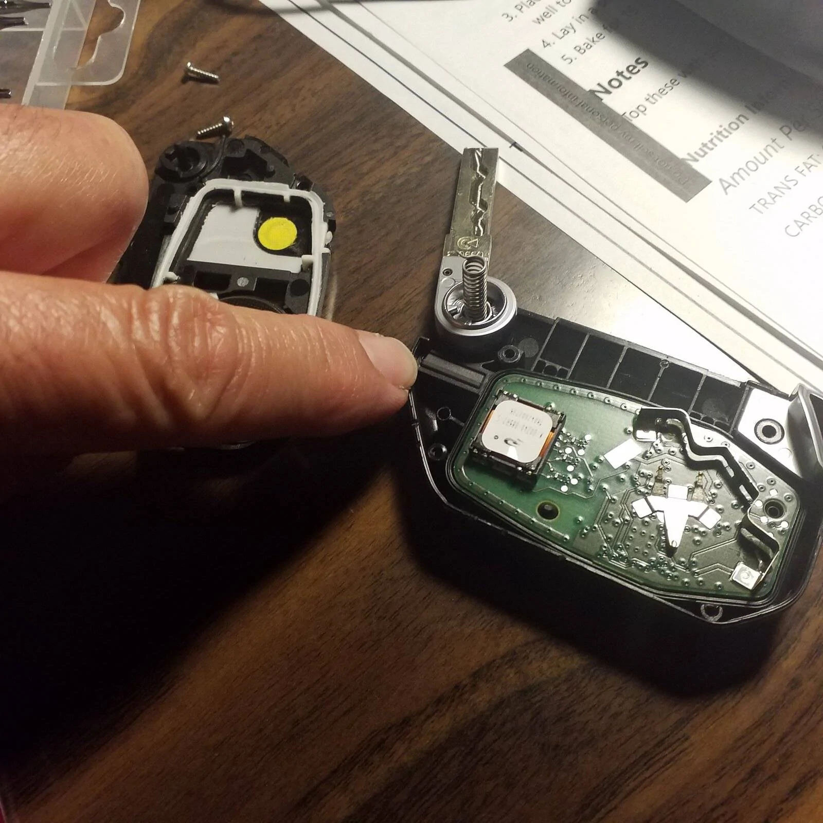

Ok, one more time because "no pix, it didn't happen".
1) Get one of the reduced size FOBs from Threedom.
2) remove the RFID chip from your old FOB housing (see below)
3) figure out how to carry that tiny little chip in a waterproof manner, in your wetsuit. You could even incapsulate the chip in epoxy glue to seal it and attach it to something to go on a key ring.
Jeep Wrangler JL Surfing - what to do with key 20211110_120818
Jeep Wrangler JL Surfing - what to do with key 20211110_120520
I drilled a 3/32 dia hole using a pin vise and it pushed out as the drill broke through. But a 1/32 or 1/16 hole with a variable speed drill motor should work just fine. just don't push hard, its just plastic. I drilled the hole instead of trying to remove it from the other side, because of all the difficulties others have posted about removing the chip. As you can see it easily came out.

4) hold that little chip within a 1/2" of the start button while pushing to start. THAT'S IT!
