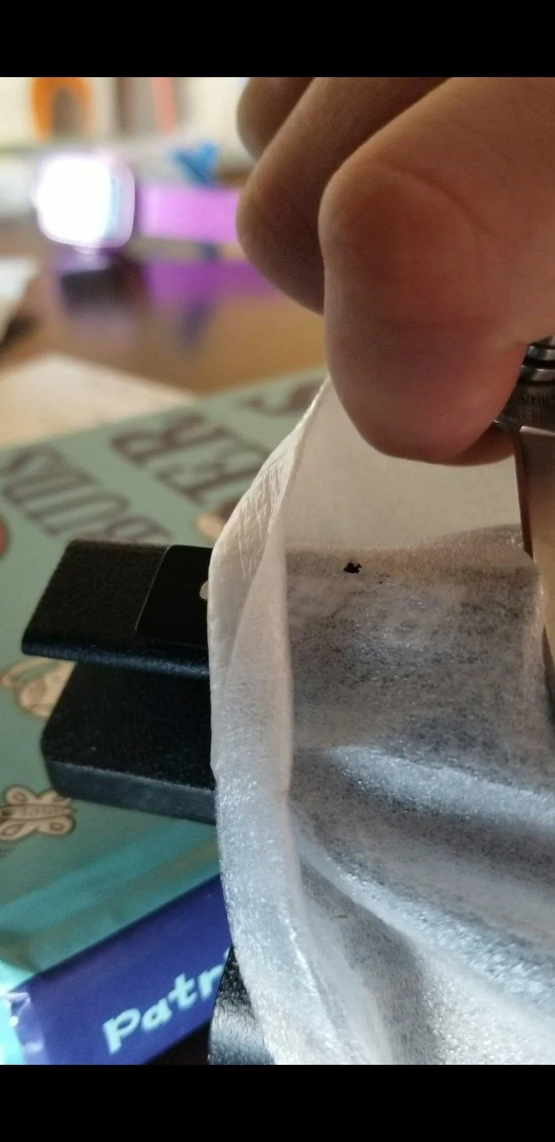

My sunrider leaked the first time I washed the car after installing it. Since, it has only leaked once in heavy rain when it was parked outside. I came out to the car in the morning and saw the dried rain spots on the front door panel panels close to the seat (driver and passenger side). Any ideas? I attempted to add some tape where I thought it might be leaking but that didn't work.

This was the small pieces of foam tape they sent me which seemed to fix the issue.
That's exactly where mine was leaking! I really didn't want to take the top back off again, but I'm definitely going to need to. Thank you for posting! Much appreciated.
