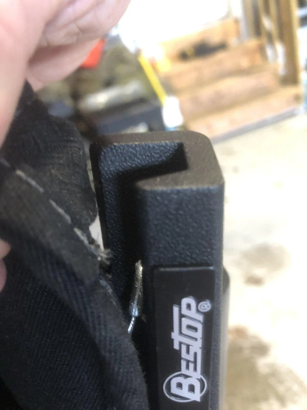

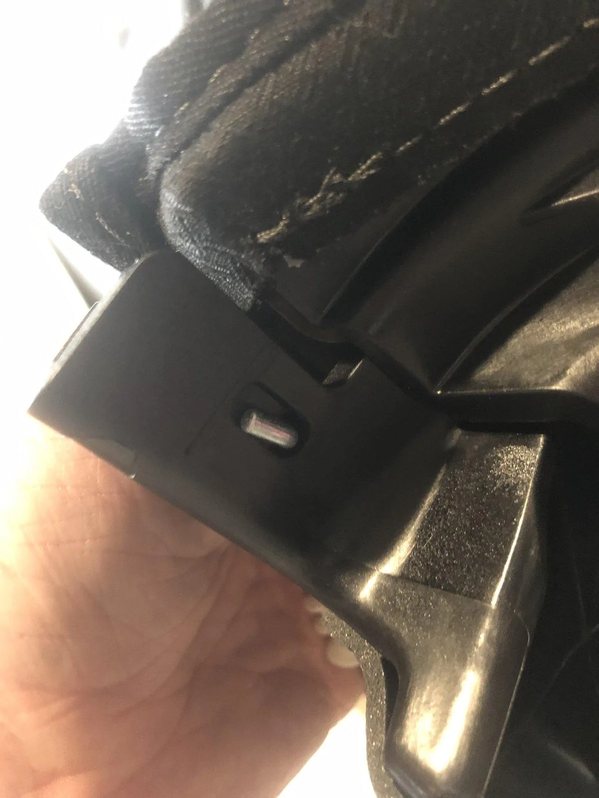

I am assuming this is what the cable ends should look like pre-fit into the door rails.
Jeep Wrangler JL Sunrider for JL 94B01D3D-DD52-4C27-B61B-68E39182F41D
Jeep Wrangler JL Sunrider for JL 193E39A9-BCBF-440A-9F8F-AAF237841D63

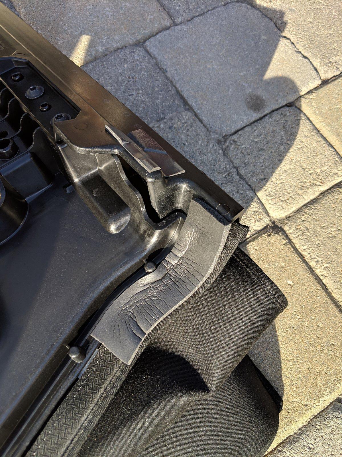

UPDATE: Installed the foam tape pieces provided by @BestopTeam and ran the leak test again, so far so good. I'll keep an eye on it but I think the leak is gone. Here is the images of where the foam tape was added.
Jeep Wrangler JL Sunrider for JL IMG_20181230_152423
Jeep Wrangler JL Sunrider for JL IMG_20181230_152433
Was it leaking from both sides of the top (driver and passenger)? They provided two strips which you applied to the canvas end? The other two strips on the side rails come on the Sunrider from the factory, right? Mine has the two on the side rails.
No, just leaking on the passenger side. However they gave me a piece for both sides so I added it. Its the area on the material and covering the cable hole.
