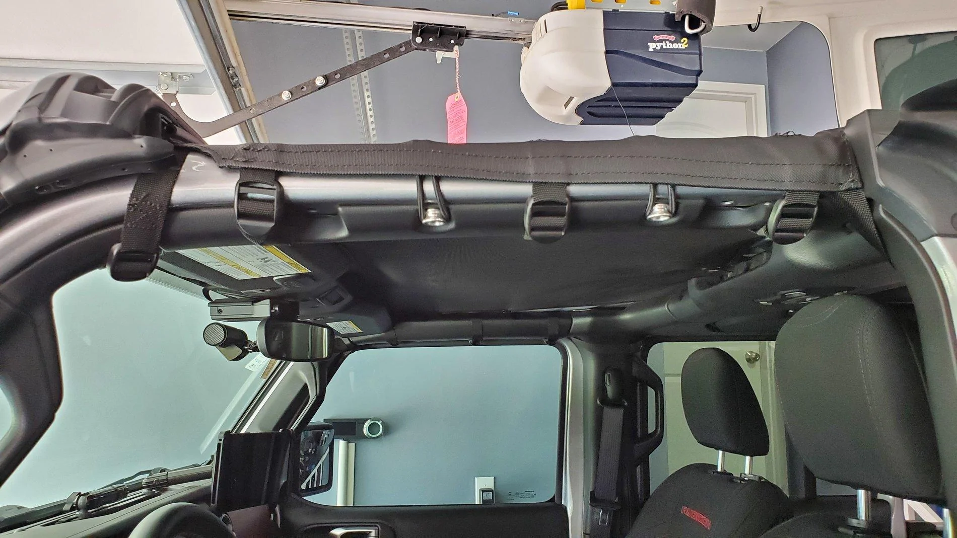

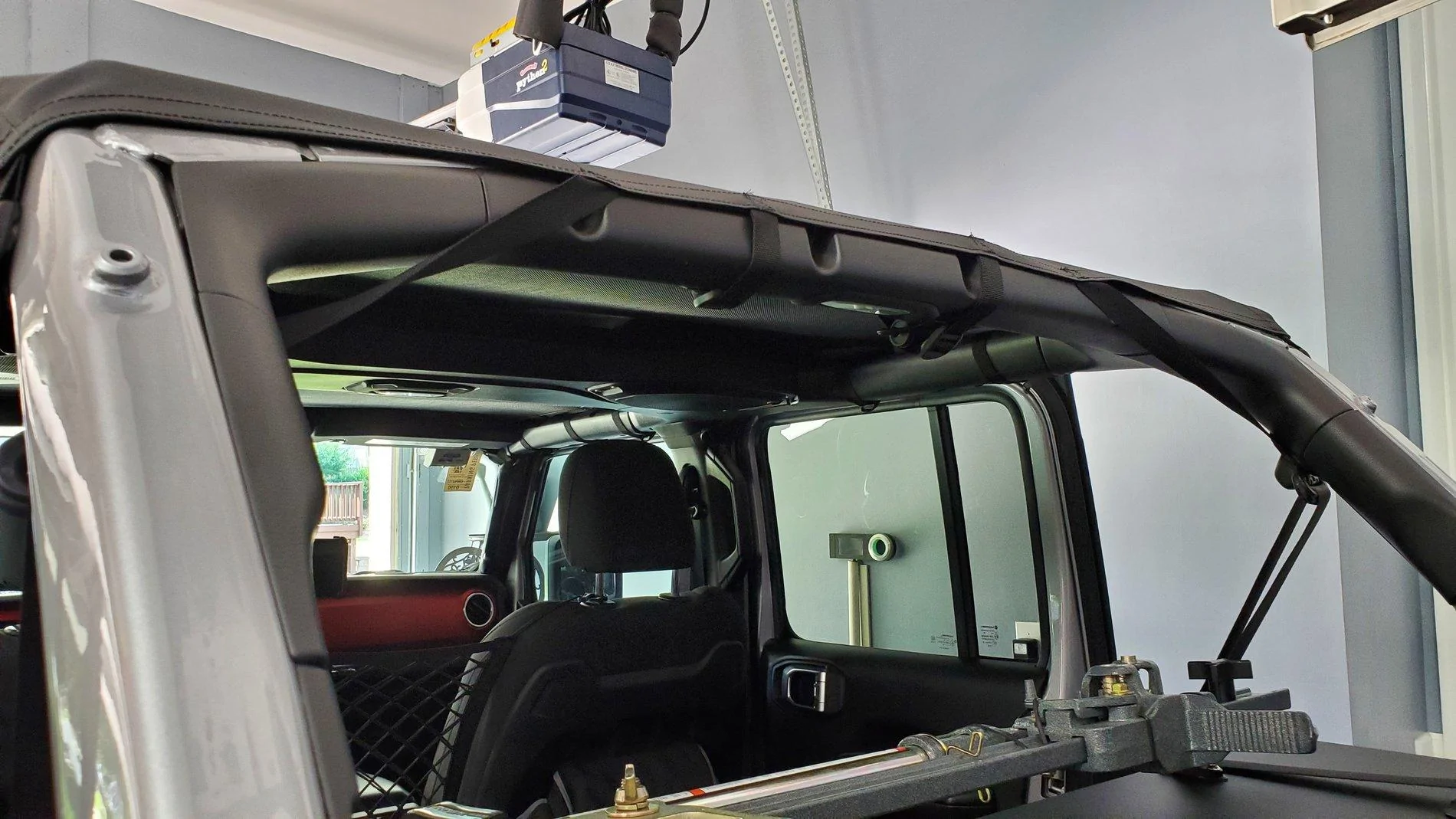

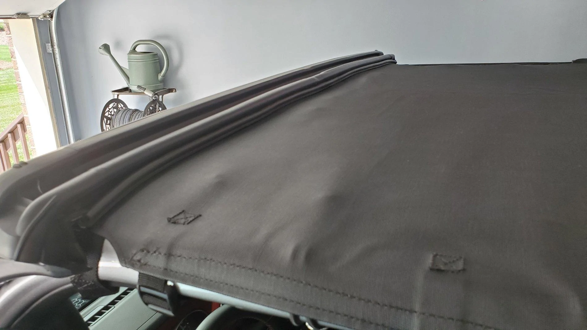

Couldn't be happier with the MasterTop Bimini Top Plus (Part #14300635)!
I'm running the SpiderWebShade mesh top, and this fits right over it, with no issues. The fact that an additional header isn't needed, and that the front section tucks nicely/snugly in to keep rain off of the dash make this worth every penny.
For me, the mesh top is the daily, and the MasterTop Bimini Top Plus will be my emergency option for the next time I get stuck out in a storm.
With the SpiderWebShade installed, only one of the soundbar's 3 fasteners from the MasterTop can be used, though I may develop an option for that, if it's even needed.
Install was a breeze, and build quality, so far, has been solid.
PS: It does flap a bit, though I plan to let it stretch a bit, then re-tighten.
PPS: I also plan to mock up some foam inserts for the top door gaps. Will post pics if it works (Pics added)
Here's some pics:

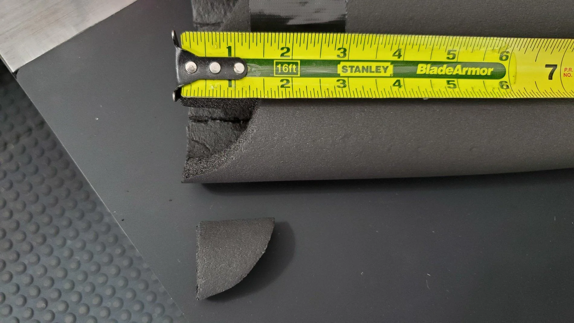

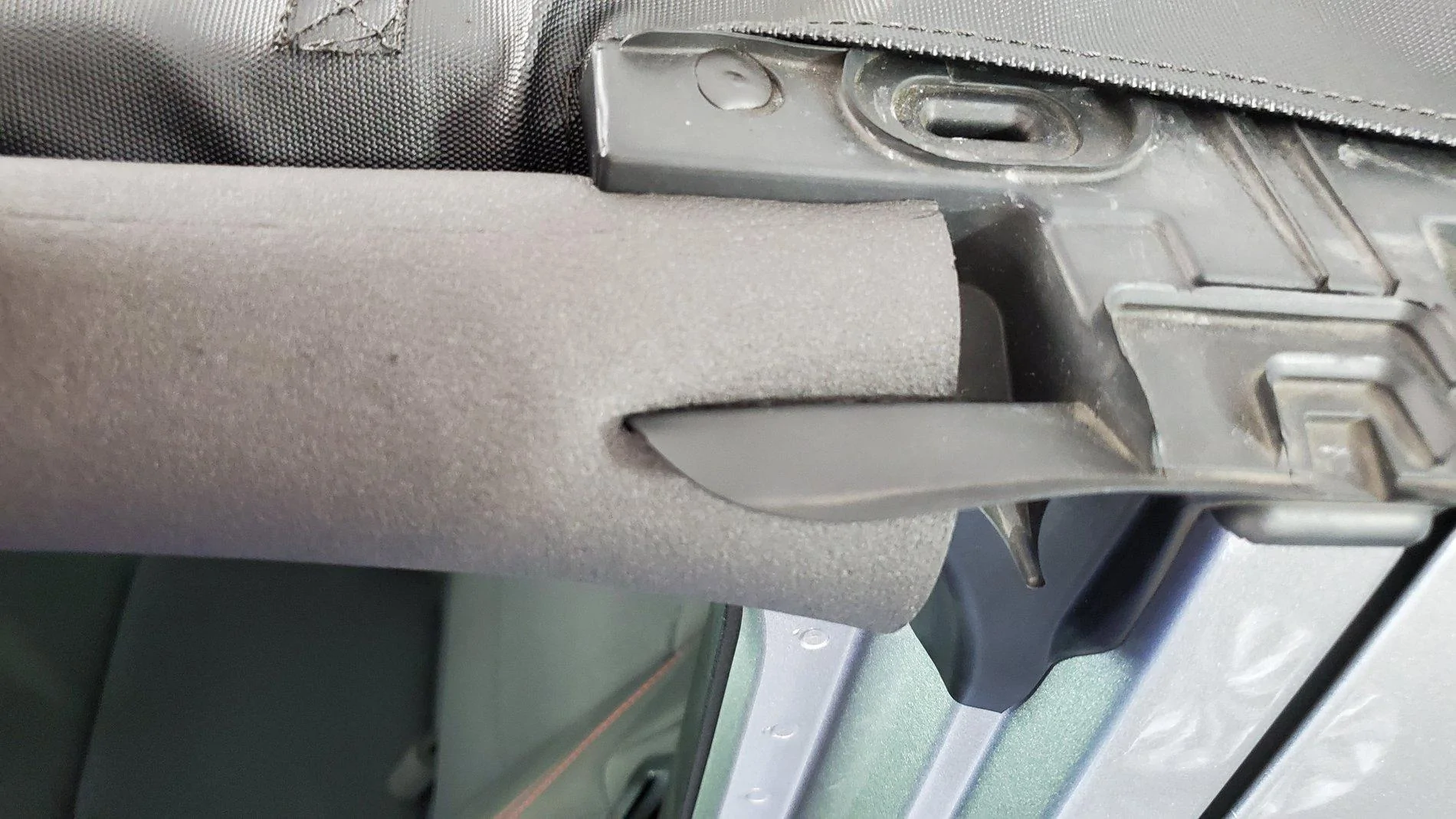

If you're using this top primarily for rain protection, the gaps between the doors will still allow rain in. But... the foam inserts cut below may be a solution. I'm planning to share this with MasterTop.
Cut some foam pipe wrap for 1" Pipe into two 23" sections.
For the driver's side, front window: (Reverse the cuts for the passenger side)
  • With the split section of the pipe wrap at the bottom while on a table, cut a 1.5" slit on the front side of the foam
  • Next, cut a rounded wedge leading up to the back side of the slit just cut

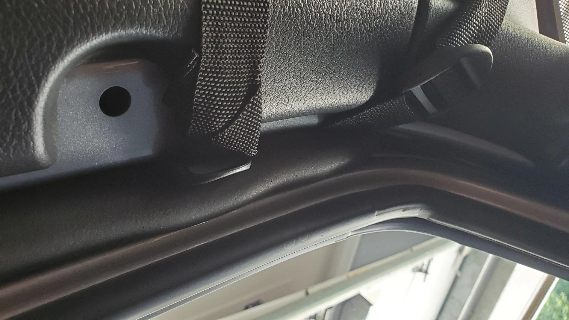

  • On the rear of the foam, cut two, 2' slits. The first cut will be in-line with the front slit previously cut. This allows the foam to wrap around the rear rubber section at the top of the B-Pillar. The second 2" cut will be about an inch below the first (see Pic.). While not pictured, I did cut the back half of this 2" section off, allowing the two pieces shown to recess into the B-Pillar's rubber top. (Note that this allows water to enter the drain)
And that's basically it for this first run. Each section wedges into the door jams quite nicely, though I'm thinking of adding some small Velcro strips that wrap around the roll bar just to be safe.

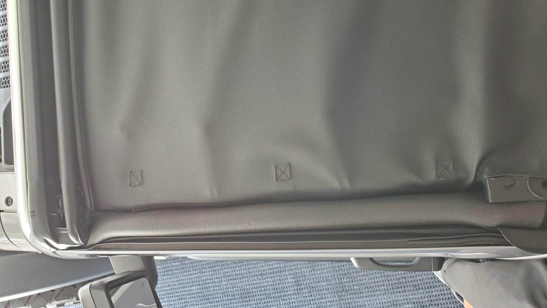

Top View:

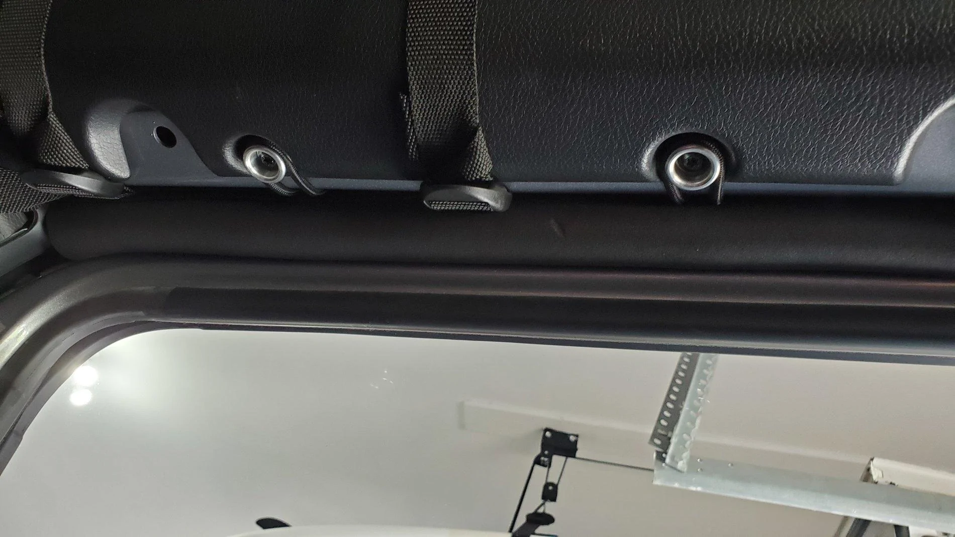

View from inside:
There are no gaps, and no wind noise/whistles.
From here, I'll likely find some solid, water resistant foam and cut it as shown. Once again, this isn't intended for everyday use, as the goal was to create some additional protection for those times we're caught out in a big rain storm.
