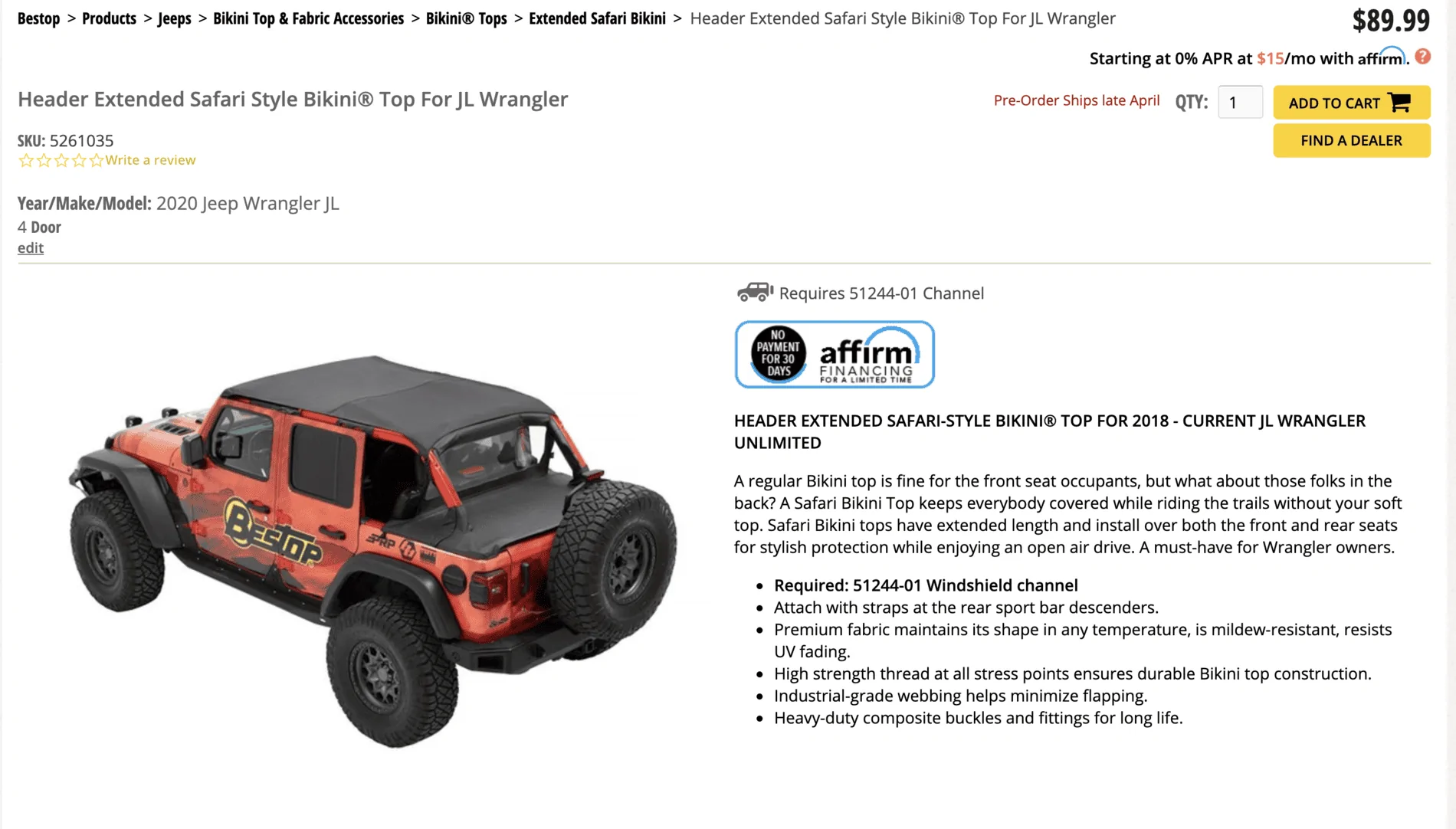

Since there are no photos of the 2dr version... Does the duster go behind the rear seats, or is it another one where the assumption is that people who own a 2dr never use the back seat?
It will occupy the area of the rear seat, not just behind the rear seat.

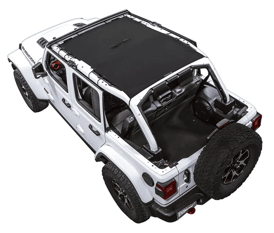

Whew...just finished installing the SpiderWebShade JL4D (JL 4Door) on my Rubicon. Let me say right up front...You do NOT have to remove the wipers and fold the windshield down. You also do not have to remove the hard top. Otherwise this is a two person install. You will need to remove the Freedom Panels though.
To start off with, the instructions say you have to remove the wipers so you can lay down the windshield. If you have not removed your wipers before, let me tell you they are impossible to remove without a some type of tool. Once you get them off, they will come off the next time much easier. But the first time they are impossible. You have to remove them to lay down the windshield according to the installation notes.
I determined I could fold the wipers forward off the glass. Then remove the 4 bolts and fold the windshield just far enough forward to get the front screen clips under the the top front frame. Again, you do NOT have to remove the wipers or fold the windshield all the way down.
Next you are supposed to remove the hard top. Since I was working alone, I simply removed all the bolts and held up the front of the top to get the screen top under the hard top. After getting all the retainers installed and the shade attached properly you can bolt everything back down and re-install the Freedom Tops.
I'll get pics of my install when I can. But below is the stock photo on essentially the same vehicle, a white Rubicon Unlimited. All in all I'm pretty happy with the end result. We'll be taking the top off Friday and heading to coast for the day on the beach. Looking forward to having shade this time.
