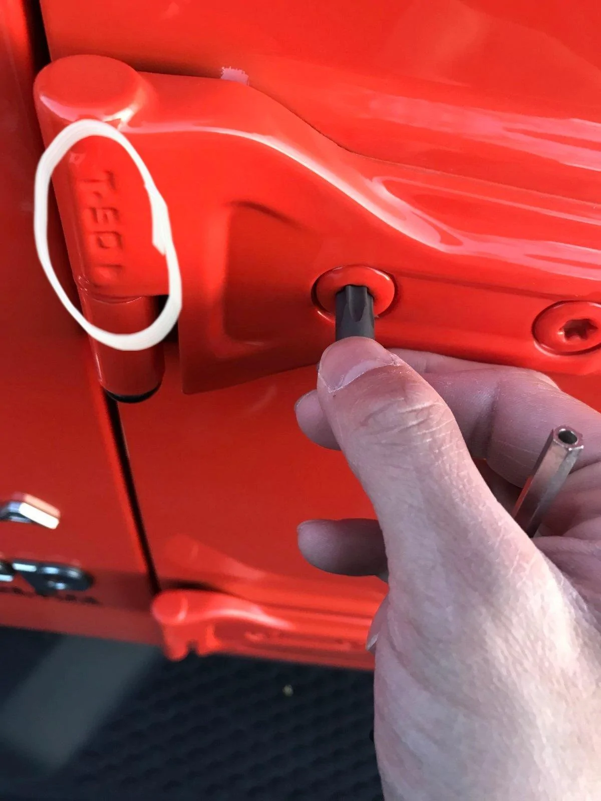

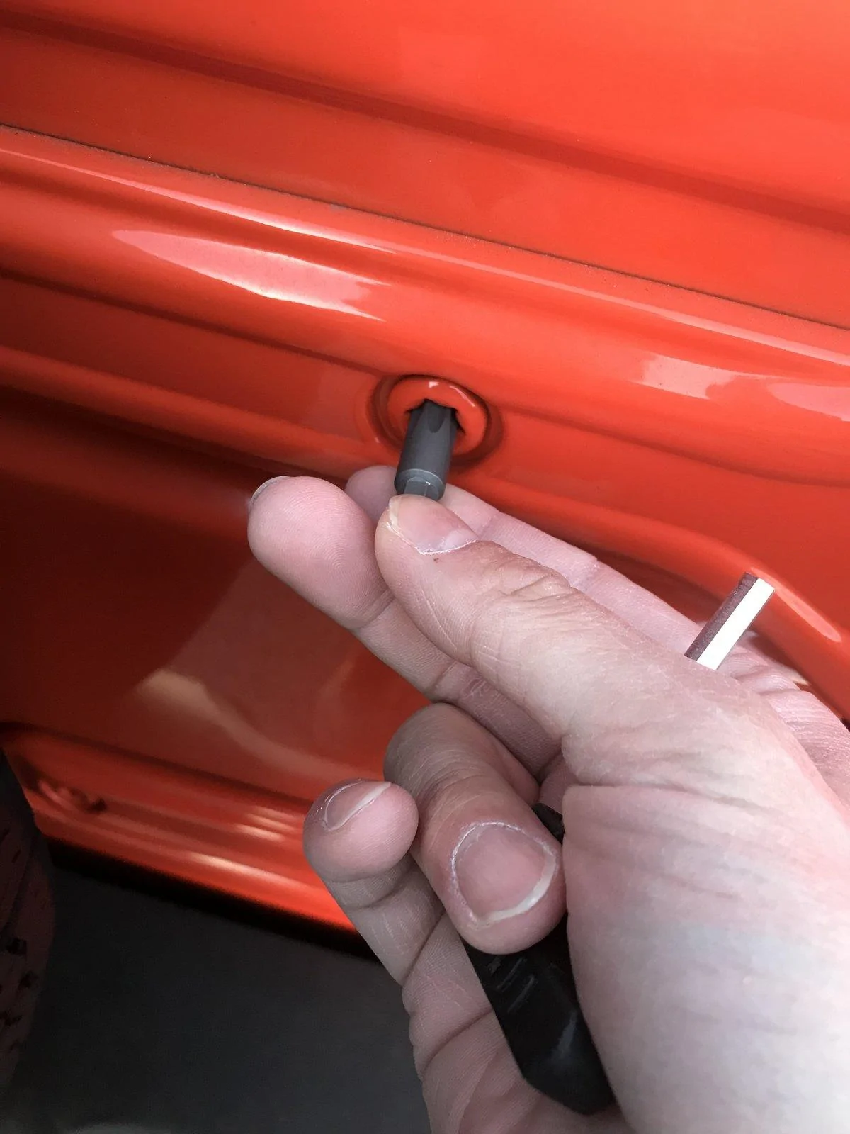

I just checked for you, first photo is tailgate hinge, too big for T50, second picture is door hinge, too small for T50 without breaking the paint, they are definitely difference sizes. T55 would fit in the tailgate hinge, but I don’t see how in the world it would fit in the door hinge. Even T50 is too big for it without hammering it in hard.

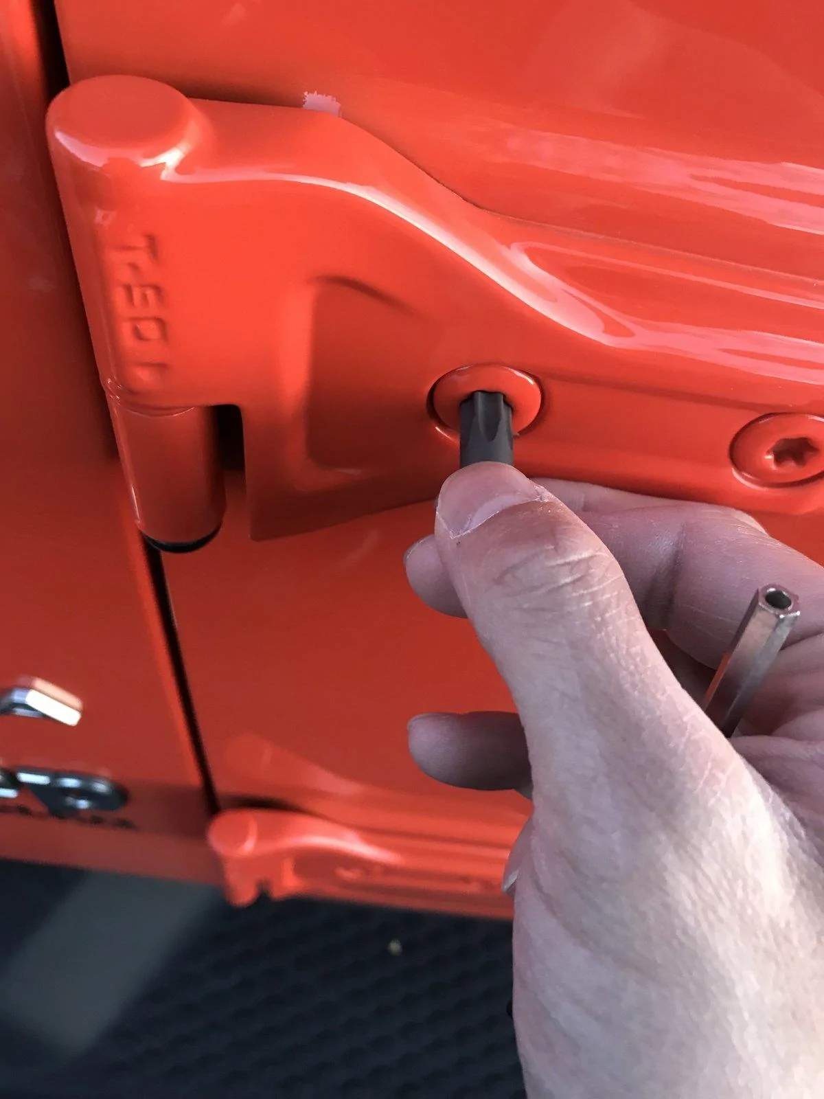

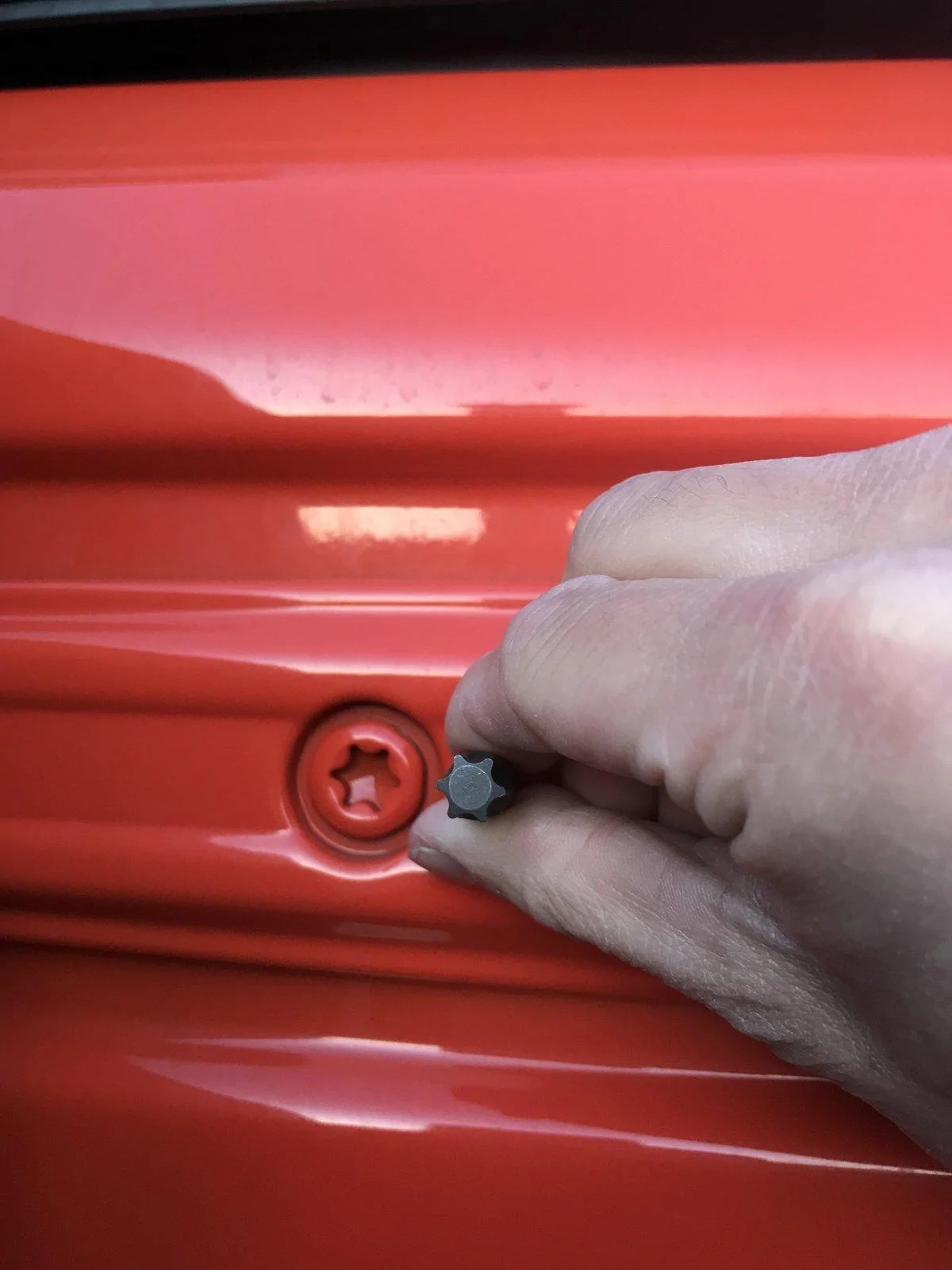

Here is another comparison between the two different hinge bolts. Difference is night and day. I am holding a T50 bit, see for yourself. @digitalbliss certain individuals on this forum, I won’t name names, will jump on the opportunity to dish out their superiority complex and condescend on fellow member for whatever thrill they seek.

All this back and forth made me curious. I went outo and checked my rig (no Bama skeeters in the garage). The door and tailgate bolts are definitely different. They look to be 50 in the door and 55 in the tailgate.

To borrow from Jeff Foxworthy, "HERE'S YOUR SIGN" ....it has a marking "T-50" on the door hinge. The tailgate screws are clearly much larger.
Get a few spare cheap bits. Put one in a cheap socket and extension and heat it with a torch until the bit is hot as hell, then work it into the screw thru the paint. The paint should melt. Once you get it to fit, you can heat the bit again and leave it in the head to transfer heat to break the paint loose from the hinge/bolt. Use a new bit (cold) in an impact wrench.

The stamped T-50 with the Arrow pointing down is to show the size of the door hinge bolt, the one that is removed for door removal. They are coincidentally the same size, but the stamp has nothing to do with the other 2 bolts.
