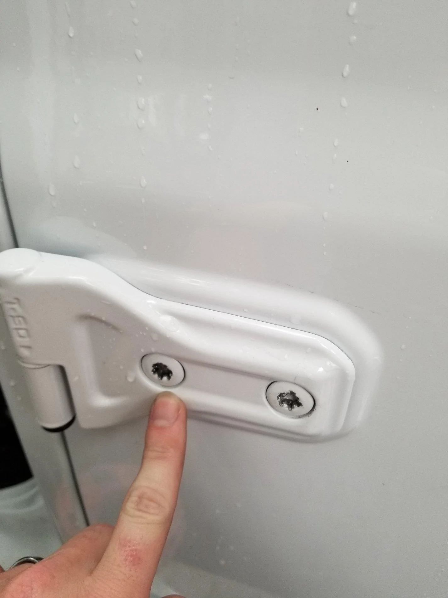

So, I got two Kargo Master Door Steps in that I am fitting to the rear doors on my JLU Sport.
Working on the first upper hinge bolt, it took some effort but eventually came loose.
Moving on to the second bolt on the upper hinge (drivers side btw) I have not been able to get it to budge.

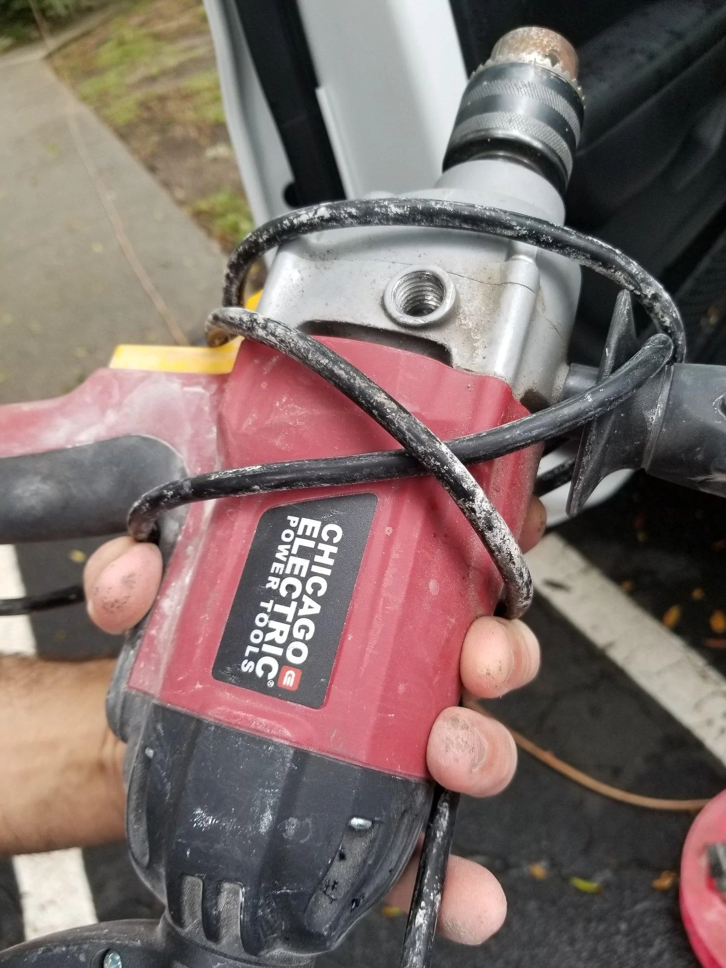

4. Big torque drill (image below), this ended up applying enough torque to unscrew the primary (replaceable) head of the drill hahaha!
At this point I'm sort of at a loss as I have never encountered a bolt this stubborn... any ideas on what to do next?
I haven't tried applying any heat to the bolts yet, but wondering if I should just take them to a shop to see if their air tools have more power...
Thanks in advance.
Dude, toss the power tools that's insane.
Because bolts are painted lightly tap torx bit into bolt first to get snug fit. Gently but firmly lossen bolts by hand preferably with wrench that has a longer than shorter handle for leverage.

Wow, it is a T-55 bit, another thread with a pic of a T-55 in the hinge bolt. There is a lot of paint on those bolt heads!

THE BOLTS ARE T55!!
however, I use flex bit B50 from Harbor Freight. A true bargain at only 68 cents each.
Because the bolts are painted i would def use the B50 torx bit.
The "B" series bits will swell up slightly with a few drops of water once in place on the bolt.
They are specifically engineered for freeing up painted bolts.
You could also go up to a K60 and with a heat gun add some heat and the bit will shrink into place.
Harbor Freight is by far the best quality and price for Jeep supplies. Highly recommend!!
