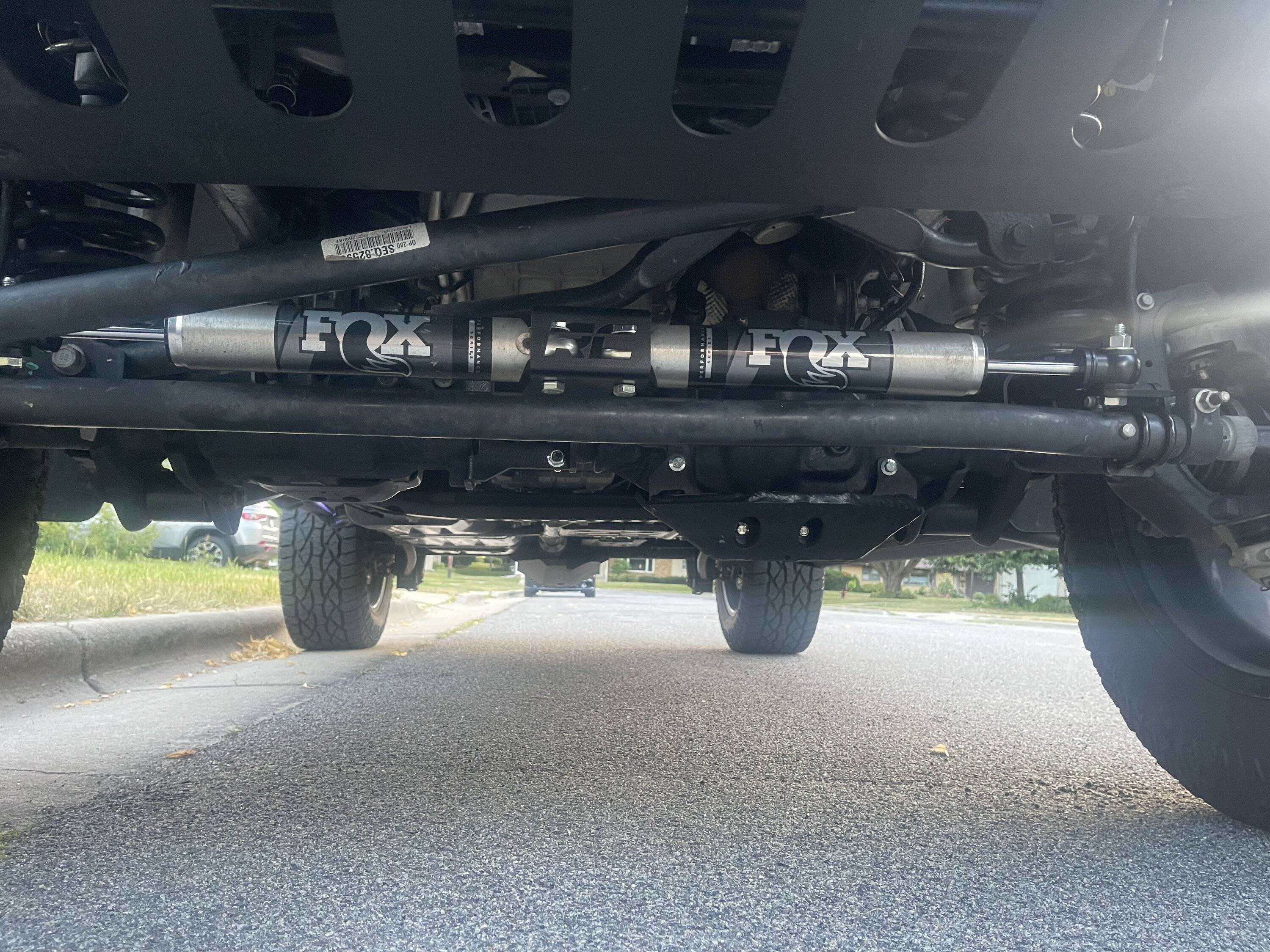

I run 35/12.50r20. I needed a adjustable track bar after my “2” in mopar lift after seeing my front diff was offset. It included control arms. I wound up replacing the single factory stabilizer with a fox one. Steering was ok but then I decided to go to dual steering stabilizers and wound up with the rough country brackets and a second fox stabilizer steering feels tighter I will also install heavier duty ball joints at some point
