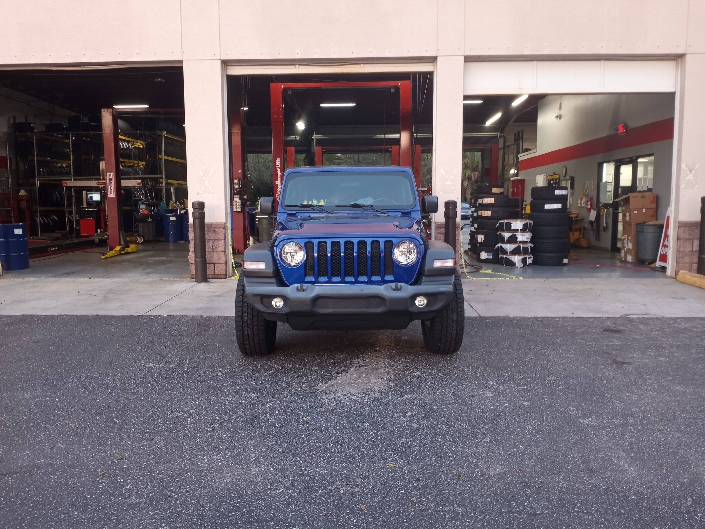

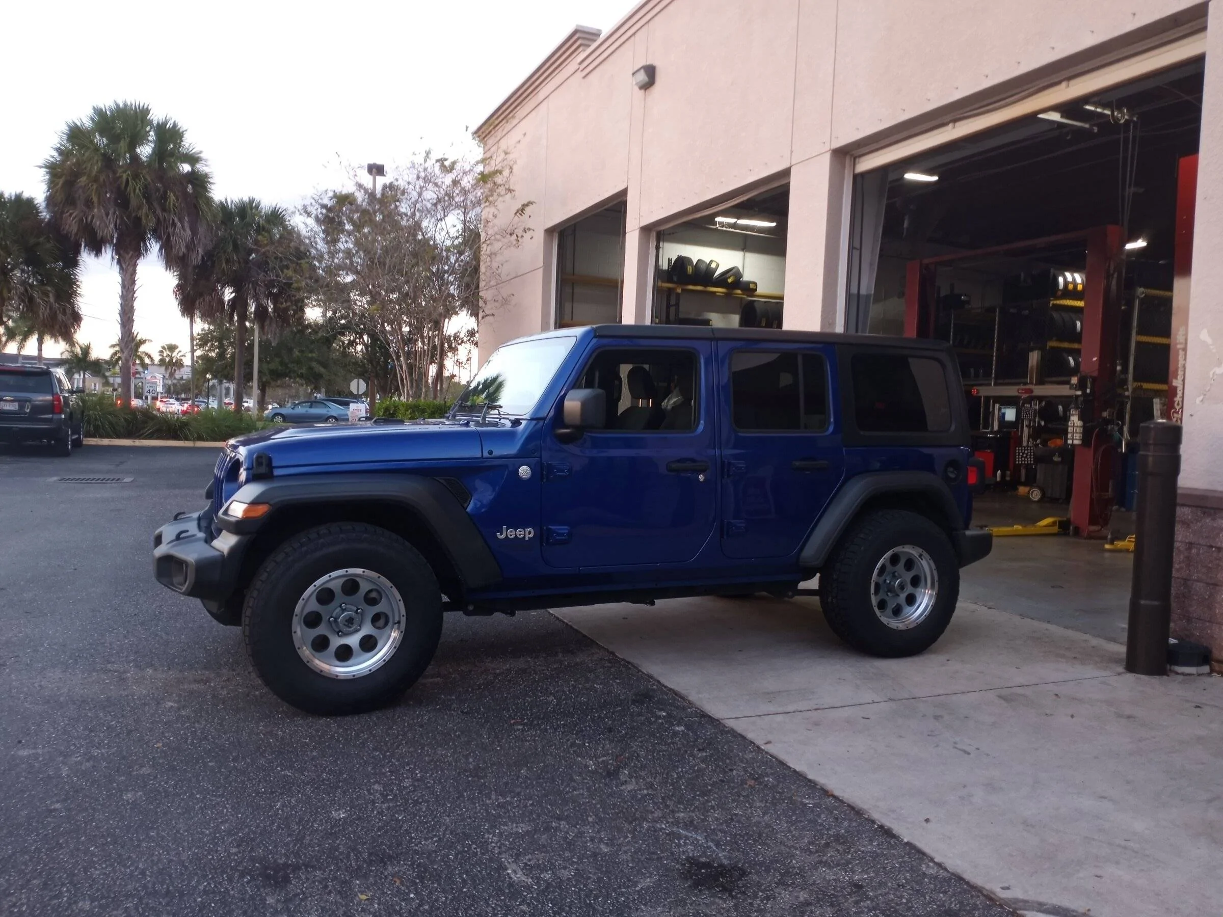

So far, these P-Metric Cooper Discoverer AT3 4S tires feel great. Look pretty good too.
Jeep Wrangler JL Street Tire Choices IMG_20211213_173018
Jeep Wrangler JL Street Tire Choices IMG_20211213_173008
Jeep Wrangler JL Street Tire Choices IMG_20211213_172846
