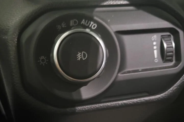

in the middle there are front and rear fog lights. there can be only front fog light.
circle is off. everybody have to have off /circle/.

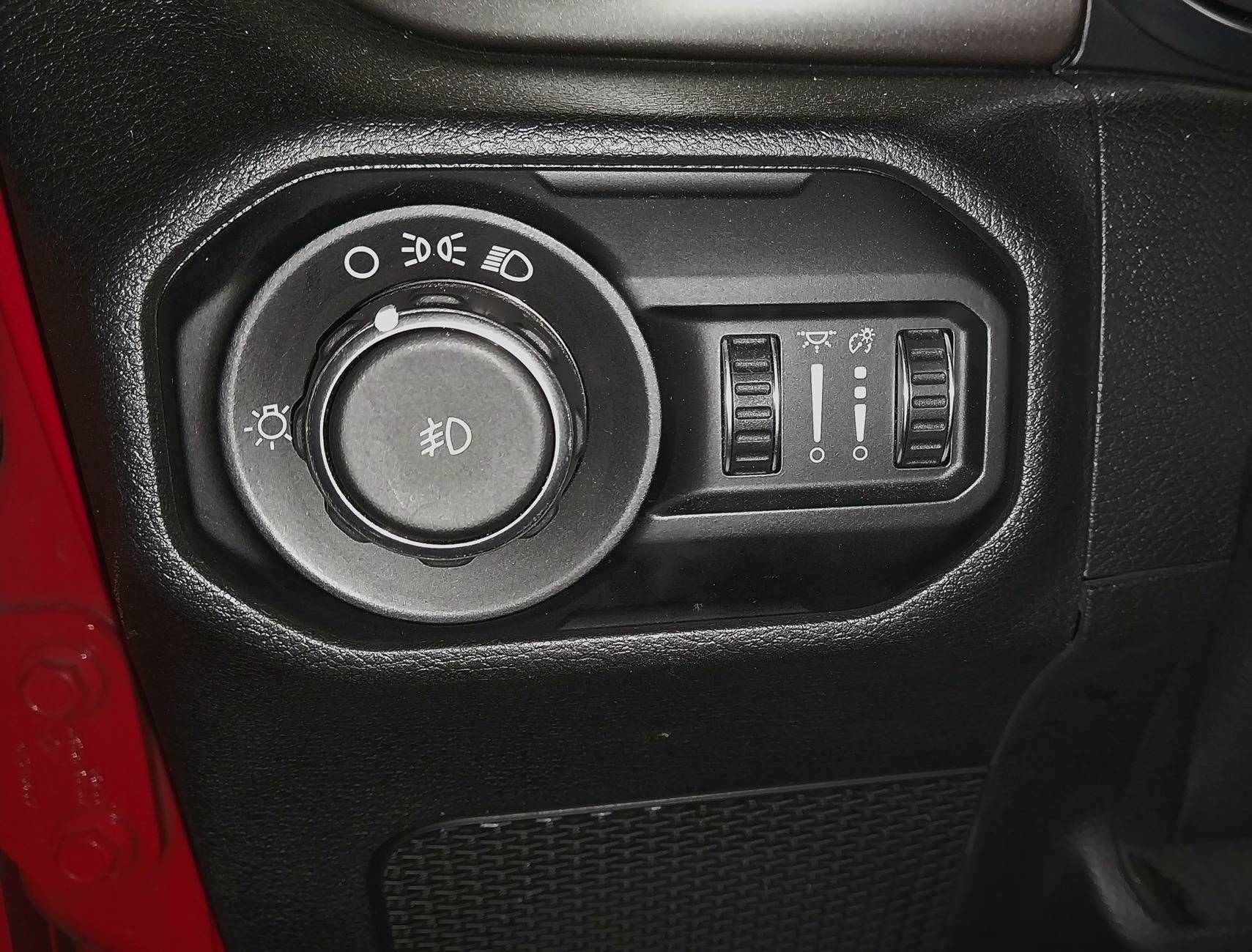

Does anyone RTFM? 🙃
The switch in my JLU. Full manual control because I can breathe and blink at the same time.

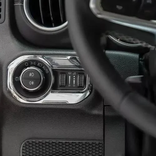

By the way, the center of the dial is the button to turn the fogs on and off, in case that wasn't clear from earlier posts.

It appears you have your high beams on. Try pulling the turn signal lever towards you. By default, you can't have your fogs on with high beams (modifiable with a Tazer/JScan though).
Thanks, this was the solution. I don't think the lever was in the highbeam position but fidgeting with the lever made the auto headlight setting start working normally. I also turned off the foglights.
